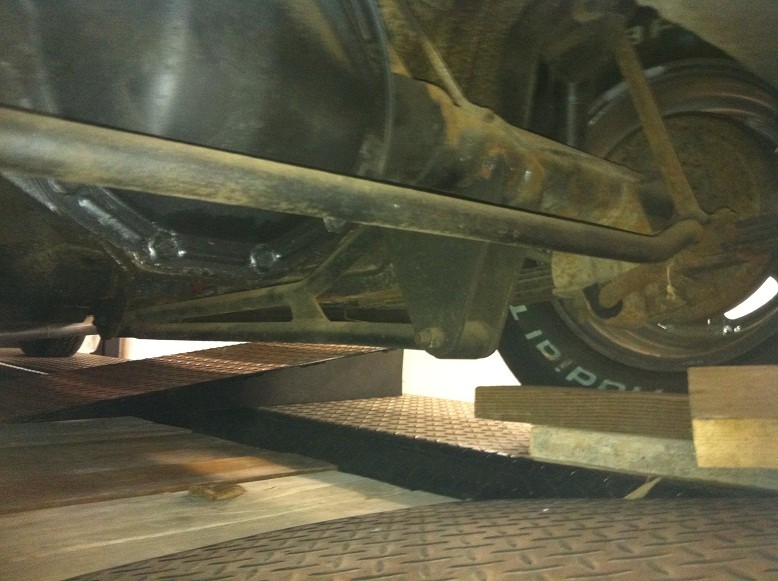

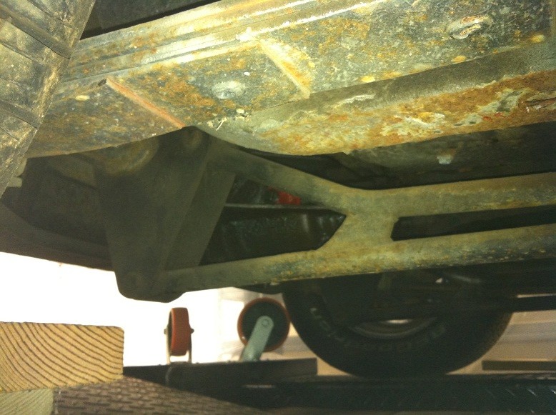

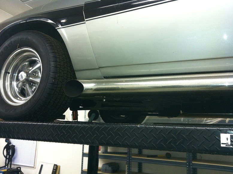

these pics arent the best, but hopefully You get the idea...cellphone pics...my 70 Camaro...
been there for many years..any idea what make??
ever since my first SS396 69 chevelle, I've loved ladder bars..way cooler than traction bars ....jmo

<div class="ubbcode-block"><div class="ubbcode-header">Originally Posted By: iluv69s</div><div class="ubbcode-body">these pics arent the best, but hopefully You get the idea...cellphone pics...my 70 Camaro...
ever since my first SS396 69 chevelle, I've loved ladder bars..way cooler than traction bars ....jmo </div></div> Here you go again teasing us with some pics of a car that looks to be Motion , but not filling us in.
