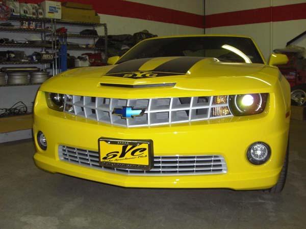

Getting closer to the finished product.
Z0-6 427 engine.
Silver grille.

The Nickey crew did a great job building the car of my dreams, not only peformance wise, but the little things. As far as I know, my car was the first 2010 with a silver grille (Blue bowtie), and the engine Chevy orange. Both were well received, and I think at least the Silver grille will be showing up on a lot of cars before long.
