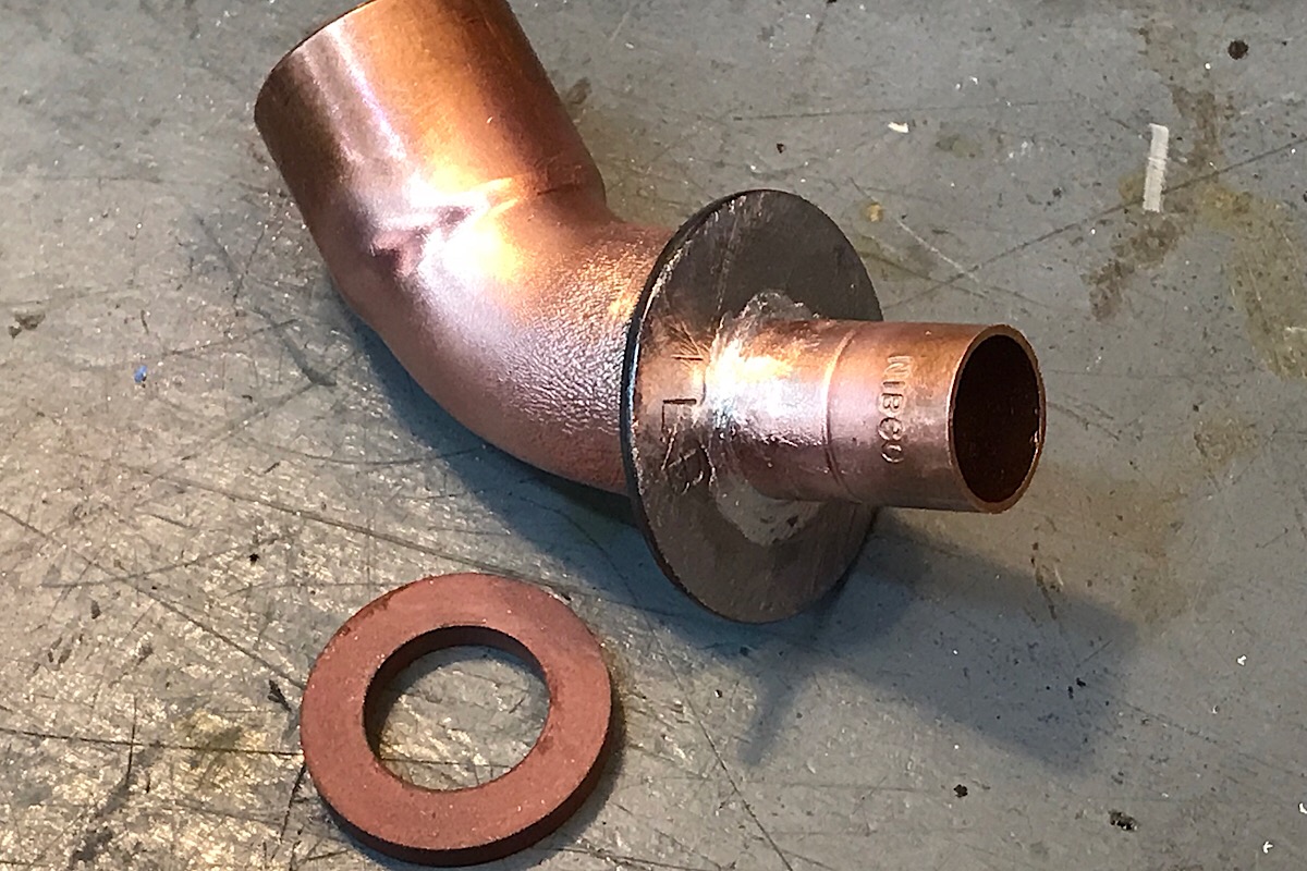

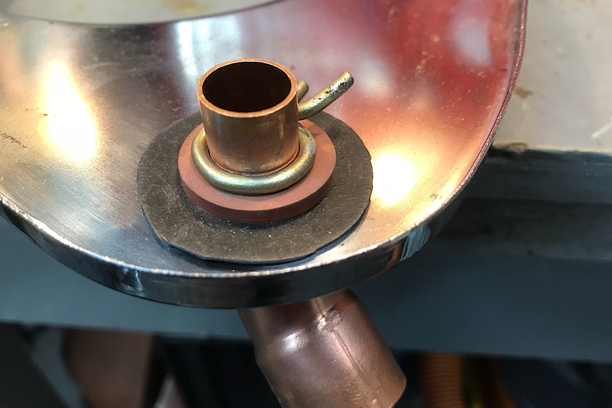

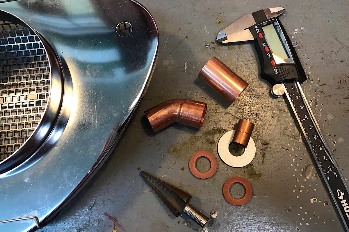

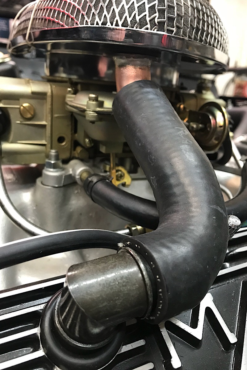

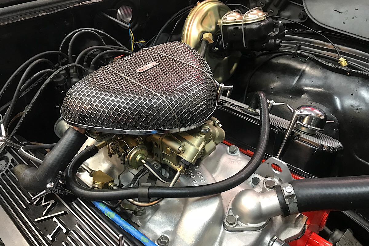

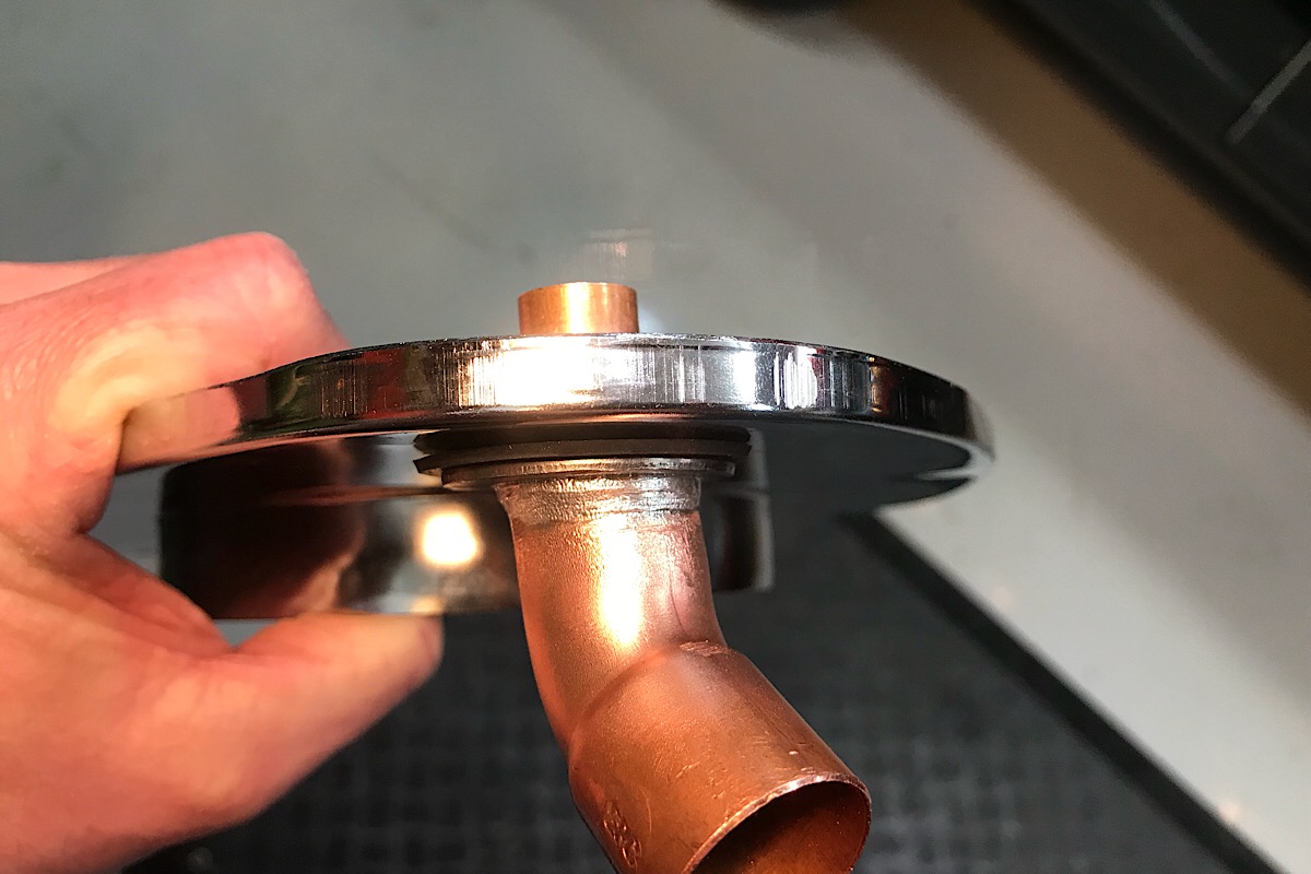

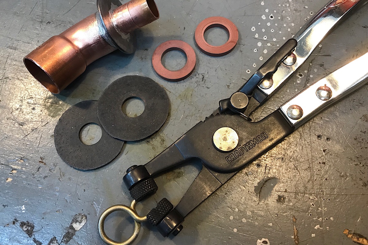

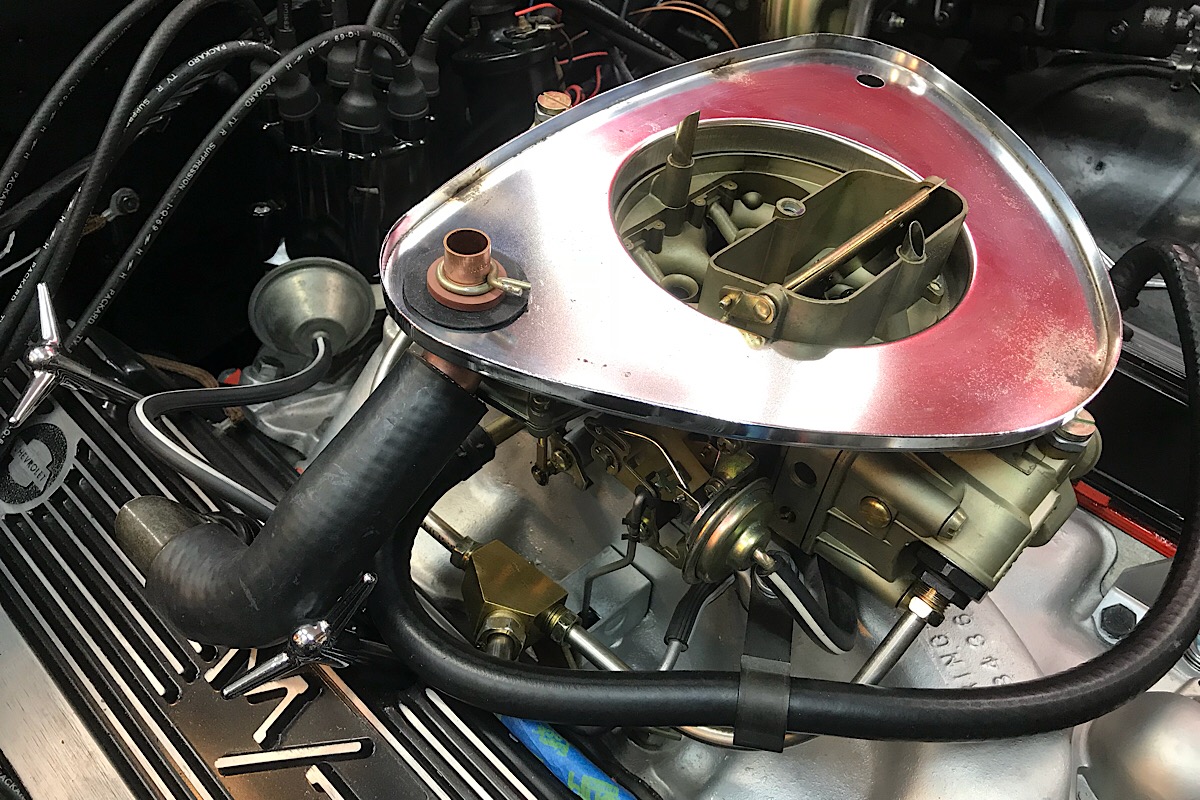

So I am wrestling with which air cleaner to go with. I see a bunch of round “fly-eye” a/c’s used and was hoping to find something different that looks good. The below triangular type popularized by Weiand, Ram-Flo, Edelbrock, etc. may be a bit late to the game for my ‘69 wrt when they were introduced, so I will have to consider that (suggestions are welcomed). If I use this Ram-Flo I will have it replated so it pops. Regardless of which I choose, I want to address PCV on the passenger side of the engine and will most likely use carb vacuum to take care of it. So, just like I did with the Roof Deuce I used M22Mike’s (Mike A) inspiration to create a junction between the VC and the air cleaner and I thought I would post one way to take care of this. I like simple so I used copper and steel so I could get away with soldering. I may paint this black eventually although there is a definite steam punk vibe going on now...

Dang.....your hired...

----JFO, (just for me) absolutely better than Fly-eye! Hope the haters don't hate......Bill S

Nothing here I don’t like! Attention to detail is “off the charts”!
