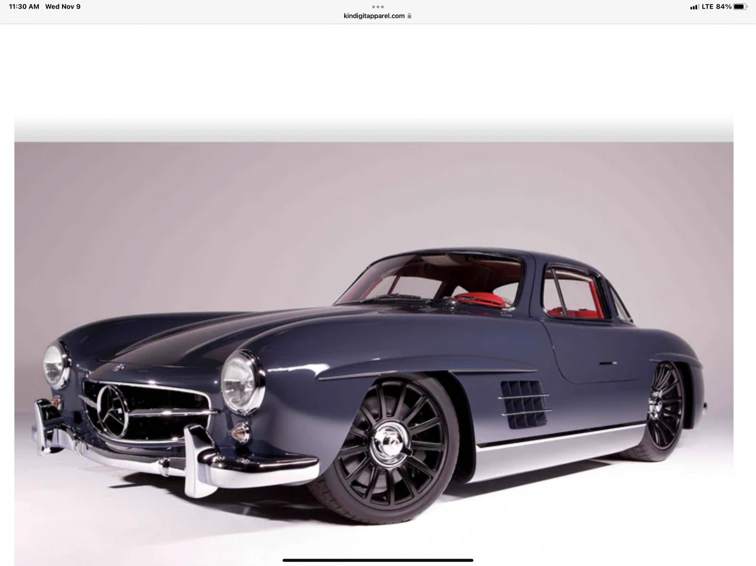

----The gull wing Mercedes reproduction redue comes to mind.....Bill S
Photo courtesy of Kindig’s Website
