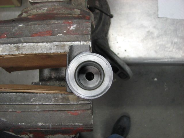

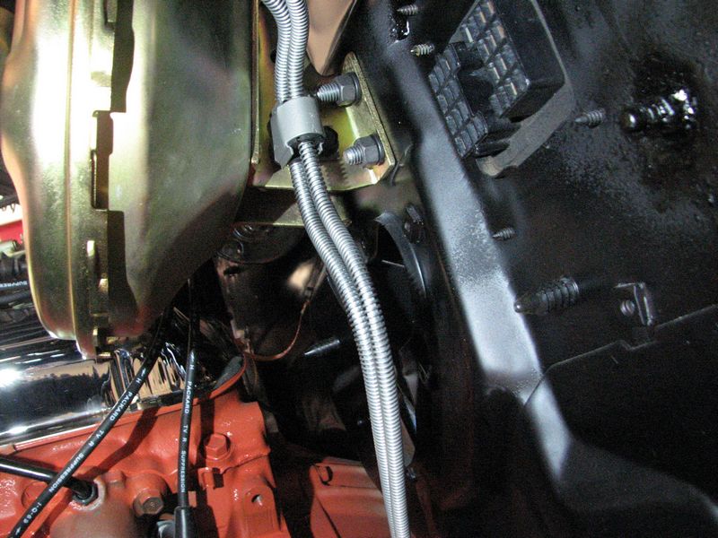

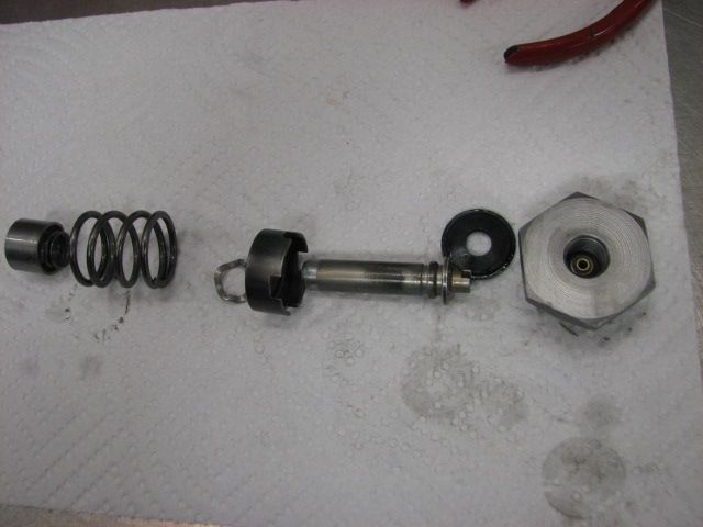

Last night we worked on the hold off valve, master cylinder and lines. Some minor detail work left to do such as stamping the front brake hoses and adding the "S" clip to the lines. The clip that holds the lines to the master cylinder is natural steel and has the part number. The bolt that holds the cad plated bracket to the master is one that I have never seen before so it was reused. After coming across a photo from the disassembly I saw that the brake booster was held onto the firewall with nuts and NO lock washers so I need to go back and remove the washers.

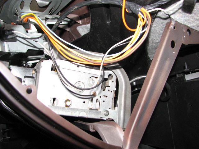

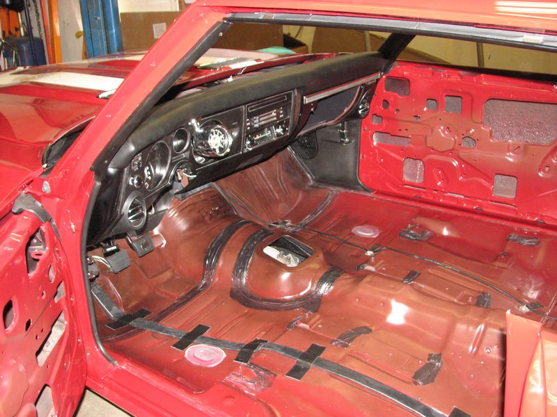

The dash installation was not as easy as a 70 version in my opinion nor does it fit as nice. Many thanks goes out to Phil Woj for supplying me with over a page of step by step hints with regards to the best way to install the dash with regards to what goes in first followed by the next. After installing it I am glad he did it as I would have done it in a different order and it would have caused me major headaches.
The gauges were all rebuilt but the faces are original and only needed a careful cleaning. The dash still wears its original paint, only the chrome trim was redone. The tach and monitor were both purchased from members as our originals were in very bad condition.
I also included some detail shots of the radio mounting for those that might be able to use it.
Tomorrow the headliner will go in. Then the carpeting will be laid in, cut and seamed under the seats. Once the seaming is done the sound deadener will get installed and then the carpet. I am having the stencils for the PPG glass custom made and as soon as those are done I will acid etch them into the glass and install them and the door panels.

Where the master cylinders not painted black and then the machined surfaces would be natural? I know Camaros they were from the factory although it didn’t last no time. Just gaining knowledge.
  #457
Old 03-09-2019, 12:43 AM
Posts: 10,322
Thanks: 3,146
Thanked 4,568 Times in 1,138 Posts
My experience has been that they sometimes but not always put a flash coat of black on them. They were then machined on the front where the code was stamped as well as the two flat surfaces where the outlet lines were attached. I restored ours with a light flash coat of black and then machined the surfaces as can be seen in the photos. Our original hold off valve showed no signs of any paint on it so I restored it as such. I found no date stamping on either piece.

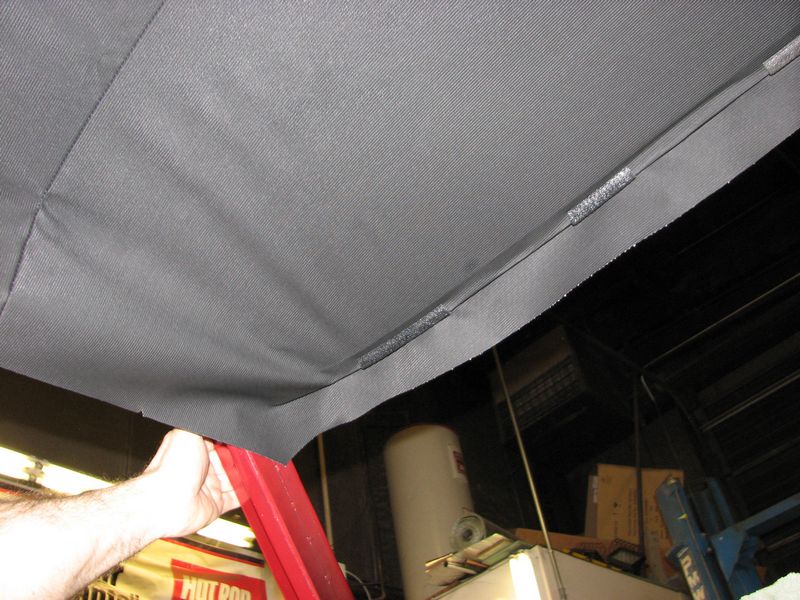

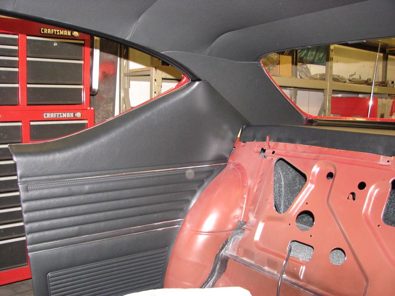

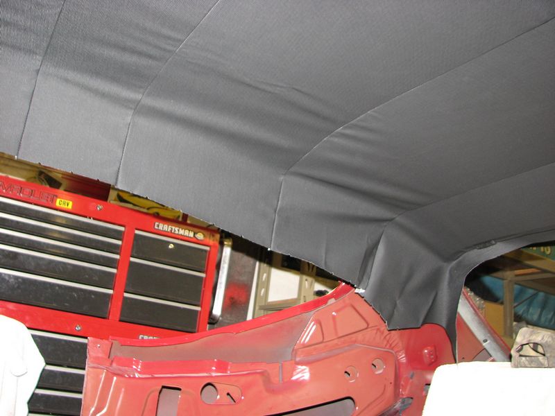

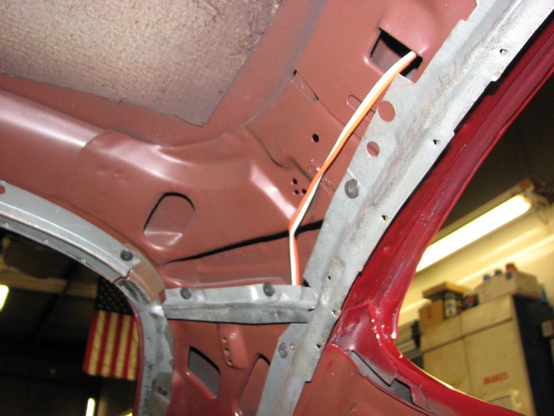

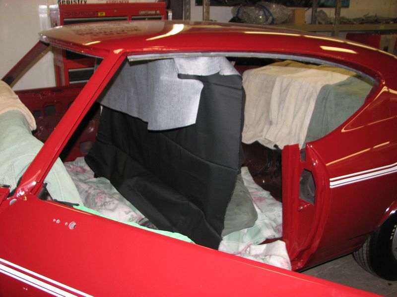

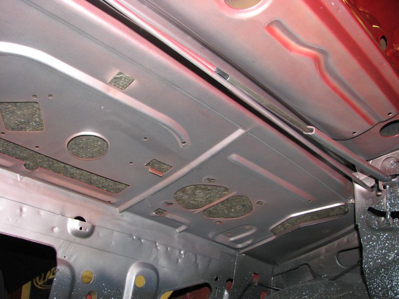

Today was headliner installation day. I usually like to stay home for these. LOL First thing people need to remember is to route their dome light wiring. Forget that and it will ruin your whole day. Cover the floor in padded blankets or towels as well as any part of the body that is exposed so no glue gets on it. I also cover the dash area.

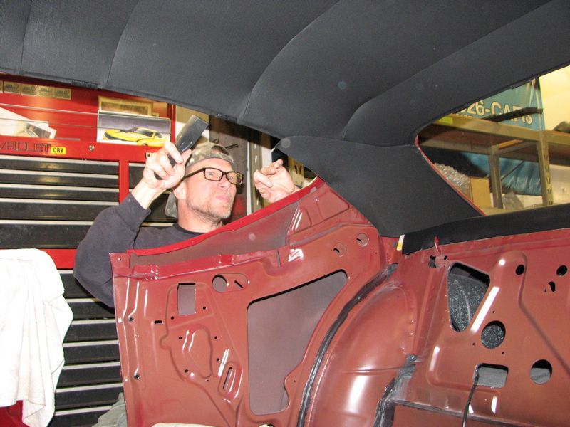

From there it is really a matter of getting the headliner very warm prior to installation (hard in March) and to stretch it evenly, carefully and slowly. Make sure you use a quality commercial glue and NOT one from a spray can. None of them work. We use both a steamer and a heat gun to help remove any wrinkles and crease marks from shipping though laying it out in the sun before installation works best. Be careful with the heat gun to not apply too much heat. This will not only over stretch it but will gloss up the black headliner in the area that received too much heat. Caution must also be taken with a steamer to not get it too wet or over steam it.
We cut some used headliner side molding trim into many short pieces about 4" long to use as clamps when gluing. Office spring clamps also work well but do tend to get in the way. After everything is up and glued then I replace the pieces with the stock moldings to help hold everything in place but this cannot be done until the sail panels are in place.
I reused the factory insulation pad under the package tray as it was still in good shape and simply glued it to the replacement package tray.
The said panels are usually the worst. I always order mine as non glued pieces. I then slightly dampen the cardboard and place it gently roll it over a large piece of PVC tubbing to give it a slightly bowed shape. Then I let it sit overnight with a weight on the center and propped up on the outer edges to retain the shape. Once it has taken a set and has dried I then gun spray glue the headliner material to them. This will allow the sail panels to conform to the C-pillars without the headliner material bubbling due to you trying to curve them after they have been glued. During installation I glue Velcro strips to the face of the C-pillar as well as the back of the sail panel. This will then hold the C-pillars to the shape you made them in. Todays installation took about 3 hours.
Weather permitting, roll the car outside in the sun, close the windows and allow it to bake the interior especially on a very hot day. This will pull the headliner even tighter and remove any small wrinkles and creases not already removed. If you recovered you seats, have them in the car as well as the heat will do the same thing to them. Hope this was helpful.
