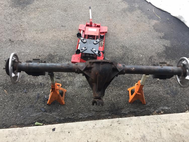

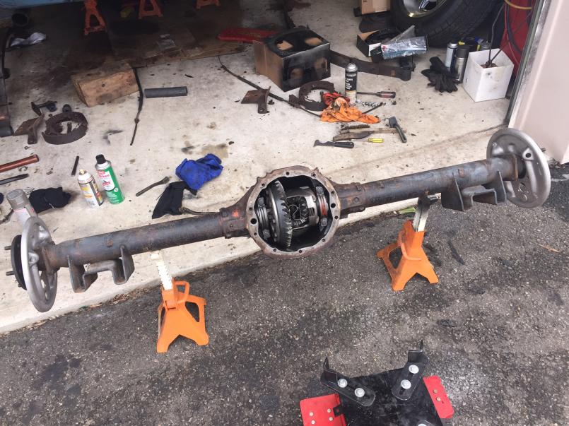

I stopped in at the chassis shop today and they already had the rear all finished. That was quick - dropped it off Monday, picked it up Wednesday.
Ended up costing $250 to set up the gears and an additional $100 to replace the axle bearings. He found that the small retainer bolt that holds the center pin into the carrier, was sheared off. The portion of the bolt head with threads was holding the remaining portion of the retaining pin in place. He said the broken piece came out with a thin magnetic probe. He indicated that this was a common problem he has encountered over the years. Whew!
The rear is back home now in the garage. That gives me something to start cleaning and painting now.

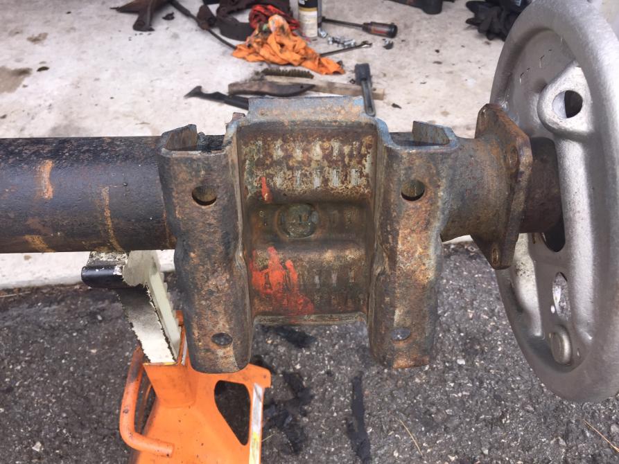

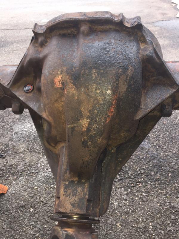

Getting ready to paint and reassemble the rear. I had the chassis guy who set up the rear, sandblast the backing plates and rear cover. Looks like the tubes and backing plates were originally painted black but the center section was natural cast. There is a remnant of the orange "E" on the top. Not much on the bottom. There are orange paint daubs on the bearing caps, where the tubes join the center section and underneath the mating surface of the spring perches.

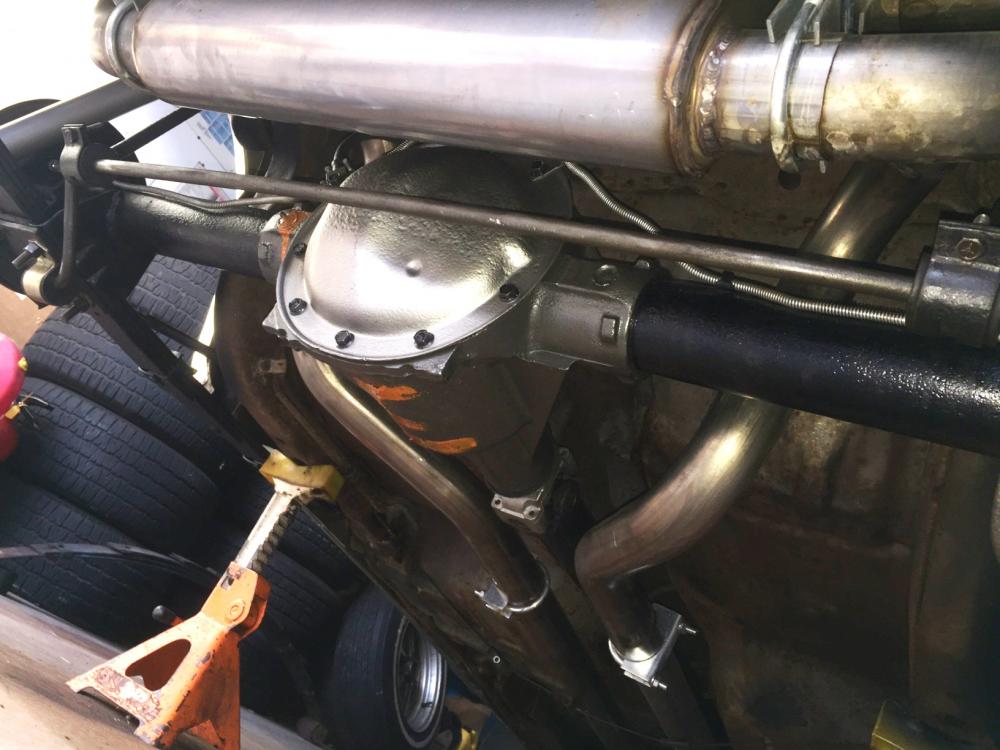

I got the new four-leaf, Trans Am springs installed yesterday and the 3.08 geared rear end back in the car, today. The new springs fit the perches a lot nicer than the old five-leaf setup did. This 1980 T/A rear end was made for a four-leaf spring pack. I installed a pair of KYB GasAdjust shocks to match the fronts. Everything is hooked back up with the exception of the rear brakes. I bought a new set of ProThane rear sway bar bushings for the 9/16" bar but they don't make the correct large bushing for the one-bolt sway bar drop links (only for the 1970-73, two bolt/two-piece), so I had to re-use the original large bushings. For some reason they make the large bushings for the 5/8" and thicker rear bars in the one-bolt version but neglect the 9/16" bar???
I have a new set of brake shoes to go in and had a pair of new wheel cylinders sitting around so I used them since I noticed that the originals were leaking.
Tomorrow the brakes and the new speedometer gear get installed.

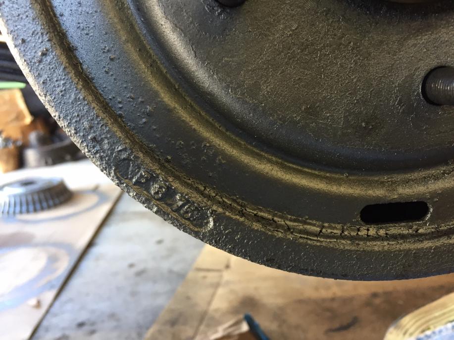

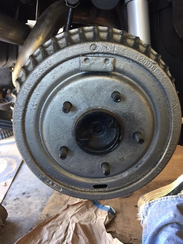

While finishing up the brakes, I thought this was kind of neat: the original rear brake drums, still with planty of meat left on them. Dated "F 8 75".

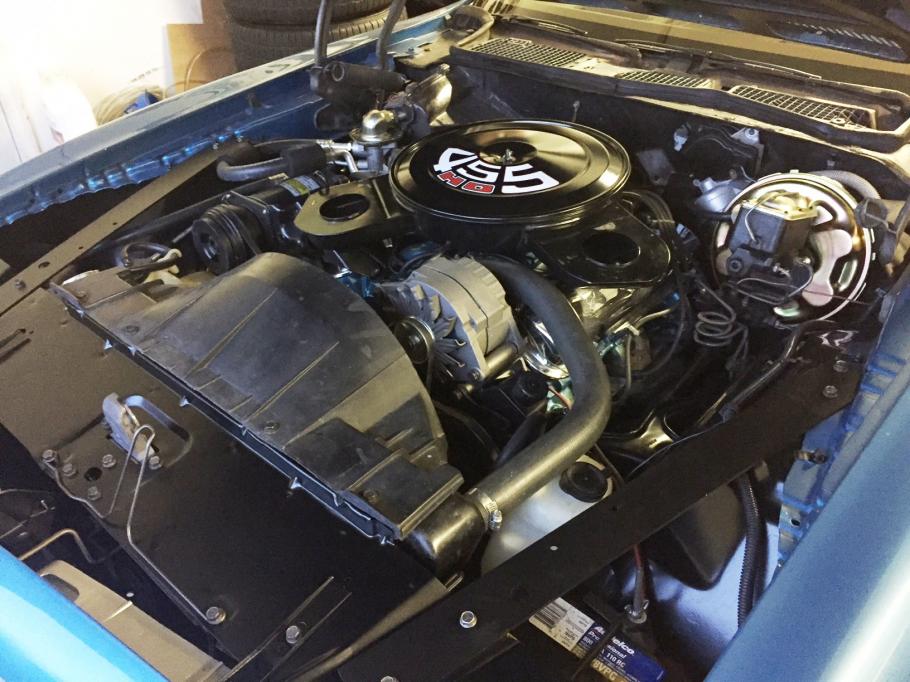

I sanded and repainted the top of the radiator support with black epoxy paint to get rid of the original "survivor" surface rust look.
I bought a set of the InlineTube reproduction fender to rad support bars and installed them.
I installed the shiny new repro brake booster and bled the front brakes.
I adjusted the parking brake which had been too loose after the rear end installation.

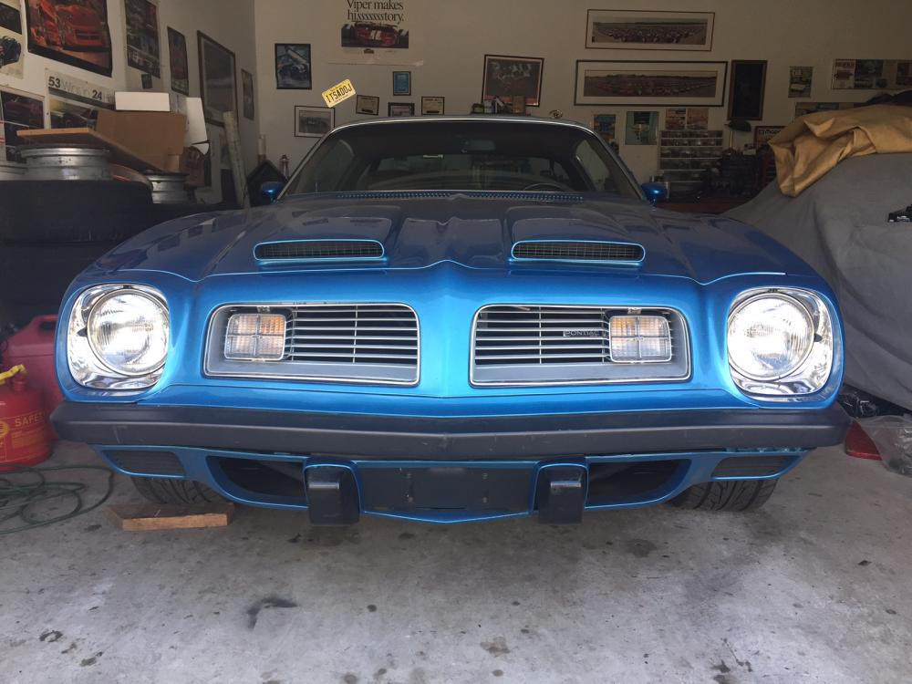

I also pulled the grills, sanded and repainted them using wheel paint sprayed from about a foot away so it gave a nice dry, sparkly finish like the original.
I cleaned the signal lenses and polished the chrome bezels, too.
And yeah, I added an old leftover "455HO" decal I had sitting around. The air cleaner looked too bare and needed something to spruce it up. And technically, the 455 does have the rods from my old 455HO in it... ;-)
After all that I put 5 gallons of aviation fuel in the tank to give her a treat.
I ordered a new ColdCase radiator which should be here tomorrow. Then the shroud comes out and gets refinished, too, during the installation process.
