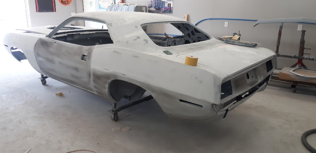

...aaaaaand another 8hrs of blocking. Ugh. I'm telling ya, this could be the best new cardio-workout ever!
Here is the start and the low spots on round 2 of 220. They're getting less and less but then others pop up where none were before! This is some sort of Ethic Far East Aqua Persuasion (that's about the best I can do to be politically correct) for sure!
But this just in, Steve said he's going for that "Day 2" look, so the bucket of white house paint look it is! Phew! Now I can relax and paint it tomorrow!

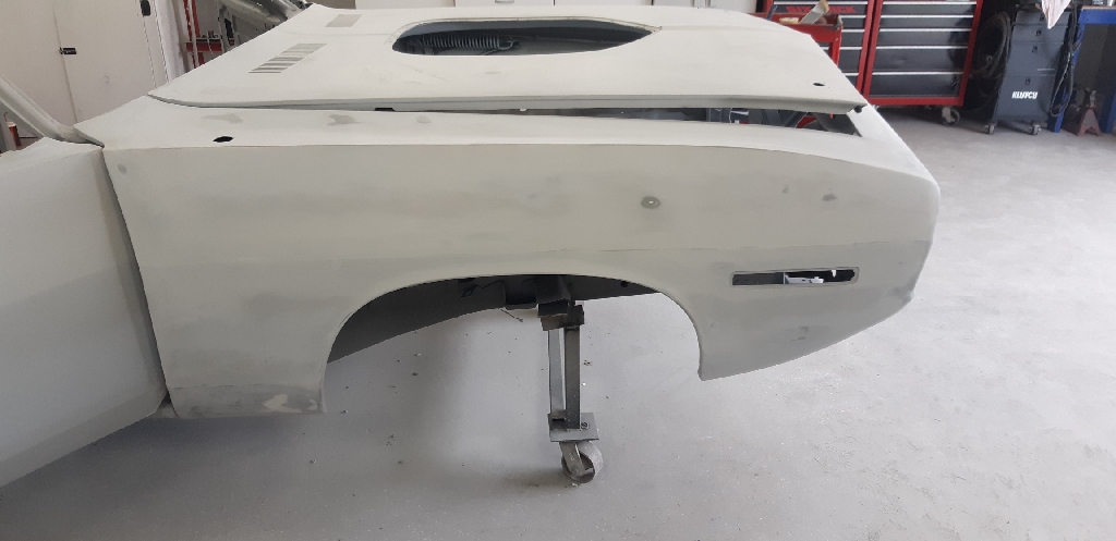

Final 220 block and then prime!
The lower rear valance was really fighting me, so this side is way better. Need to work on that body line, but the gap is way better. Next up... the other side!
