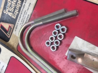

I bought 5 sets of NOS bars from the guy who bought out the huge stash of vintage speed parts from the old S&S Speed in Falls Church VA that was featured in the magazines 15 years ago. Rectangular bars. I estimate the bars were 71-75 era -long tails with rear spring clamp. All had black phosphate nuts and u bolts were gold cad. (J bolts never came with the bars-they were optional)
I looked this morning at the j bolt and u bolt NOS packs I have from early 70's all have gold nuts.
