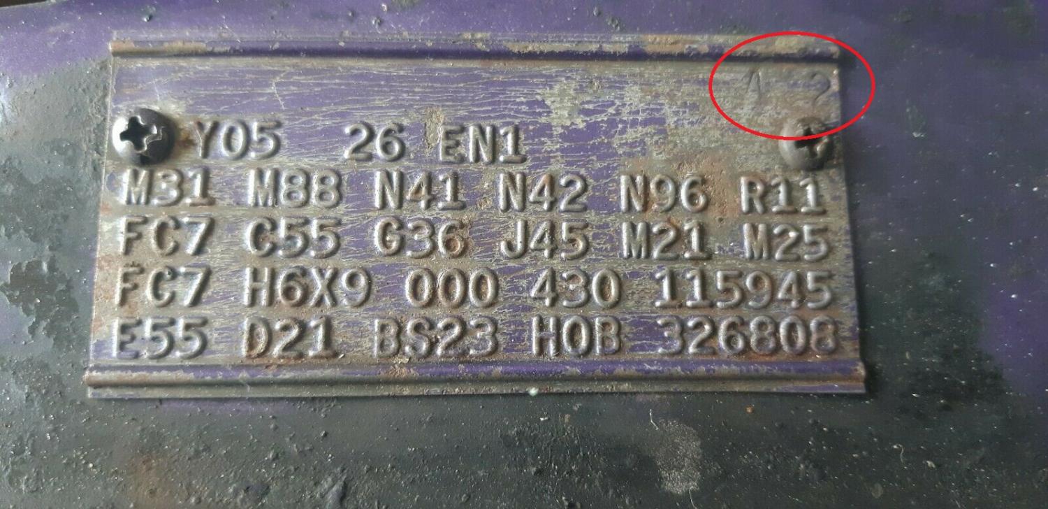

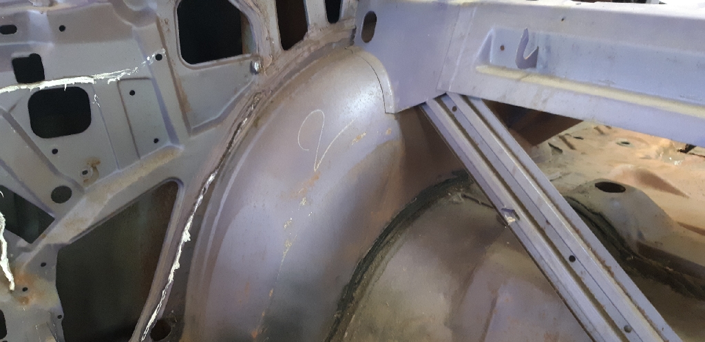

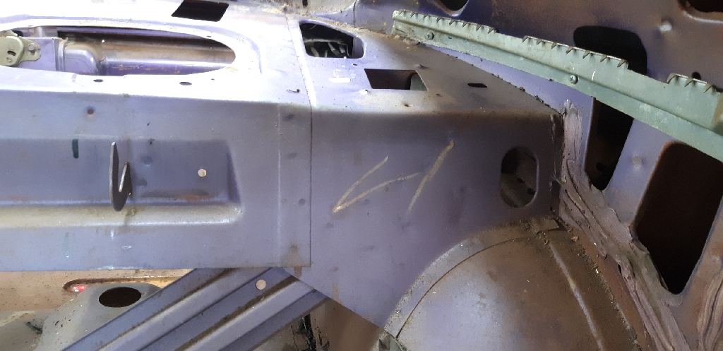

I just noticed something while perusing the thread. Remember the "4" and "2" that were crayoned on the inner wheelhouses inside the car? They just happen to match the "4" and "2" that are stamped on the upper right corner of the fender tag. They are line inspector ID stamps.

Hmmmmm....yes, but would this be for one inspector? And if that’s the case, they’d be located together, no? And with that, if it’s two inspectors, then why would they be located on the same part of the car only feet apart? But I agree they’re inspector marks!

Maybe one inspector was assigned to the passenger side, and one to the driver's side of the production line? Or they were playing a game: "I'm thinking of a number between 2 and 4...

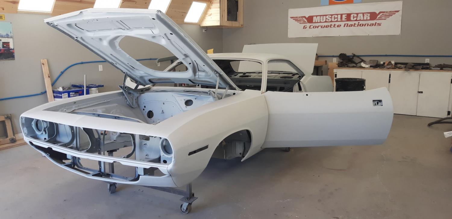

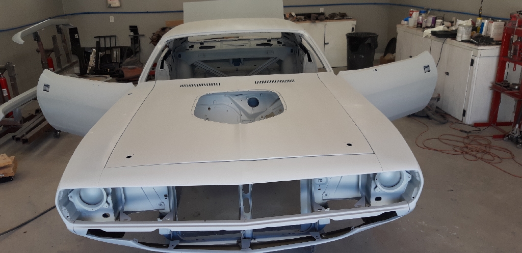

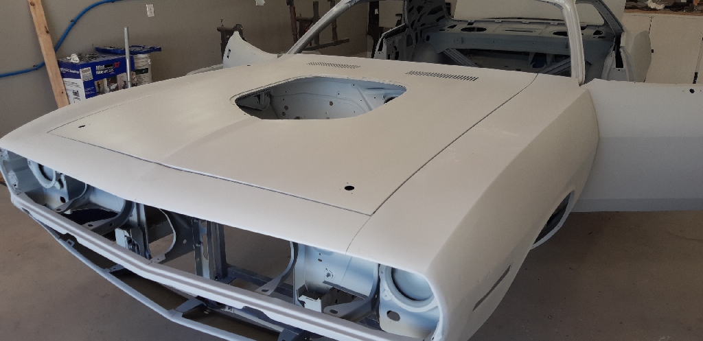

Here's a photo Dave sent me today. He's busy working on the 'cuda instead of posting updates. (which is fine with me). :-)

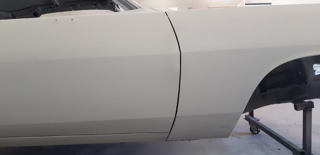

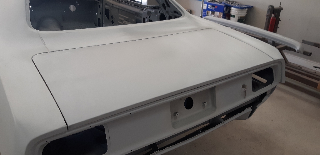

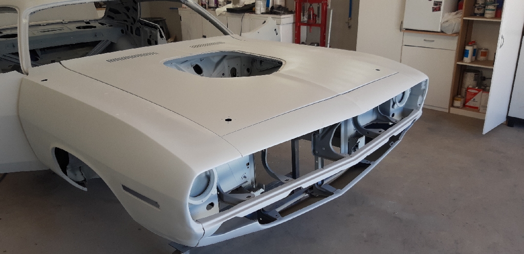

Oh, now come on Lee. You know neither of those are true! Ok, maybe that insomniac thing. Does that have beer in it? But as of today, the trunk, jambs, and engine bay are ready for paint!
A good day of aligning body panels, followed by another day of aligning body panels, chased by another day of... you guessed it... aligning body panels. Ya know, I really liked that A12. No damn hood to align. And tweak on end of the hood a certain way and the door on my Ram 2500 doesn't shut right! Seriously?
But no matter, after several hours of struggling I think it's looking pretty good. And now that I'm devoid of fingerprints due to hand sanding the trunk, jambs and engine bay, time to give the paws a rest and break out the long boards for a block-fest to end all block fests!
Not entirely happy with the rear valance alignment so I'll be slicing that up a bit to make fit better. I used Slicksand on the trunk floor and interior to fill in the small voids. It did wonders for filling in the pitting in the trunk. Also blasted the bumper brackets.
A productive week with more to come next week. You won't want to miss those episodes!
