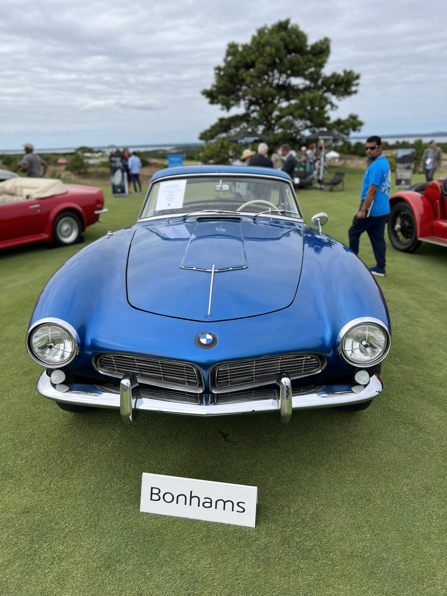

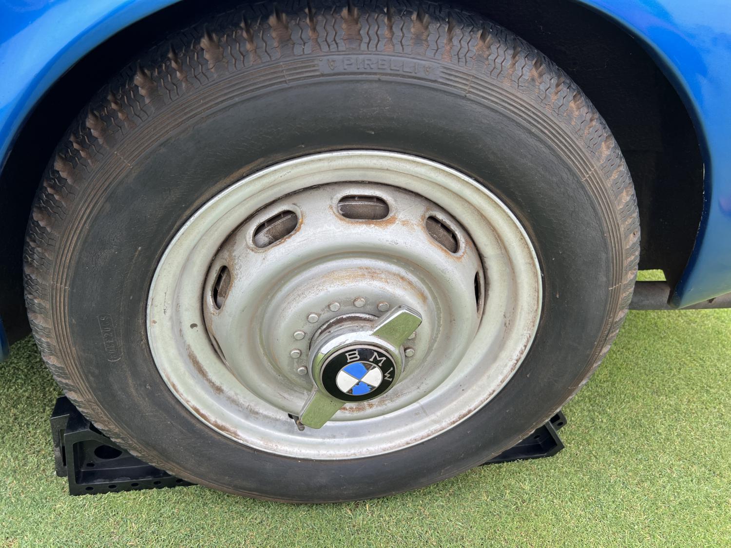

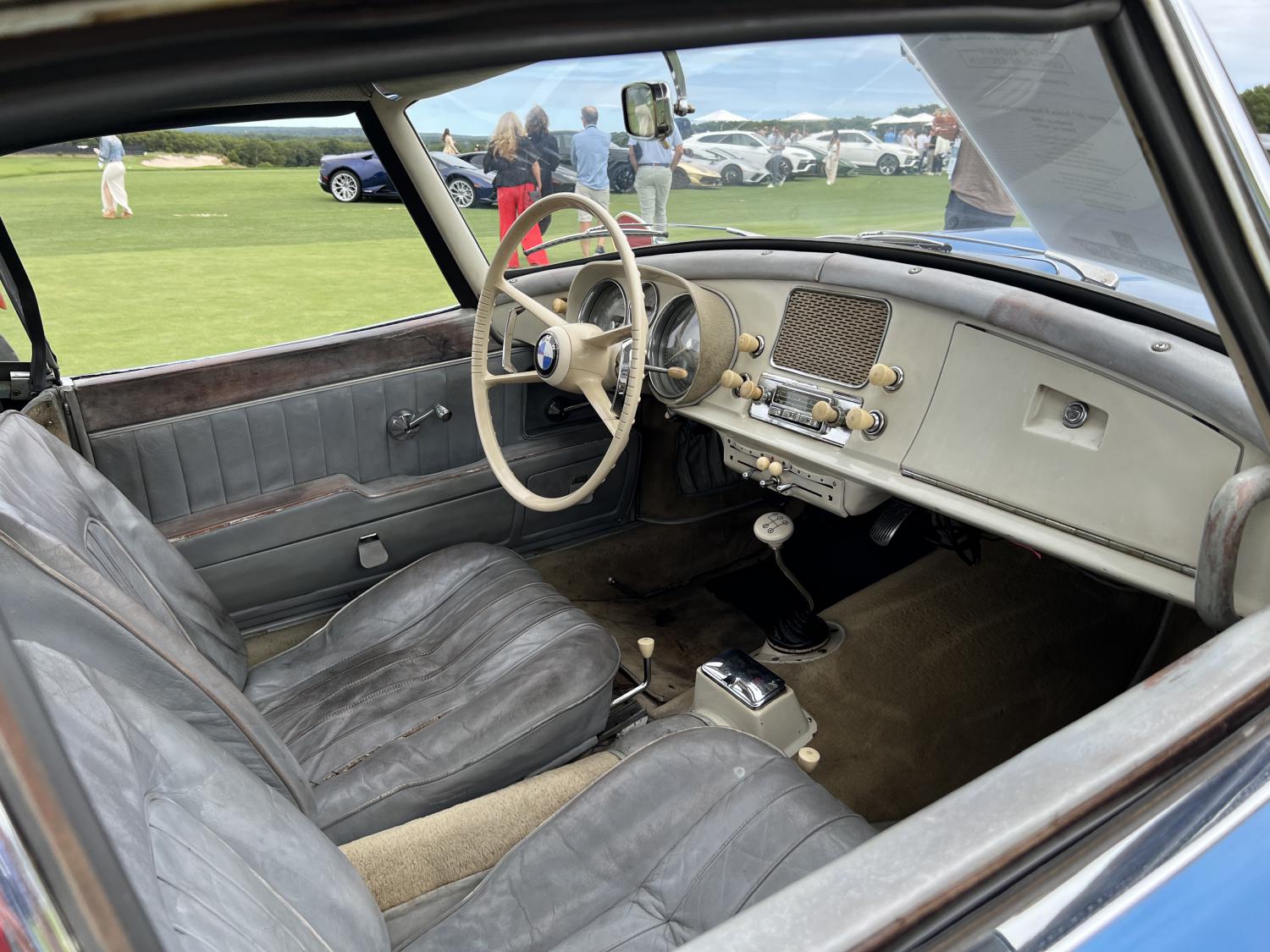

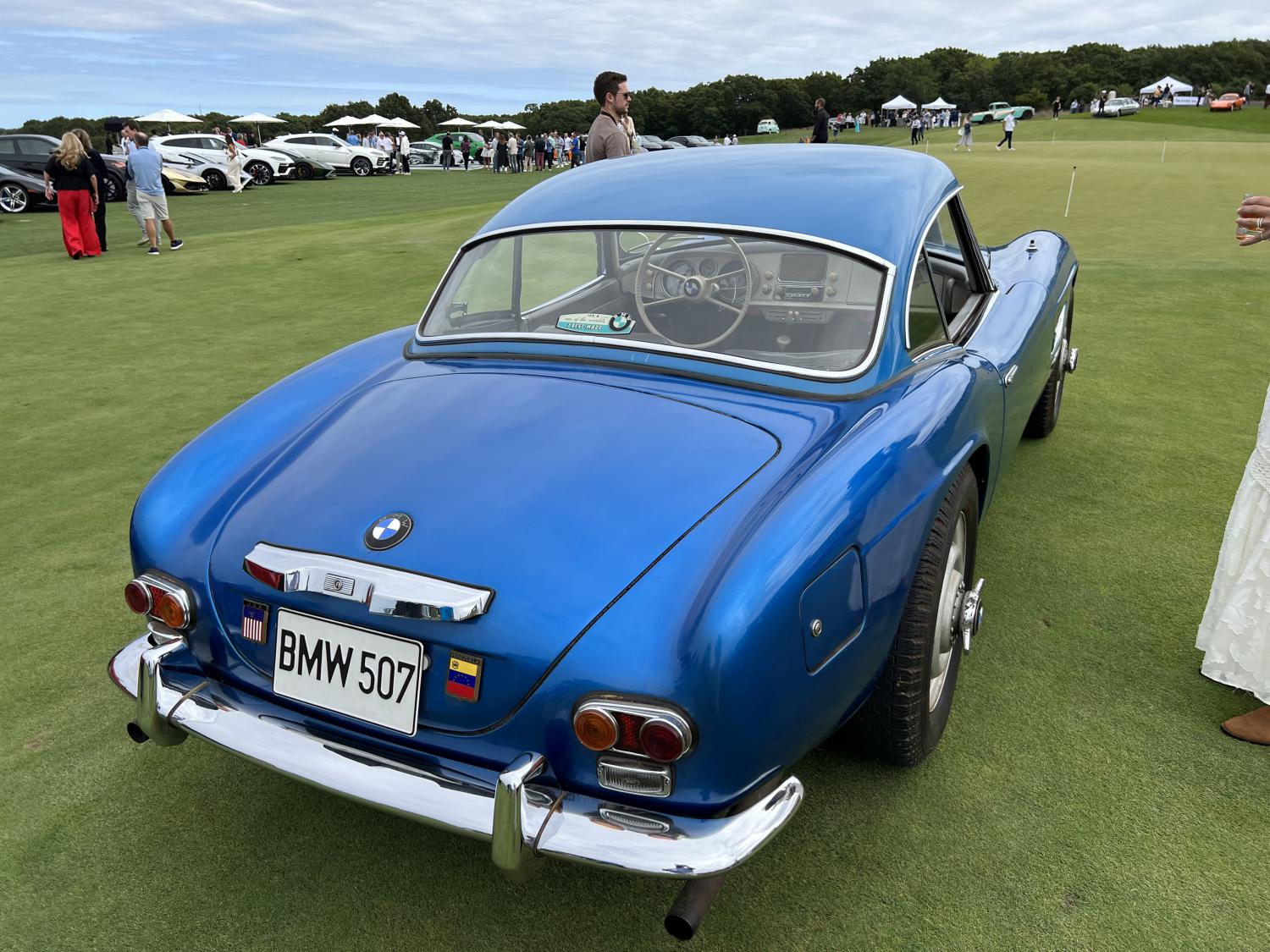

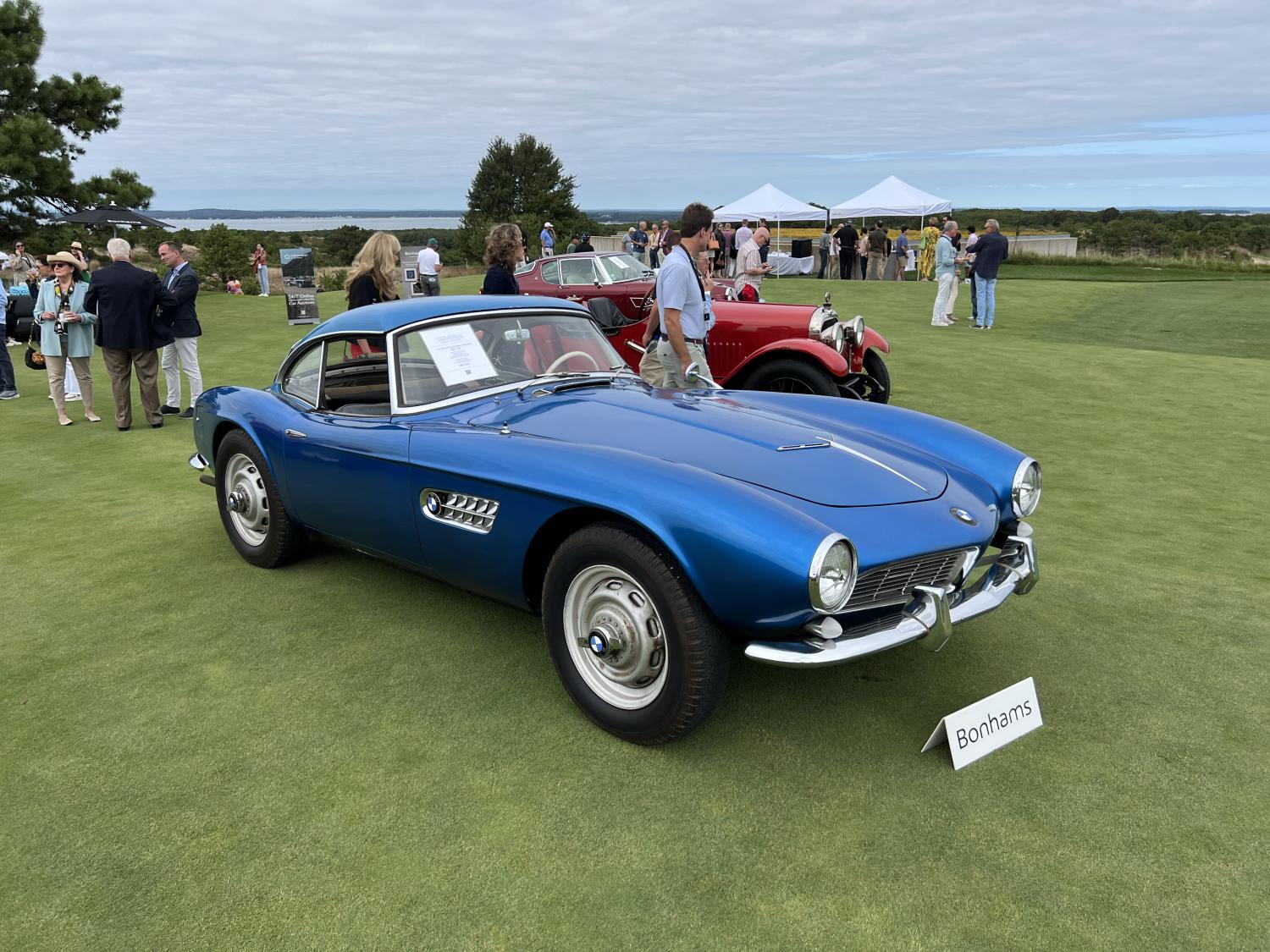

Dave, had the pleasure of seeing the elusive 507 just pulled from the garage in Philly. It was actually the second 507 I saw this past weekend but I’m not able to post pics of the first one. Enjoy! This is a 1 repaint survivor type.
