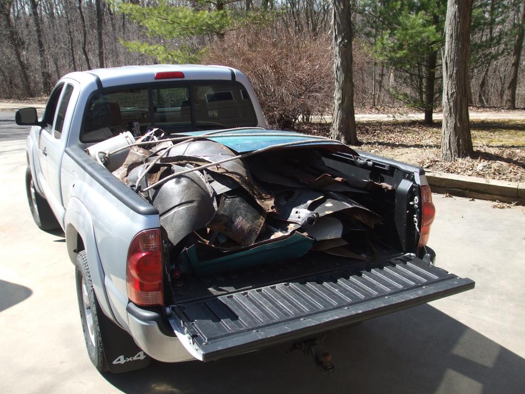

Old 04-01-2015, 06:24 PM
Rixls6 Rixls6 is offline
Join Date: May 2006
Posts: 2,685
Thanks: 22
Thanked 129 Times in 46 Posts
Default Re: Black L78 1969 SS396 300 Deluxe Post Sedan Found
Some assembly required???
380 Lbs of metal from the car.
Hey, a whole $19 worth. Woo Hoo!
[img]<<GRAEMLIN_URL>>/hmmm.gif[/img]
Rick
Don't text and drive.
Old 04-02-2015, 08:44 PM
Posts: 6,311
Thanks: 1,603
Thanked 1,918 Times in 928 Posts
Glad to see the sun shining and all the white stuff gone from view.....and you are $19 to the good to boot!

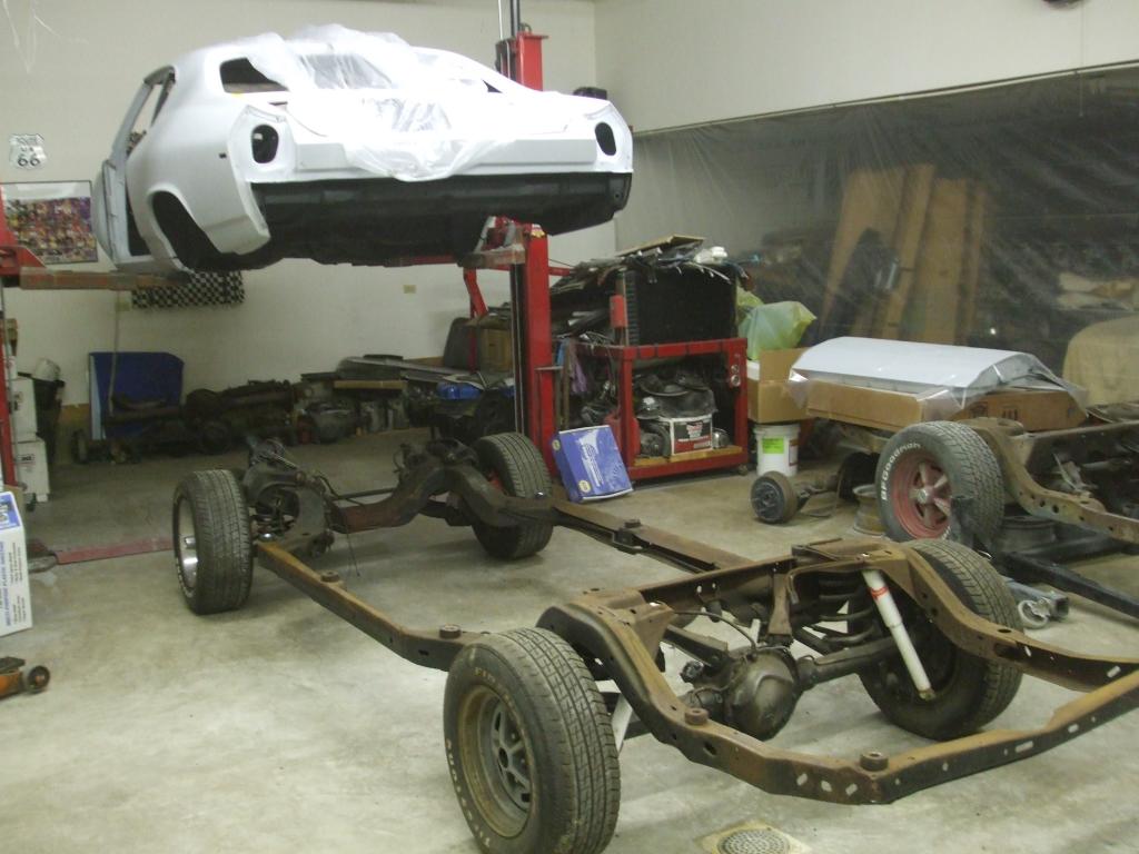

Old 04-15-2015, 11:29 AM
Join Date: May 2006
Posts: 2,685
Thanks: 22
Primed, sanded, reprimed, sanded some more, a final of 600 grit, and seam sealed.
Going to the paint booth on Saturday.
Rick
