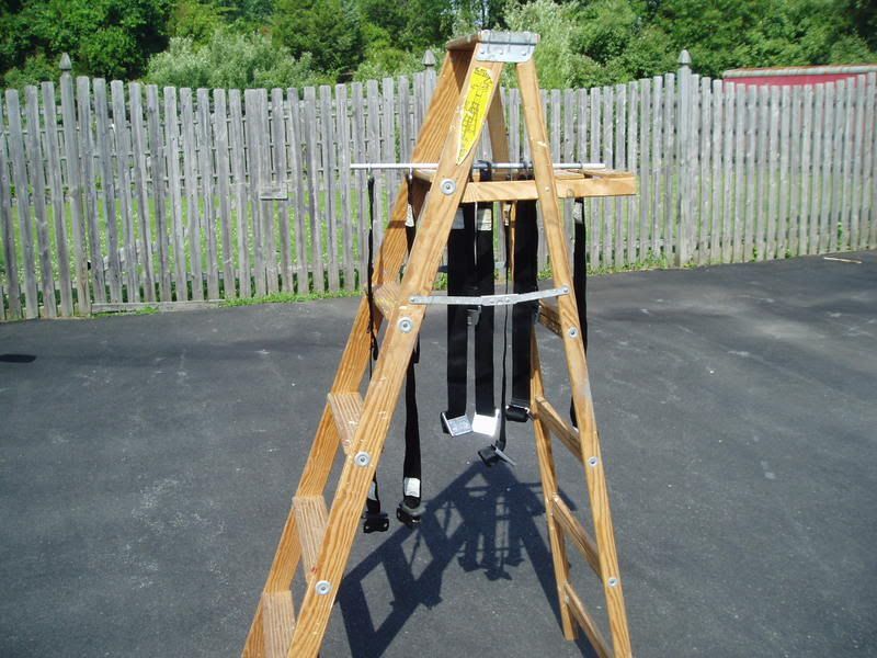

I took on the seatbelt project over the weekend. This car has the deluxe seatbelts with the satin chrome covers on it. Since it is an early (12A built) 1972, it has the 1971 style shoulder belts that have the bizarre little plastic retainer that screws into the headliner. They employed a 7" section of black elastic that, over the years stretches out to 20" and no longer holds the shoulder belts above your head. Only recently have the unique plastic retainers been reproduced. (Though some guy on ebay has been selling them as "NOS" for $90 for 2 years now )
I spent a day cleaning the belts after removing the covers and push buttons. I soaked the whole set in a solution of 10% Purple Stuff and 90% hot water. I let them soak for about a half hour and then gently scrubbed with a plastic bristle brush and rinsed them in hot water. I then hung them out to dry in the 95 degree sun. They came out squeeky clean and even the labels looked a whole lot better (I was extra careful using the brush on those).
Here's the unique seatbelt drying rack I have patented:
And here is the full set after drying. As you can see the shoulder harnesses have a whole bunch of stretched out elastic that needs to be replaced:

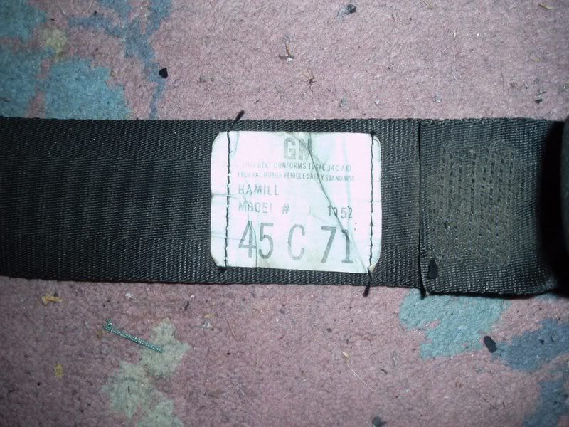

Here's the labels:

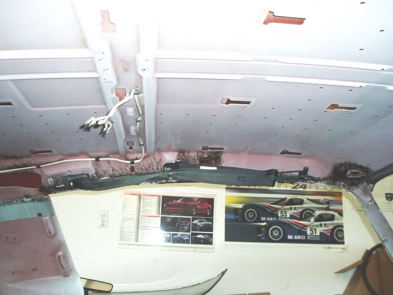

Here is the strange shoulder harness mounting system used on the 71's and early 72's:
The male buckle end clips onto an extremely fragile, clear plastic, do-hicky. This one actually survived 35 years in one piece. Normally you only find the screw left and no plastic do-hicky. This piece is now reproduced for about $32 a pair.

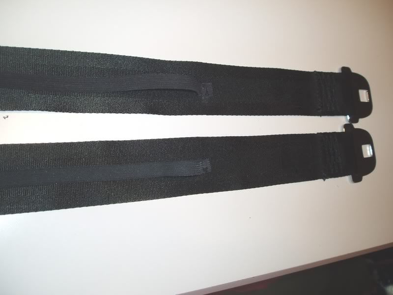

Here is the shoulder belt in it's original state. As you can see the 7" long section of 1/2" elastic stretched out to 20" of 1/4" elastic over 35 years:
I gently trimmed the factory stitching from the elastic and removed it after marking the area with some chalk. (There is a left and right belt and the elastics go on opposite sides). I then cut a section slightly longer than the original distance between the two mounting points, folded the ends and hand sewed them onto the belts. Here is the finished product:
The whole set is now all finished and ready to go. Though I could use a couple nicer satin finish covers in case anyone has an extra few just lieing around the garage somewhere taking up space.
