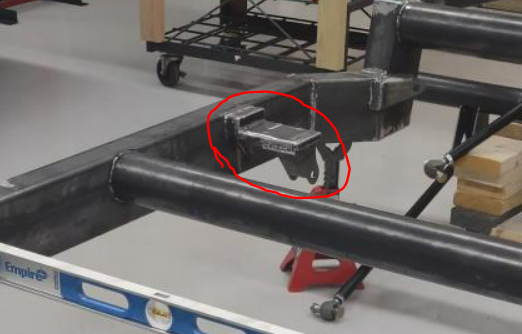

So today the frame is back on the ground and I'm going to install the suspension again. I'll then start with positioning the firewall and start in on floors. I final welded the rest of the 4-link mounts and notched the lower forward mounts for floor pan recess. Engine and transmission show up next week so I can get those mounted too.

Dave,
I enjoy watching this project get built and appreciate being able to follow along - it's looking great. As an engineer, something caught my eye... On a four link, all the force driving the car forward comes through the lower links (those are in compression) while the upper links are in tension. The lower four link brackets in their current configuration are cantilevered in two directions - horizontally inward, then hanging down. The suspension will be trying to "twist" that bracket off the frame rail anytime power is applied. Can you tie those into the crossmember in front of it, gusset them to the frame rail, or run a continuous crossmember across the frame rails there? That is one of the most stressed areas on a chassis - right now it is the most flexible portion of that frame section. I attached a picture of a Chevy II four link conversion with how the subframe connector gets tied into the LCA bracket - if you could do that to the large crossmember tube, it would help a lot. Just my 0.02... Luke

Greetings Luke,
That's incredibly good advice. Yes, I can do that with no problem. I wasn't aware of that section being so stressed so yes, I can add something that way. The notch was due to floor pan recess but I can easily apply a gussett and a frame extension to that crossmember. Thank you for the suggestion! ![]() Cheers Dave |

No prob - happy to help! Want to make sure you can fully harness all the fury the 215 can unleash; which in a light car should be plenty
