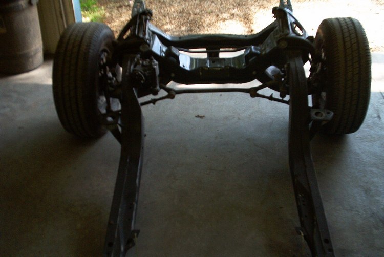

the hugger gets naked 1

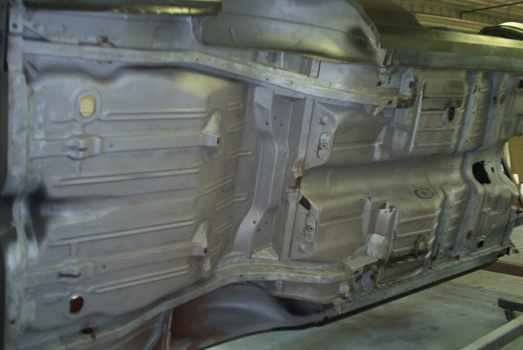

the hugger gets naked 2

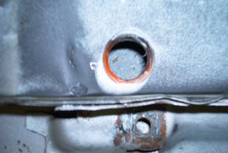

the hugger gets naked 3
