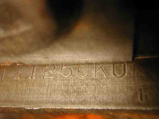

I have a better pic of that pad.
Looks reasonable, but I don't have many Nova pads to compare it to.
try this....

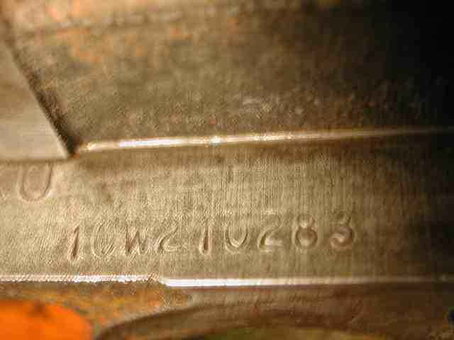

and...

knowing some of the history on that frost lime nova, i agree with kurt. when i saw the car it was very original, with doc and some owner history. i have no reason to doubt the cars authenticity, or the originality of the pad stamp
