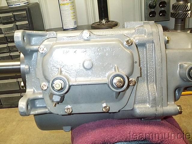

Picture of Muncie side cover with T.C.S. switch.
John Brown
