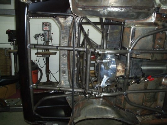

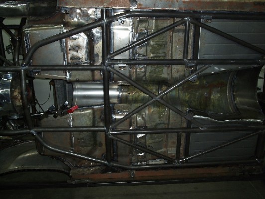

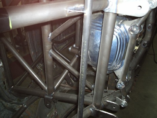

Here is a couple veiws you can't normally see.

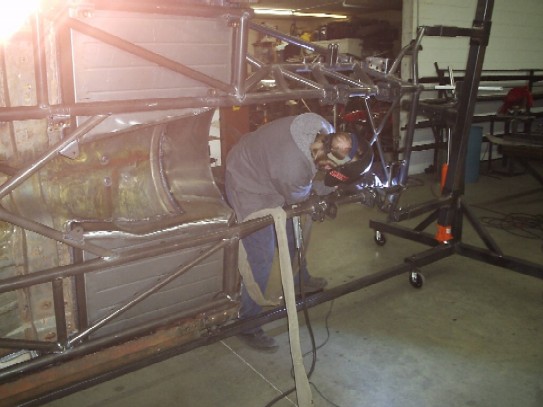

The fab shop is finishing up chassis welds. Next will be belly pan. I will get with Dan to get some specs on all the goodies . TIM

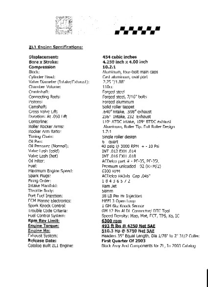

And the stuff to back it up
