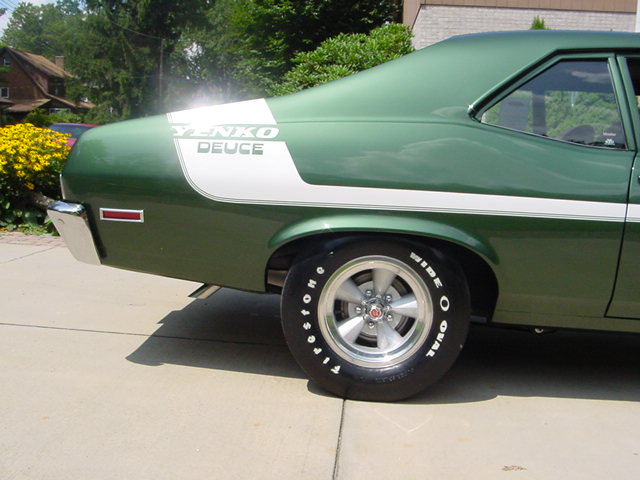

As for the exhaust, I'm not sure about the muffler being the same as the camaro, but i do know the tailpipes were not the same, the nova pipes turned down behind the rear wheels, and did not exit out the back like a Z/28. The tips were not chrome. Gardner makes a nice exhaust for these cars, and takes alot of the guesswork out. I attached a pic of my exhaust exit location, of course its the same on both sides.

Thanks Joe. That Helps.
