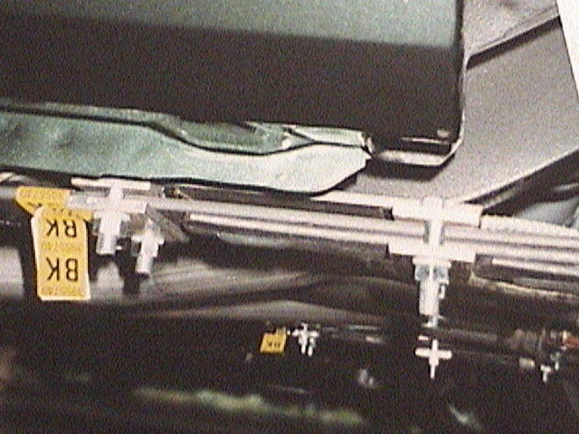

Here is a spring clamp on the Dick Harrell Camaro owned by Bill Ogle.....I made a set for my Camaro after talking to Joe at the reunion,they work great.I mounted mine upside down,the traction bar on my car hits the flat bar not the spring.I had some severe "S" bends in my springs.After installing these clamps my springs are now straight,no more windup,and I now launch straighter.I have used the set-up before without the connecting flat bar,but the difference between the two is noticable esp with traction bars.Good luck.

I had never ran spring clamps on our Camaro (don't ask me why!) until this past fall, when I was at a bracket race. I had the clamps and thought I would try them...they dropped an easy tenth off my 60 foot times, and made the car VERY consistent. You want the front leafs as still as possible, and many people even clamp an extra "leaf" or piece of steel to the top of the leaf to stiffen it. It is legal to adjust the pinion angle, but I have yet to do it. Maybe Pete can shed some light on how much it helps.
That spring clamp pictured looks EXACTLY like the clamps I picked up this summer at the local parts store...Mr. Gasket, I think?
