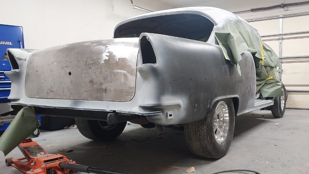

Cale stole the slots and L60-15s off my 68 Chevelle to do some test-fitting so we can clearance the quarter lips before we do the body-work.
I have to say, they look badass on it!

The slots are 15x8 with 4" backspace rear, and 15x5 with 2.5" backspace front.
Tires are bias ply 275/60 Coker Pro-Trac and 6.40-15 Coker Firestones.
The clearances are pretty tight to the outside in the rear, so we'll run either a 4.25 or 4.5 backspace on it when we order wheels for this car. These are just borrowed off my '68 Chevelle for fitment-check before we body-work the quarter-panels.
He's probably going to run these same size tires, but on chrome steel wheels since he's going more for a mid-60s look than the early-70s look of slots.

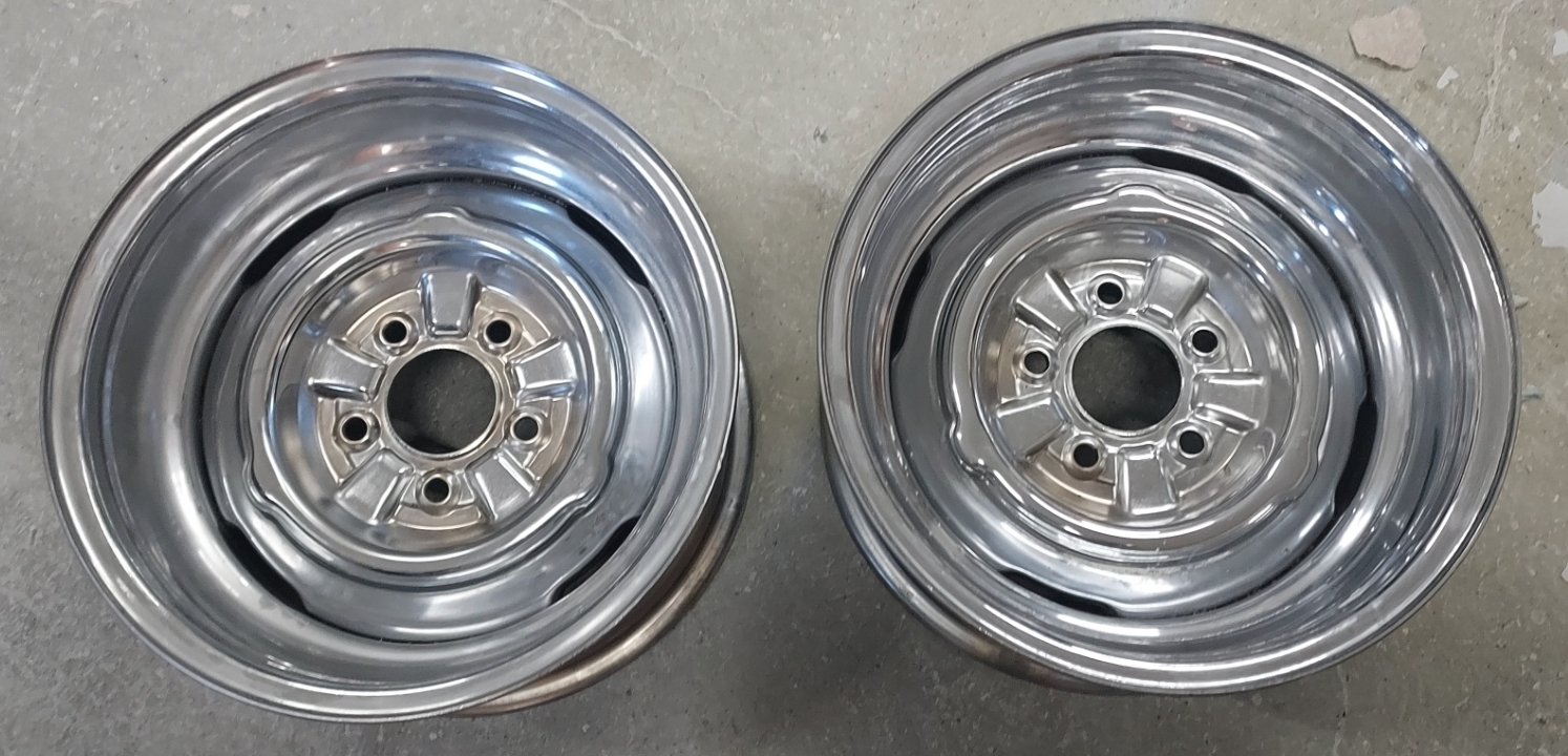

Cale scored a nearly impossible find on Marketplace today. He got a pair of 15x8 Chrome Reverse wheels with Chevy bolt pattern and 4" backspace. For some reason, nobody makes these anymore.
We just need to find some 15x5 or 15x6 fronts now. Fronts won't necessarily need to be reversed, so the current available closest thing to this style new ones from Speedway Motors will probably be good enough...
