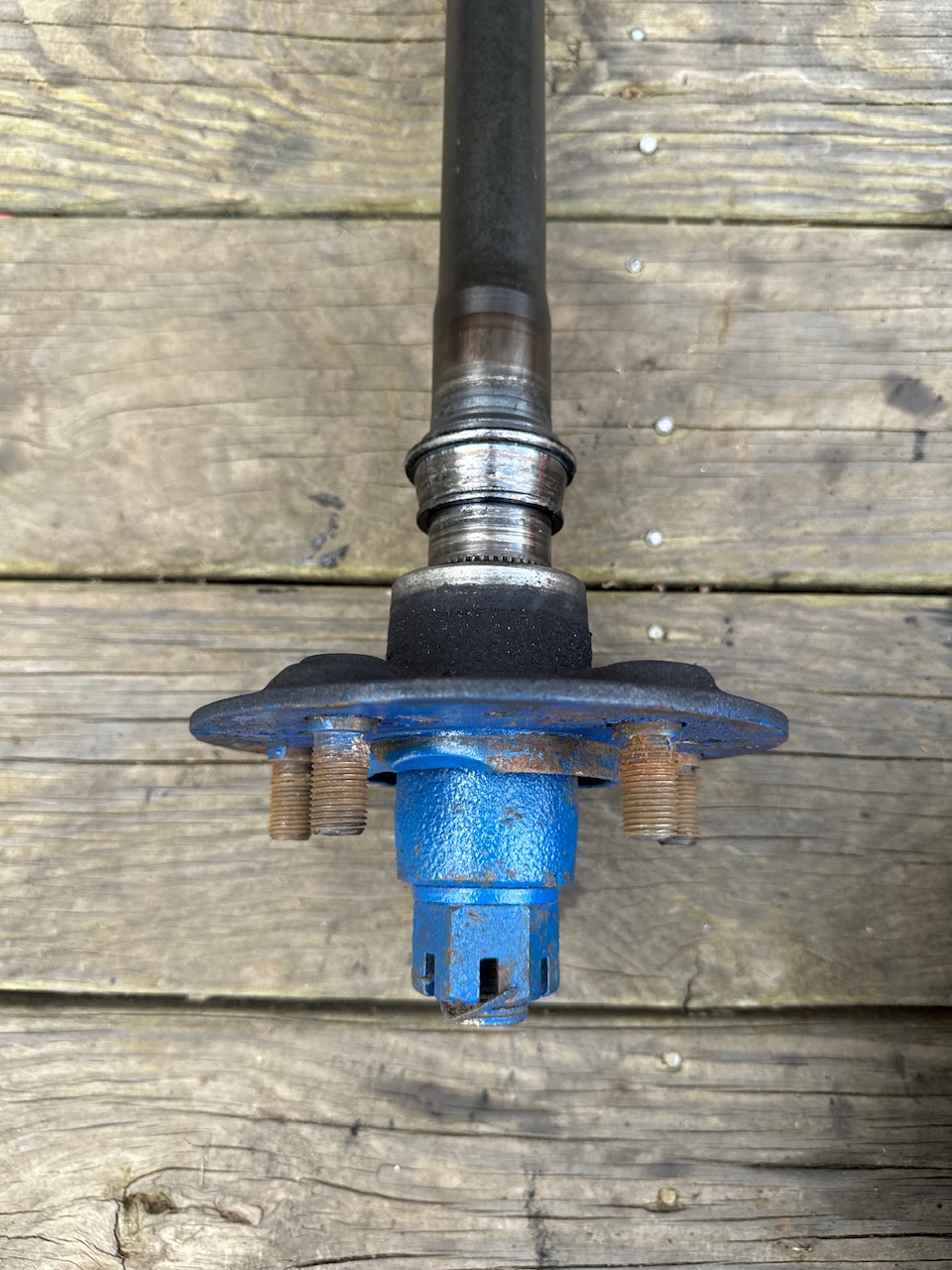

On a separate note, had the car out for about 50 miles yesterday. I had to run to my engine machinist about the Gasser engine block. And make a few other errands. I took the Hornet, but unfortunately I didn’t make it home lol. It started making noises in the rear about 20 minutes from home and I made it more than halfway from there before the wheel bearing came apart and allows the axle to walk and kill all motion. It ended up on the same flatbed that rescued the car when I bought it. I already have the car apart and hopefully next week I can replace all the seals and bearings so I won’t have to worry about it again.

Dang, that bearing was as dry as a popcorn fart, from all those years of sitting.
Yes, I may have been a little lax on inspecting the questionable non-original rear axle lol.

Got the car all put back together. New axle bearings and seals, fresh oil and added posi additive this time. Car drives much nicer so I’m assuming those bearings were junk from the get-go and I probably should’ve changed them when I initially was going through the car. But it’s all fixed now. Drove it about 25-30 miles yesterday. It’s a fun awesome car and I’m enjoying it more than I expected.
