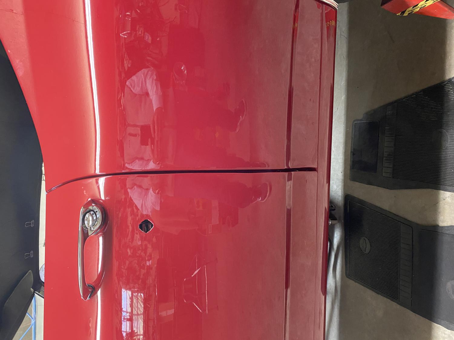

are you sure the handles are original? a 70 handle will not work on a 69
69 SS L78 Chevelle
70 SS 396 Chevelle
  #32
Old 03-03-2023, 06:48 PM
Posts: 10,330
Thanks: 3,188
Thanked 4,599 Times in 1,142 Posts

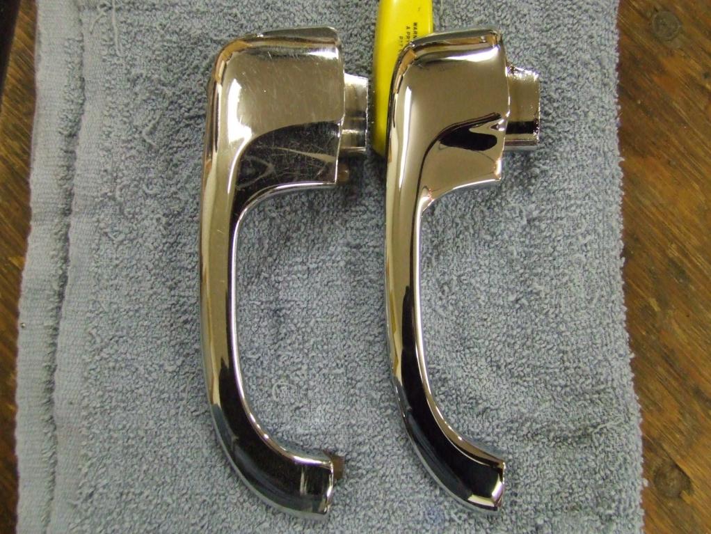

Donnie is correct. The 70-72 handles have a much flatter mounting area than the 68-69 which is cut at quite and angle. I cannot imagine that the issue is in the door panel as that would be quite noticeable let alone hard to screw up. Look at the angle of the mounting area on this handle in the photo and you can see how much more cut angle it is than yours. Sorry but this is the only photo I have that has an almost straight on shot of the door handle.

here a pic 70 on the right 69 on the left

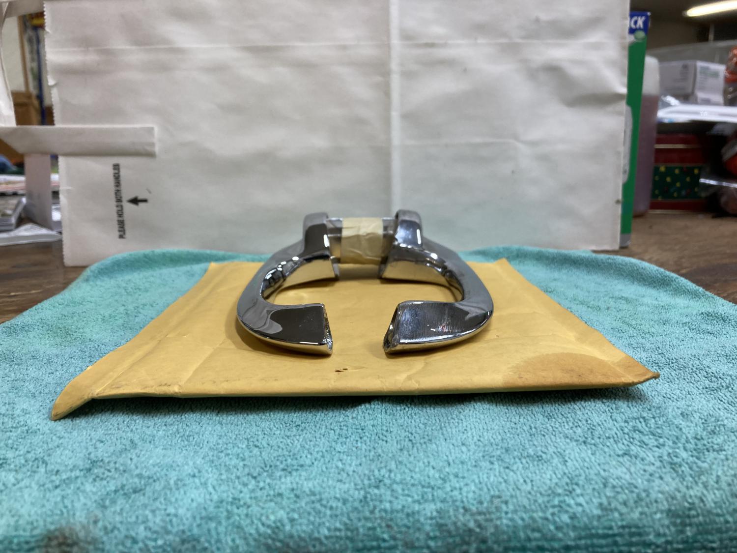

Donnie, take a shot of the thumb end to show the difference in angles. I have no 69's here or I would do it.

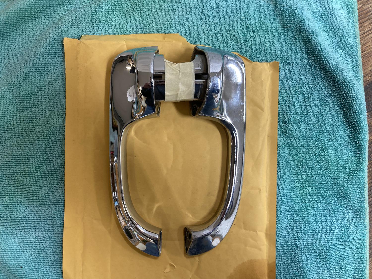

Ahhhh....I see what ya'll are talking about. The door handles are original re-chromed but not from this car and therefore I have no idea from what year.
The door handles I took off of this car were very badly pitted. Really not useable. I need a set of 69 door handles now!

70 on the left...69 on the right
