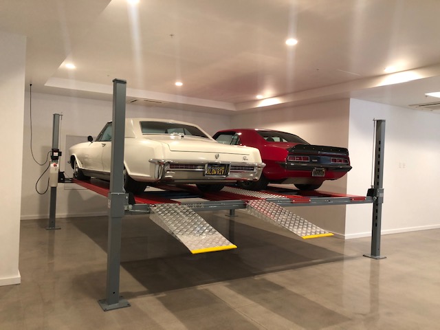

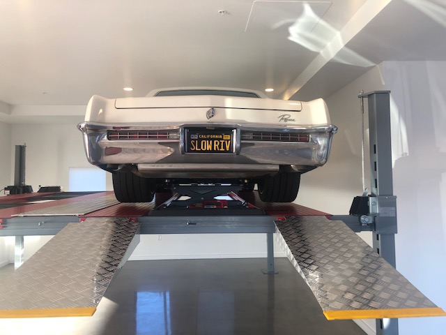

Final polish on floor. Just bare concrete.

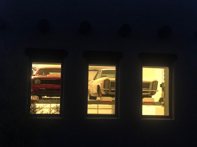

Nice eye-spy Mikey...as any gearhead knows alcohol fuels high performance machines...people are no exception. I'm working on the mood lighting, can u find the PBR in this pic?...LOL
