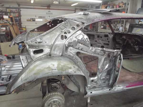

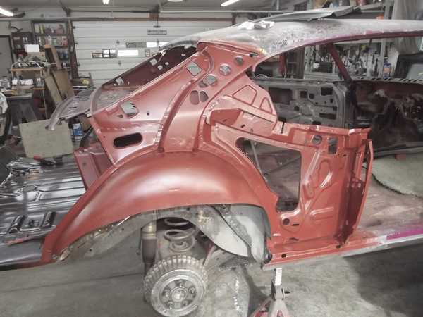

Quarters cut off and under structure cleaned to bare steel and etched, and epoxy primed.

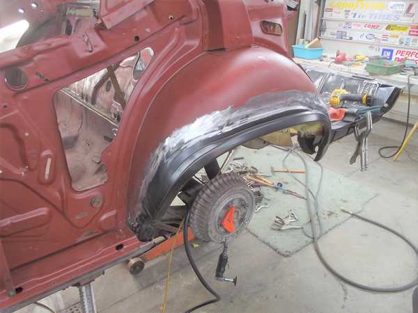

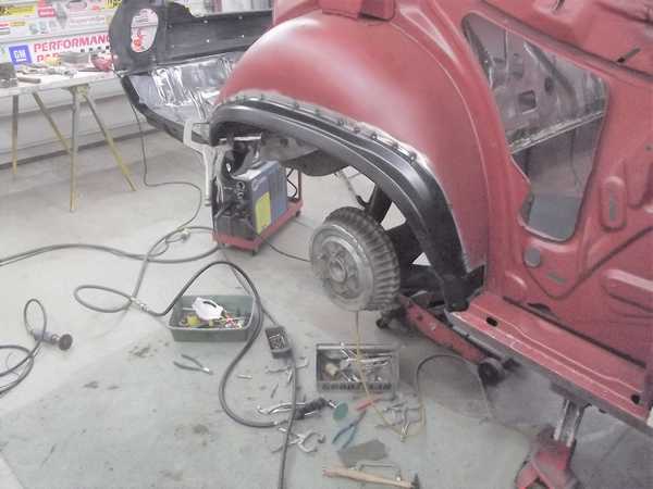

Outer wheel houses 90% original less the repairs to the outer lips using AMD metal. Quarters temporally mounted in place , tack welded in the lip repairs.

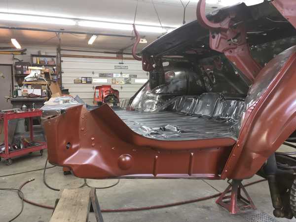

Also trunk drop offs in and primed.
