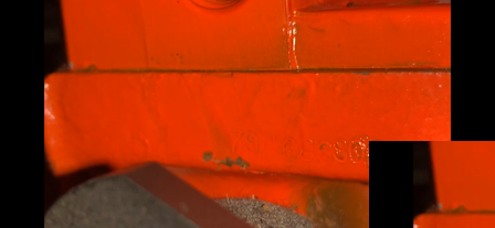

more

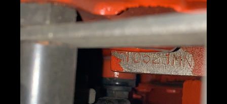

Wow, those stampings arent looking like they were done by the factory........
  #34
Old 10-24-2019, 08:17 PM
Location: Marine City, Mi.
Posts: 9,495
Thanks: 33,570
Thanked 4,653 Times in 1,971 Posts
----Glad someone mentioned this. Also, look at the broach marks. They are all over the place to my eye...….Bill S

Looks more like an engraving with a cutter than a stamping on the trans.

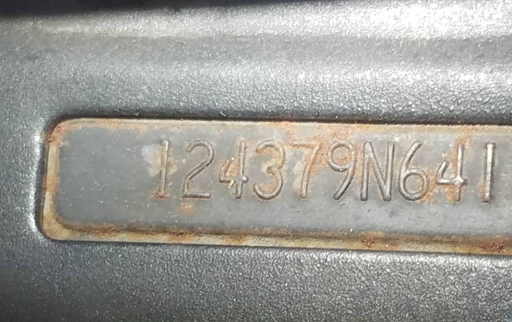

IMO, I don't think the car has it's original drivetrain.
Originally Posted by William View Post
The VIN tag was painted prior to installation using the same suede finish paint.
The VIN tag is noticeably smoother paint. It was painted by Chevrolet and I don't think they used the suede finish - this was the only part eligible, IIRC. This picture is a bit extreme in the contrast, but it was handy.....

  #38
Old 12-09-2019, 04:02 PM
William William is offline
Join Date: Jun 2001
Location: New Berlin WI USA
Posts: 2,688
Thanks: 262
Thanked 2,999 Times in 833 Posts
Nope.
One of my buds junked a Z11 way back and kept the title and tags. The backside of the tag is semi-gloss black; the top side is completely coated in suede. Definitely coated off the car. Also, have a blue tag from a very early Norwood car. Glossy black backside, blue suede topside. Van Nuys appears to have painted all of them black.
Have dozens of VIN tag photos that depict the same thing.
  #39
Old 12-10-2019, 07:03 AM
Kurt S Kurt S is offline
Location: Ann Arbor, MI
Posts: 3,126
Thanked 871 Times in 384 Posts
Interesting. I took pics of VINs at MCACN Vintage and those tags clearly were two different textures.
The tag I posted above has the original rivets, btw.
Kurt S - CRG
  #40
Old 12-10-2019, 01:56 PM
Join Date: Jun 2001
Posts: 2,688
Thanks: 262
Of course. Fisher painted the dash a day or two prior to the tag being processed by Chevrolet. Different process, paint mix, people. The tag was initially painted semi-gloss black; then the topside sprayed with suede dash paint.
You can't determine anything by looking at a tag installed in the dash.
