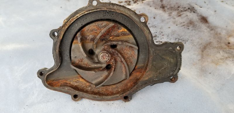

Default Moved to the engine bay.

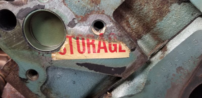

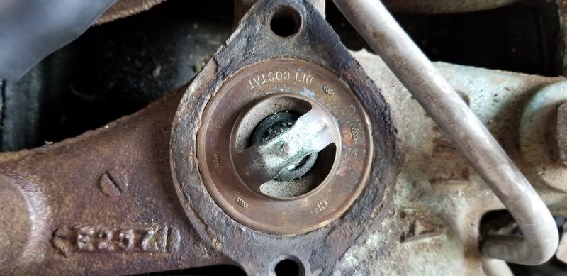

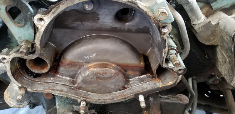

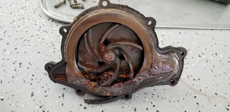

Day off today and its raining here, good time to post some more photos. Started in on the engine a week or so ago. It looked really nasty initially after removing the original water pump, but there must have been just enough coolant in the system that all of the crud came off easily and didn't damage the timing cover or pump. The divider plates are toast, but those are easily replaced. It looked to have the original thermostat in it that reads "Delcostat". As I expected, the original aluminum/nylon tooth cam timing gear was still in place, but the nylon was completely gone! I've heard over the years that many of these Pontiac nylon gears failed under 20K miles and were done under warranty, but somehow this one kept running and never jumped time. And check out this "storage" decal that I found on the passenger cylinder head behind the smog pump bracket, never seen one of these before.

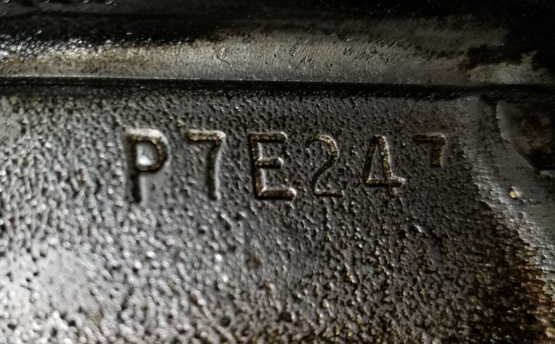

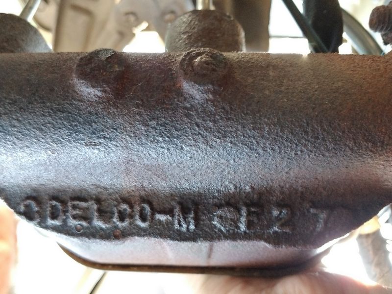

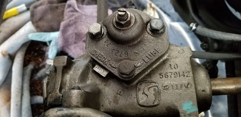

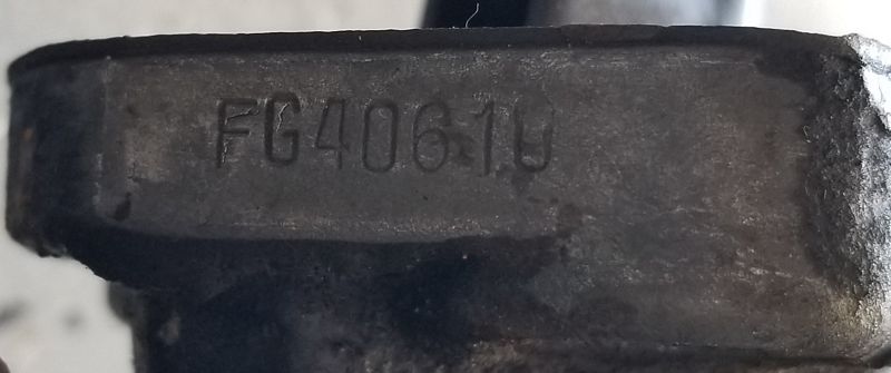

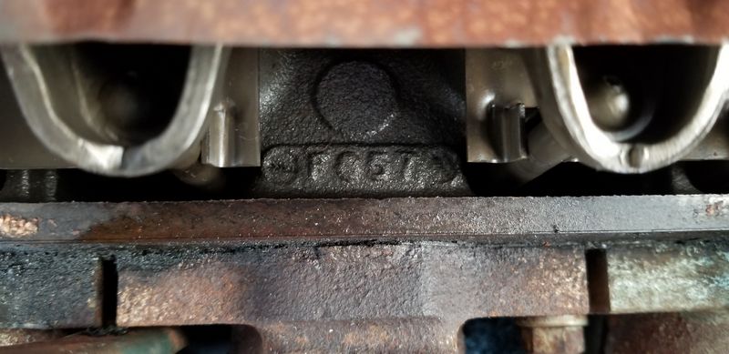

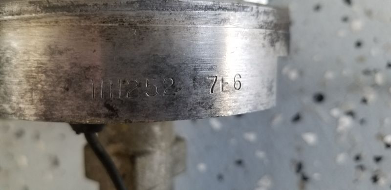

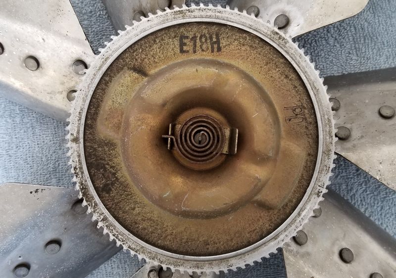

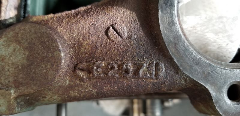

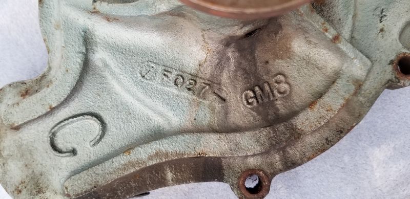

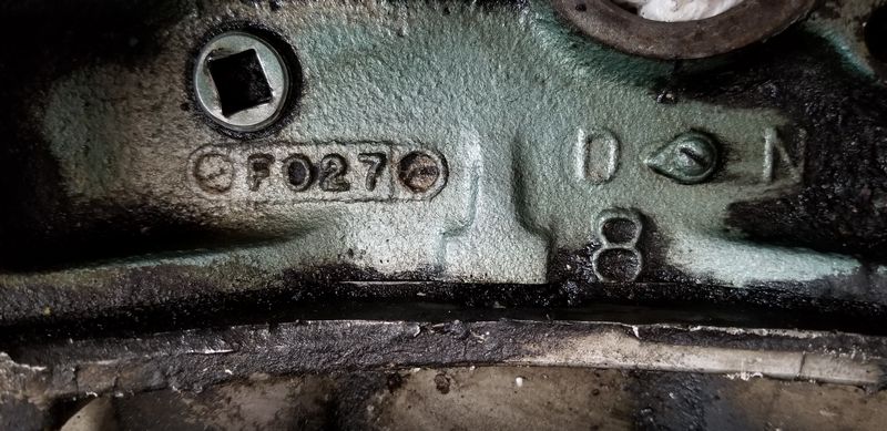

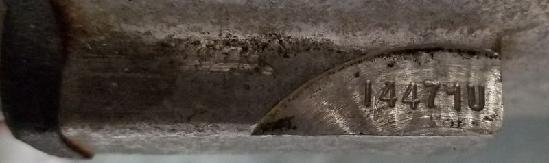

Default Some of the markings and date codes on various parts.
All of the dates are pretty tight on this car even being a late '67 build. Most everything is E or F dates and just a few weeks before the build date of 06D.

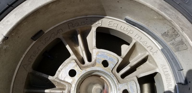

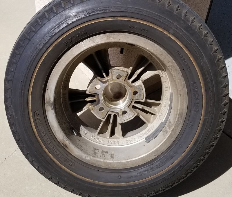

Default Removed one Torq-Thrust.
Took one wheel off to get photos of the back side. These old redline tires are from OK Tire, I remember those stores as a kid. They look to be reversable, white stripe on one side and red on the other... pretty cool!

I have never seen that storage sticker what do you figure that was all about?
