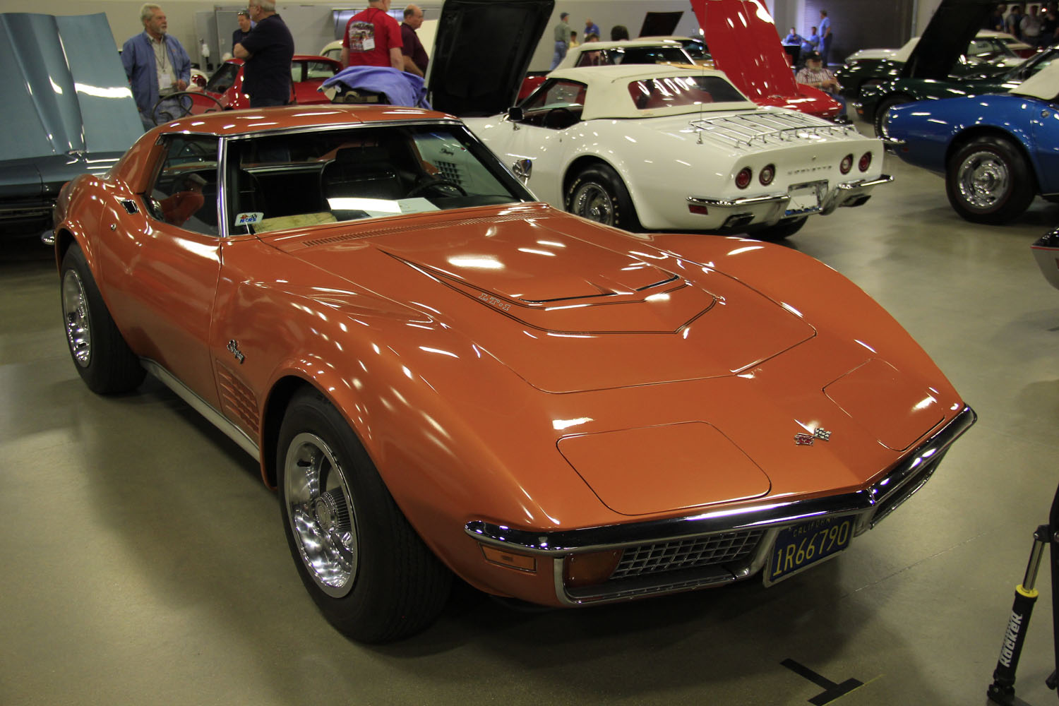

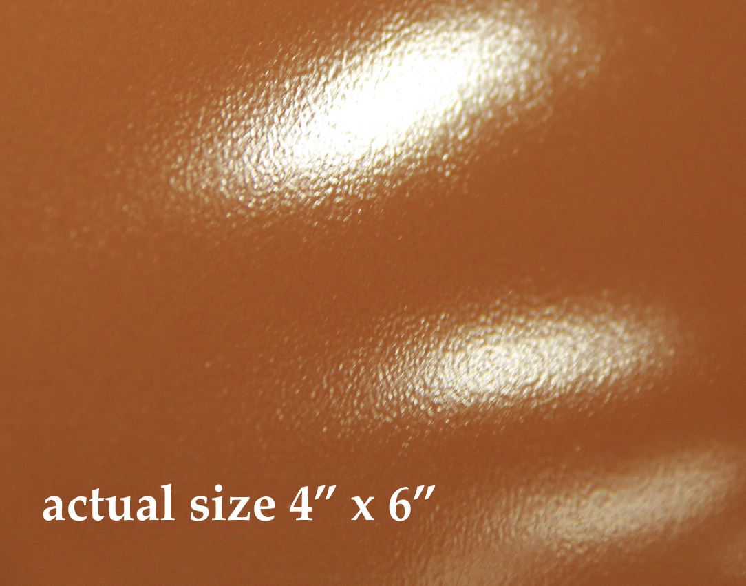

Here is a photo of a 72 ZR1 corvette which according to the NCRS C3 judges is painted as the factory painted them.
This car was shot with Ontario Orange Base then one mottled coat catalyzed clear with 40% flattener shot with the volume and fan wide open...
As an aside...
I recently shot a 71 Warbonnet LT1 Roadster for another NCRS member and I used a 15% flattener in the clear, which I also thinned 15% so as to get a finer texture, it top flighted and lost zero on the paint.
