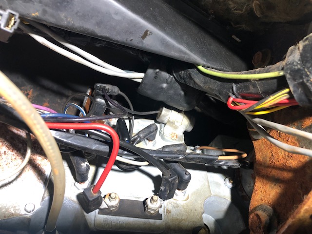

I would have said fusible link - but you checked that.
Does it crank if you jump the starter relay on the inner fender? Check all the connections there while you are at it.
Dave is right on checking the ammeter wire to see if there is any juice getting through the bulkhead connector. If not - there is a loose or cooked wire at the bulkhead connector.

Yes it cranks when I jump relay on fender, found power thru bulkhead connector , spotted some corrosion in connector but ran out of time and Advil.

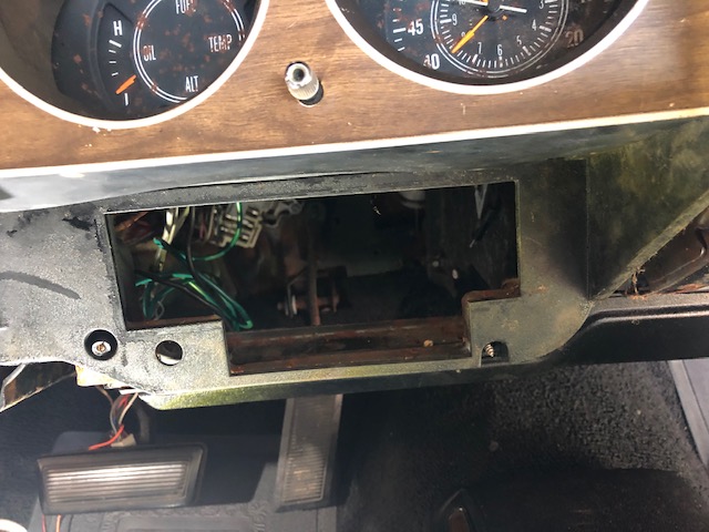

Originally Posted by A12pilot View Post
Charley, check that ammeter and see if it moves at all. All the power inside the dash does through that gauge. I've had a bad one and the symptoms sound identical.
Report back on that. How long was that car sitting?
Cheers
Dave
Bingo...pulled apart the bulkhead connectors and cleaned etc but nothing. Then pulled the aftermarket radio to get at the ammeter, put a jumper wire and bingo. Same thing happened with my old Toyota 2000GT. Took me forever to find it that time. The bigger issue is my "old man skin". It gets depressing when every time you bump or scrape against something you are bleeding. I used to do this stuff for a living and now I need a supply of bandaids and Advil.
