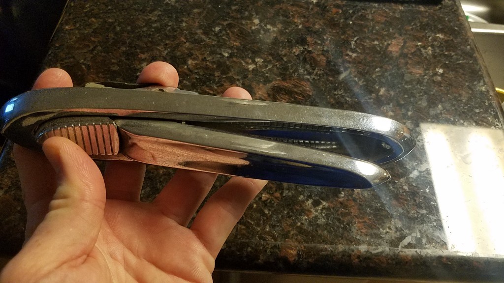

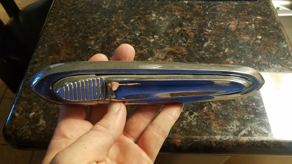

Door handles: the 507s were a very slim line design and while looking at them, thought they looked eerily familiar to me. Then it hit me! 1955 Chrysler 300C!
Once rechromed these are just about identical to the 507 in operation. No lock in the handle, but that's ok. There's ways around that! Man.... can't wait to start on this thing!

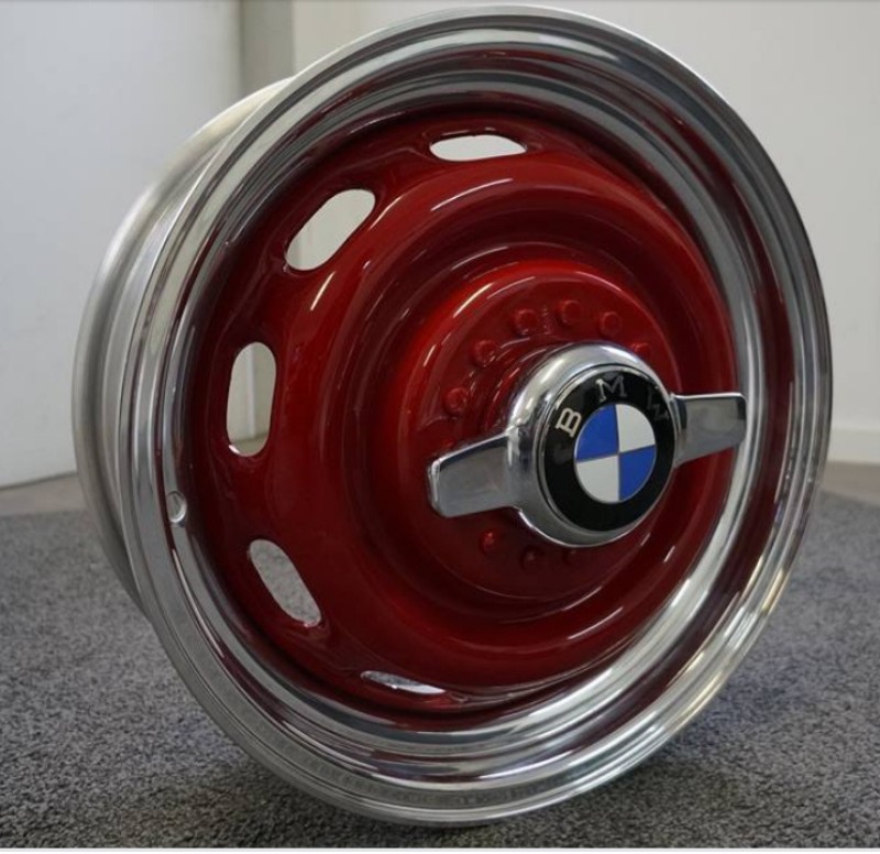

Tires are 6.0 x 16 which are pretty close to the old Chevy truck tires. The times are becoming a fun search. The last set of German Rudge wheels, restored, were sold for $16k a set. Along with that, you need the adapters for the axles. Well, homey don't be having no $16k for wheels laying around, so that's out. What I've found that's pretty close are spare tire rims from Fords and Chryslers. The rims are 16x4.5 usually. Will post up more as I zero in on a final selection.

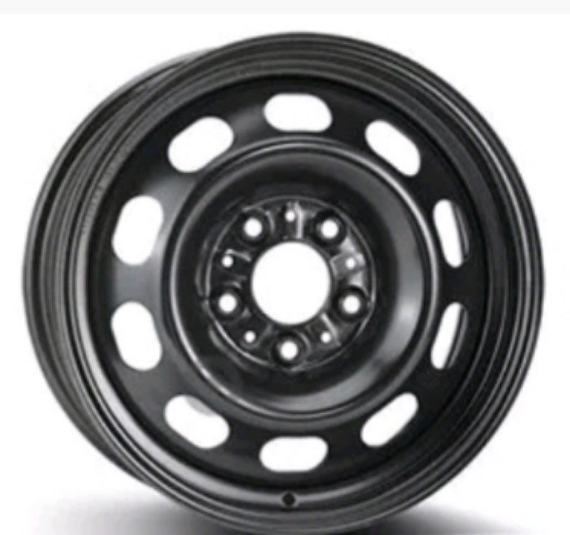

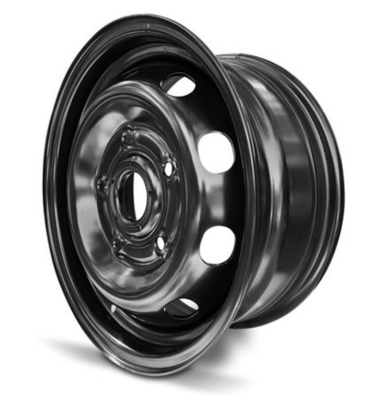

After an exhaustive 3 week, steel wheel, Googley search, I've come up with an almost perfect match for wheels for the 507. Rudge wheels were on the BMW as well as Porsches of the day. They are unique in that they are pin drive (read, knock-offs) and have a very unique center section. Size was 16x6. Yep... that's a big, skinny wheel!! Now, with real Rudge wheels climbing up past the $16k mark, and keeping with the design philos...philasof...fila....idea here of using extremely similar, easily found, parts to get the look in after, these 2015 Ford Transit wheels are a pretty good match! Way better than my last selections. The center section has the bulbous look of the originals and they are 10 hole as well. Although these are 16x6.5, I will send them to a shop and have them narrowed along with a standard 5x4.5" bolt pattern installed. A thin chrome trim ring on the outside and a simulated knock-off of my own design, or the dog dish caps I have, will complete the look!

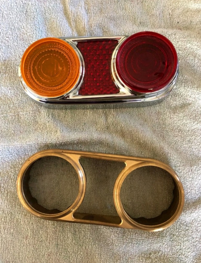

One would think with the house thread going and Anheuser Busch Clydesdale barn build well underway, along with 10 acres of fence, and two shops to stiiiiiiilllllll get to, that one might not have time to continue on with one's car builds. And, you'd be right.... until I get to the hotel on overnights and have nothing to do except search for parts and car stuff!
I was able to score some brand new tail lights in cast bronze form from 1976! These were made by the BMW 507 car club way back then after they couldn't find any parts for their cars. So, they started making their own! These are cast off originals and are about as NOS as you can get. I also have authentic lenses (red and amber) to go with them. Interestingly, only 507s destined for the US got the dual red lenses. European models got the red and amber.

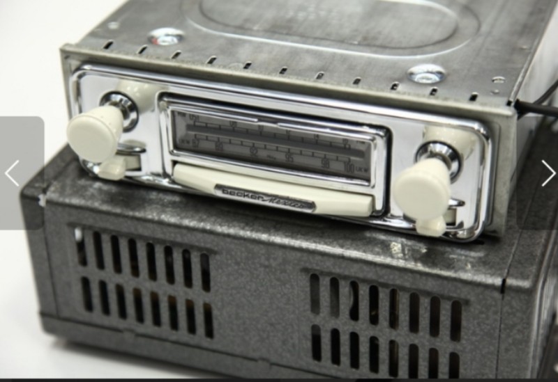

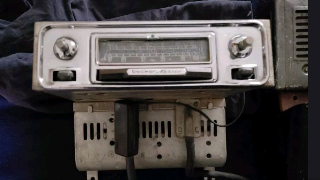

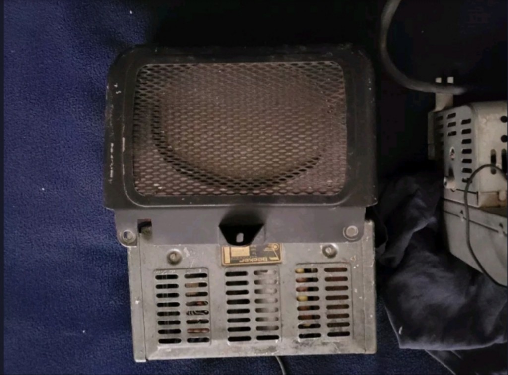

In other 507 news, I stumbled across an original Becker Mexico AM/FM radio with auto-seeker, along with its original amp and speaker! This will set the dash off perfectly! Pics of mine and a properly restored one.

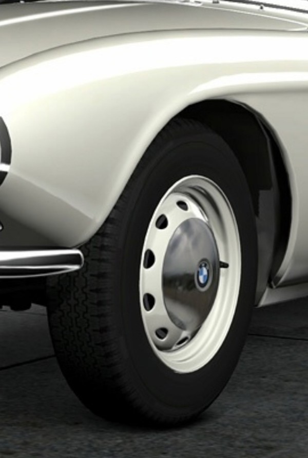

And finally, the wheel quest. Having searched more for the right wheels, I have a company that will make me a set when the time comes which mimic the steel wheel and hubcap look I'm after. But doing some more searching, found BMW steel wheels that are pretty darn close. I decided against the Rudge knockoffs, and am going with the stock steelies and dog dish caps which I already have. Pic attached of the stock wheel.
Next month is a trip to Sacramento to visit the body manufacturer and get that rolling. More to come as more parts come in!! Now, back to the barn build!

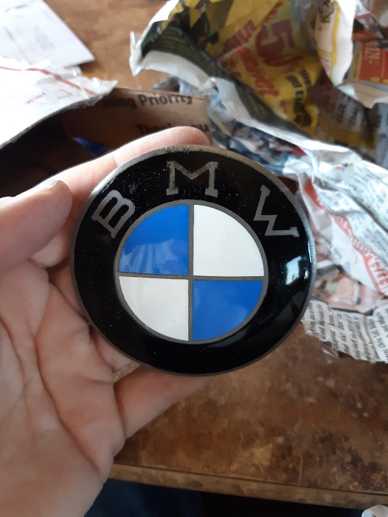

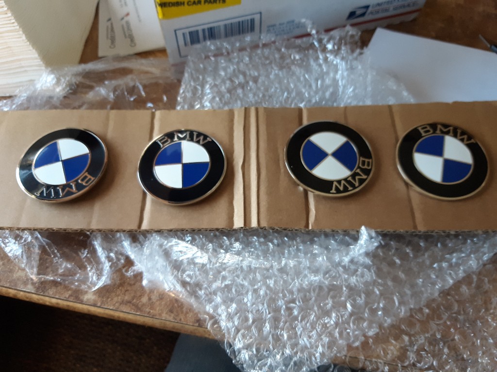

Continuing to score parts for the 507 project with these freshly restored roundels. They're impeccable and with everything BMW.... not cheap. If you never knew what BMW stood for, it's "Bring Money With"
The hood roundel is larger and is an unrestored original off a 503, which is what the 507 chassis was based off of. An often misconception of the BMW logo is that it's a spinning propeller. Not so! The issue started with an ad featuring the logo spinning in the place of a propeller in a 1929 ad. Further, an article in 1942 in a BMW journal used a similar image and the legend grew. It's actually a spin off (Get it? Spin off? Propeller? Yeah....i know) of the origins of BMW which was known as Rapp Motorenwerke. When BMW was branded, the logo was designed after the Rapp logo to rely on the brand recognition and featured the colors of the national flag: blue and white. Just so happens that those colors correspond to a spinning propeller through blue skys when placed in a circle.
There... all you needed to know about the Roundel but were afraid to ask! Next month I head out to get the body made and visit with the owner of the 507 that was found with Elvis' car (blue one) ...and was restored by BMW right along side of it.
