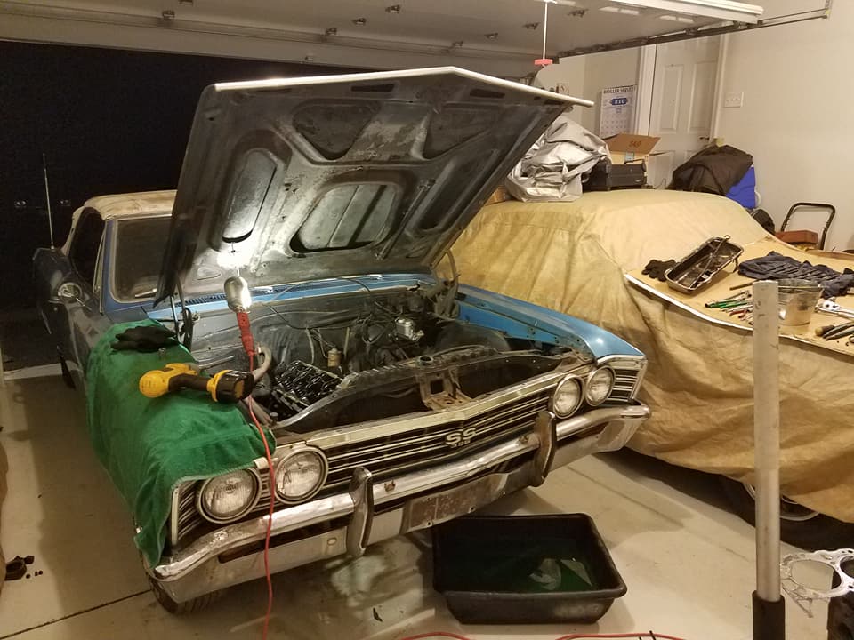

Quick update, got the car running but it had a dead miss which caused an explosion down stream and blew apart the rusty muffler in a massive explosion. I don't think that any mice survived that were living in that muffler. I pulled the driver's side valve cover and had 2 stuck open exhaust valves on #3 and #7 cylinders. Pulled the heads and they are now at the machine shop.

What is that under the cover that you are using for a work bench? That jack handle looks the same as mine; 3 ton low profile Harbor Freight.

Pulling BBC heads in-car is no fun task. How's your lower back? LOL

Shit.... Cherrypicker them bitches..

That would be the smart way, and what I'd probably do today. I just remember messing with these in my younger days, when I never stopped think of such things! LOL
They weren't fun.
