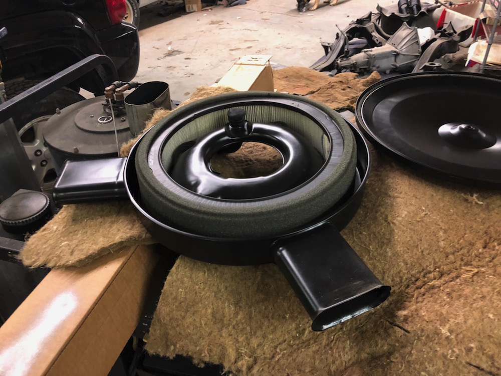

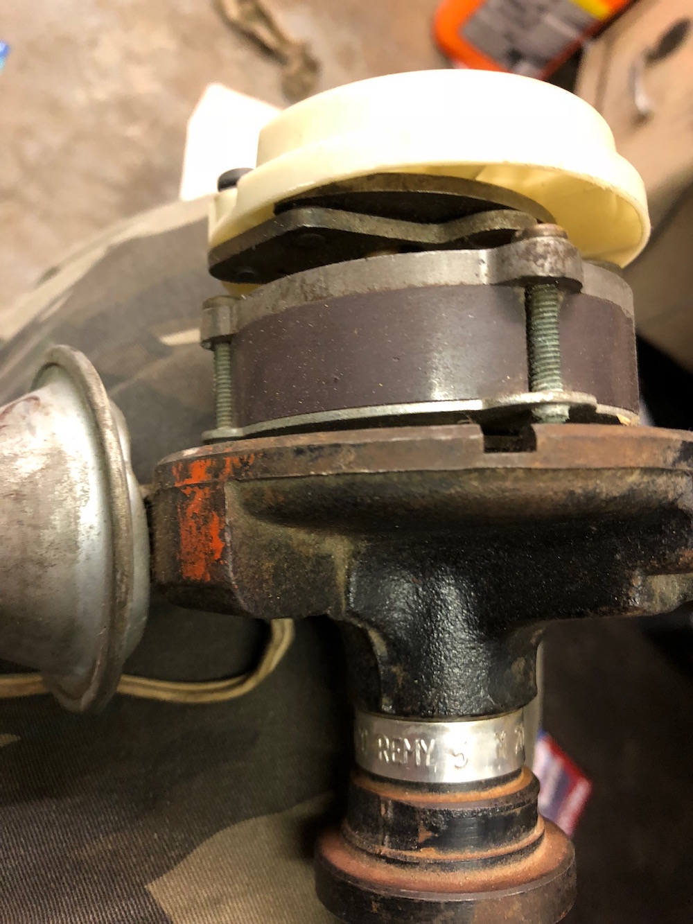

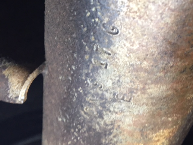

More pics

That's neat it's a 65 Muncie. Probably a leftover. If you get a chance, see if there is a metal part number tag attached by one of the sidecover bolts on the main case. Partial vin number should be on the top of the case, near the front.

Originally Posted by Tracker1 View Post
More pics
Very COOL! I sold an original air cleaner off a 1966 L-72 like this about 3 years ago for $750.00 and that I thought was a DEAL! . They are VERY hard to find.

Air cleaner looks good, correct snorkels, should have a flat bottom. Correct 696 alternator for a K66 (L Dec. date) equipped car. Interesting about the distributor. The part number 1111137 (M Dec. date) on the band points to a 396/325hp engine. It's possible a mix-up on the line happened?? He was looking for an idea on price. I was talking to a buddy who knows the '66 Chevy prices really well. He was saying around 40-45k. It'd be nice to see a picture of the stamping on the engine pad.
