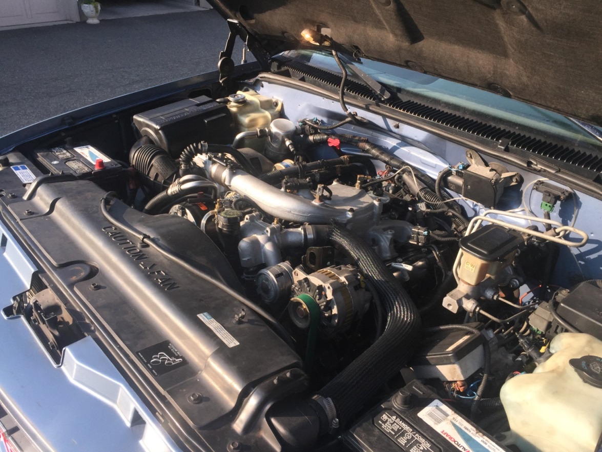

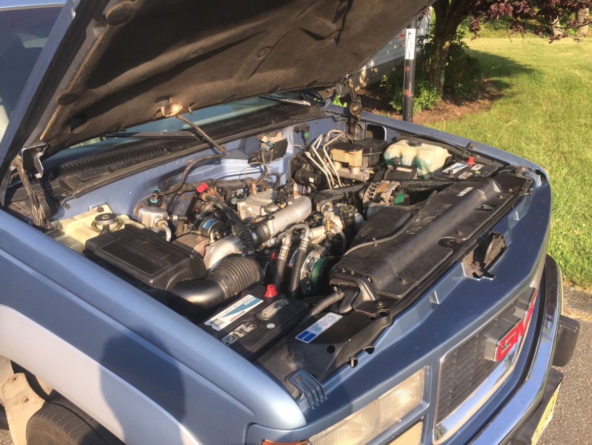

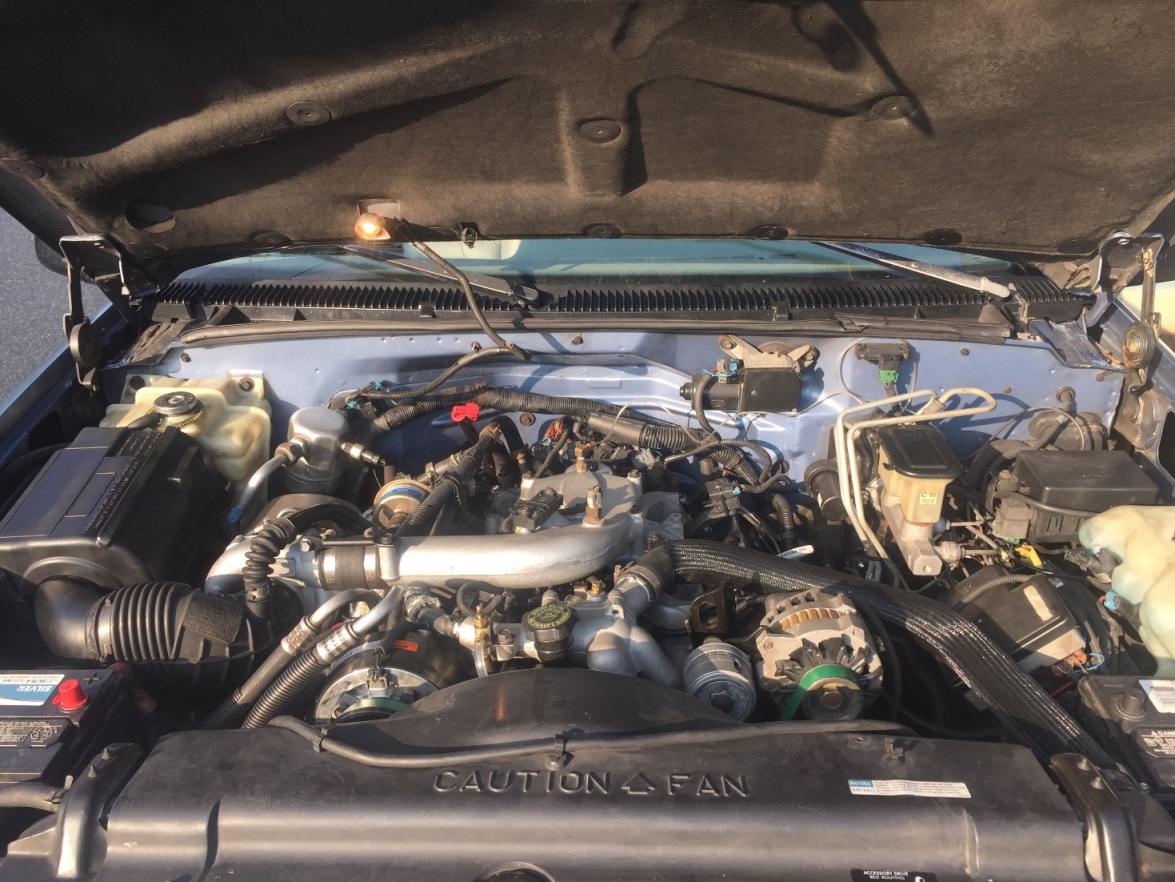

Thank you! This was quite the process. I have always been intimidated by modern stuff so this was something of a leap of faith, hoping it would work when the process was completed. and this engine is really heavy - I'd compare it to a fully dressed iron 426 Hemi in weight. And the fact that most mechanics have long forgotten how to work on and tune the 6.5 diesels - that was incentive to learn it all myself - combined with the unimaginable $$$$ cost of 9 days of labor doing the swap if I had a truck garage do it.
In the end, I don't know what I was so concerned about given that all the computerized stuff just runs itself once it is plugged back in. That was one of the reasons I tried to retain as much of the known running components on the new engine - old injection pump, injectors, wiring etc. I didn't want too many variables throwing a wrench in the process. I did end up replacing the Fuel separator/filter, starter, and radiator, with AC/Delco parts. I also replaced the engine mounts (the GM ones are no longer available) - though the diesel guys warned me that all the mount manufacturers superceded the mount part numbers to one unit that fits smallblocks, big blocks and the diesel - when the diesel had a special much heavier duty rubber used. As luck would have it I found one NOS GM diesel mount on ebay...one day after setting the motor back in the truck. So we will see how long the NAPA mounts last. AT least I have a spare in case one fails.
Now the truck is ready for cruising again!

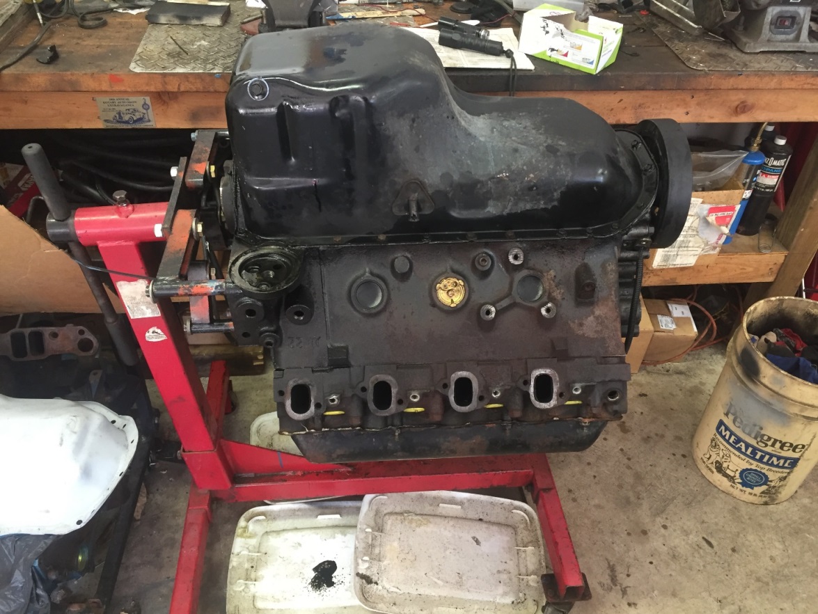

I was just out in the driveway on the creeper, checking the underside - still all dry - even the oil filter adapter!
I then spent two hours picking up all my tools and cleaning the garage.
I was able to get the old engine onto the engine stand and turned over so all the antifreeze could pour out all at once into the catch pans. I'll pull the oil pan in the next day or so to start inspecting it.
