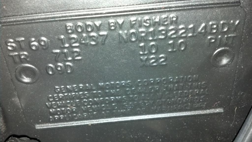

Bill: Can you get (and post) a clear pic of the trim tag?

And the tag:

Amazing, all the trouble they went through to fake this car, &quot;original (deceased) owner&quot; window sticker, trim tag and they FORGOT to put the D80 on the tag. I am guessing the spoiler option is shown on the build sheet. I haven't seen a copy of the build sheet. Spoilers are shown on the aged window sticker as well as the order:
