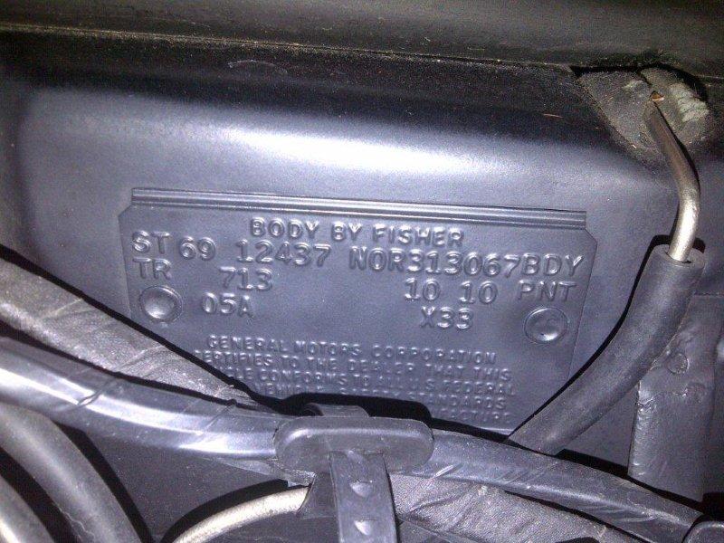

OK. I remember the car now. Yes, that is a fake tag.
One of the guys at team camaro took a better pic of it than the one on the ebay auction. You know, any time you see a "numbers" car with very clear pics of everything BUT the "numbers" it raises a serious red flag. Really, if you can take a clear pic of the straigh, shiny quarter panel, why not a clear pic of the tag?

To me it looks to perfect and both rivits, I looked up Trim Tags .com and looked at there 69 camaro norwood tags and they look identical.
I phoned the dealer because I was interested in the car, Say's sold for 79.500 gone to Florida

Hope the FL buyer knows it has a fake tag.
