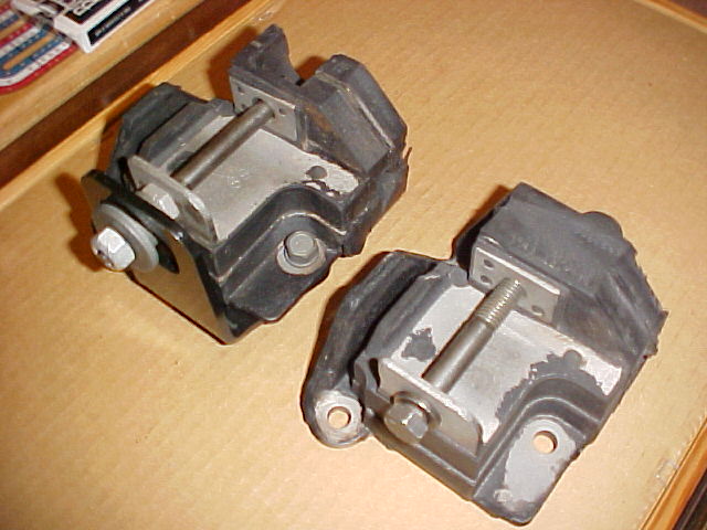

[QUOTE=NorCam;1500395]Still working away here. Installed the correct spacer for the driver's side motor mount stop bracket and finished up the rear cross member last night. Was it normal to have two stop lift change orders in a late car? This car has the stop lift cable as well as the stop lift bracket on the driver's side mount!
When GM had the safety recall for motor mounts around Dec/1971, the mounts were changed as well as the cables/brkts installed. The original stop lift bracket was usually removed with the old mounts. This problem was solved when GM went to the clam shell type mount.
Here are some originals for my own Z28 I’ve had for many years .
