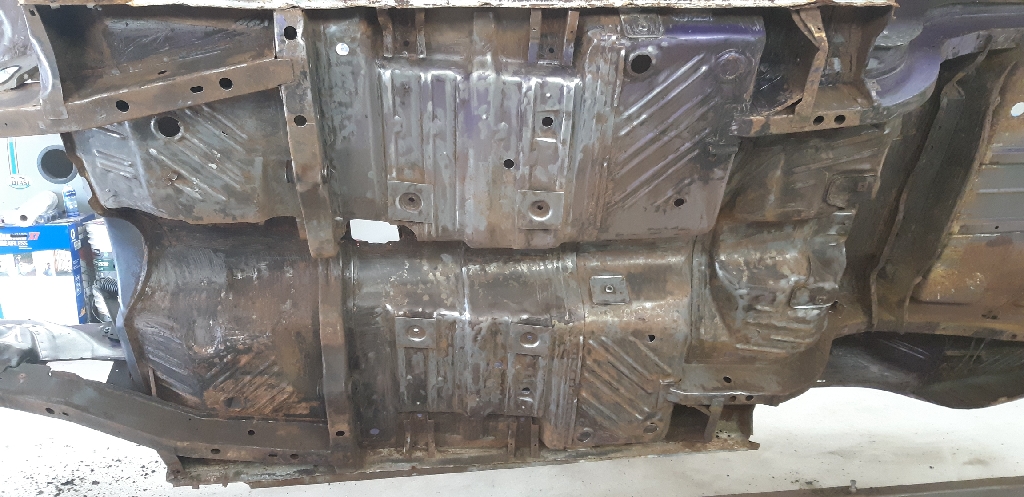

I just love that pristine, original purple under the undercoating! Let's see more.
Now you're just teasing us!

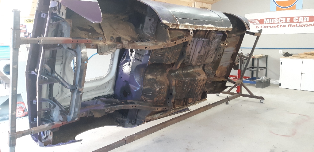

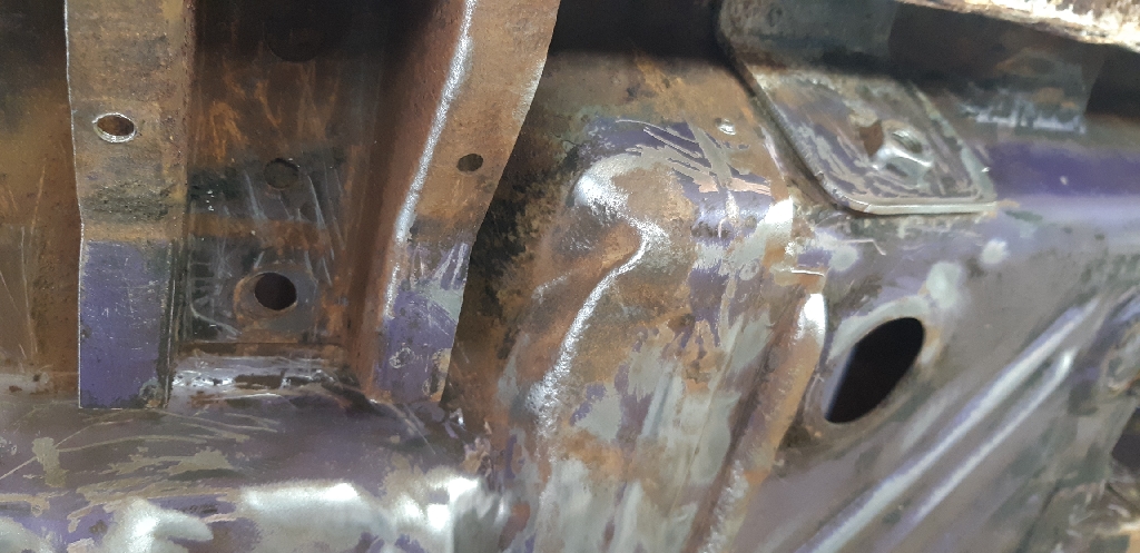

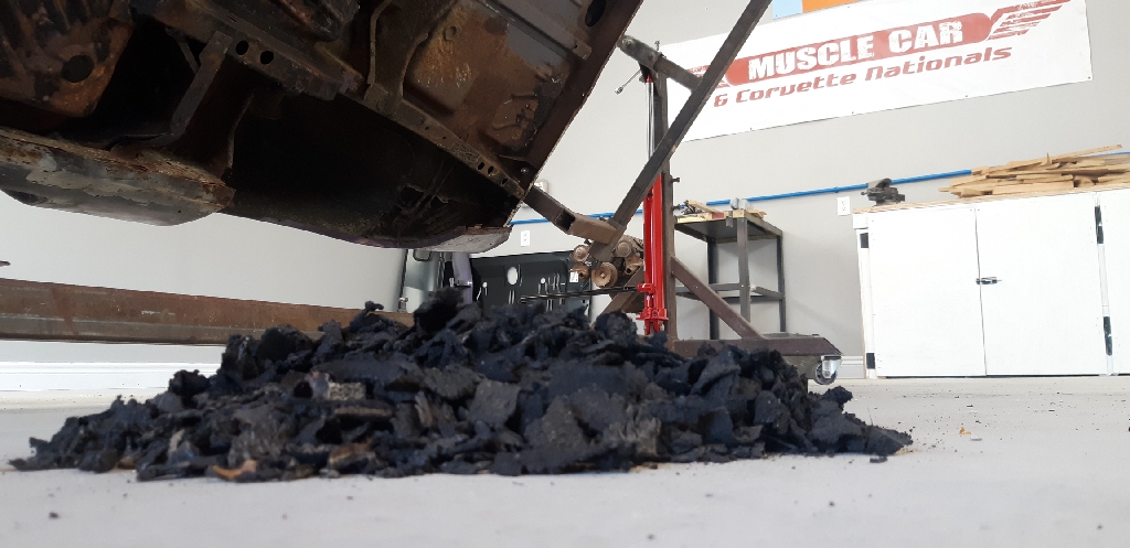

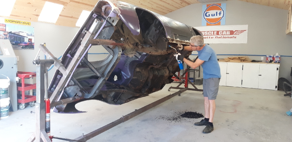

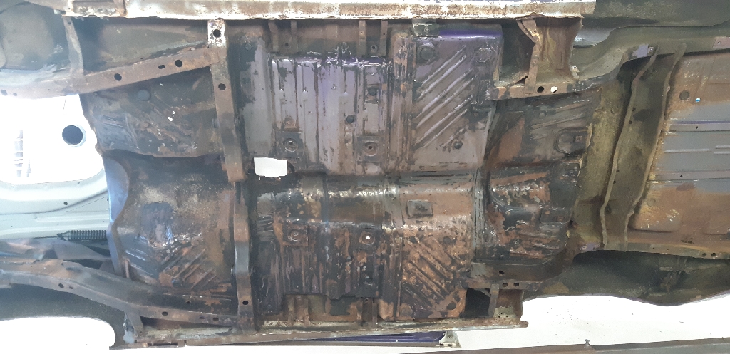

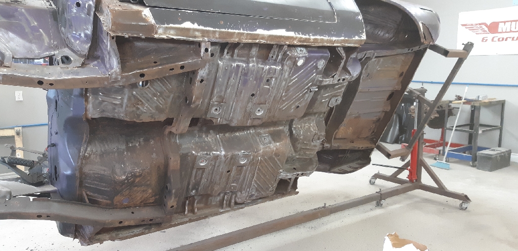

Oh course mid-stream into this I get summoned for a trip, but moving forward with the Undercoating Reduction Act passed in 1992, undercoating removal has started! A propane torch and a couple sturdy wood paint stirrers fo the trick along with various dental style picks to get in the grooves and such. I'll wipe this down with brake/parts cleaner (it melts this stuff! )out of the spray can and I'll be ready to hit the other side.
So interesting thing on these Mopars much like I documented on my Bee: the undercoating was the last thing sprayed on the car and as such, it got some overspray on the fuel lines, brake lines, gas tank, leaf springs, and heck, even wheel lip mouldings and rocker pinch welds if the guy got too happy with the Shutz gun! You can see the shadow of the the front to rear brake line on the driver's side rear frame rail.
I think this took off 4lbs of weight from the car which should lower Steve's times by at least .000001th. And due to the Undercoating Recycling Act passed in 1993 this will all be melted down and sprayed back in the wheel wells when done!

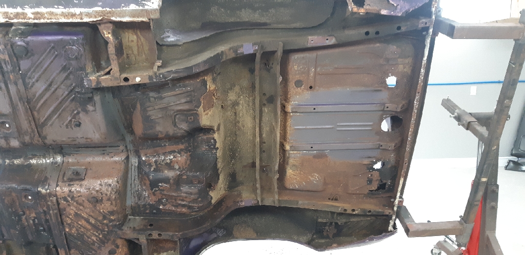

It looks solid, truck pan, any other metal needed?
Ryan W31

1) New full Goodmark trunk floor was acquired just to use a small, rear portion as donor patch panel material for the two holes where the rear muffler brackets go.
2) New AMD trunk lid since the original is tweeked upward in the middle. Probably from someone trying to pry it open at some point in the past five decades
3) New driver's side trunk dropoff and quarter bottom to repair small sections in the lower quarters and lower edge of driver's fender. Passenger side needs small repairs at bottom of quarter.
4) The cowl that Dave already expertly repaired with the use of the AMD donor panel sections. This kept the VIN stamping on top of the cowl intact and unaltered.
5) Some minor holes in the driver's side floor in need of patching - all that extra trunk floor material should come in handy for that.
I am also amazed at the condition of the underside given that this was an east coast car. I guess blowing up the original engine in 1978 was the best thing that ever happened to it!
I'm also learning how expensive the little hardware pieces are - correct bolt kits for valances, bumper bracket bolts, valance brackets, yada yada. Well at least they actually make this stuff now versus using hardware store bolts like back in the old days.
Next thing to order are the elastomeric bumpers, front and rear.

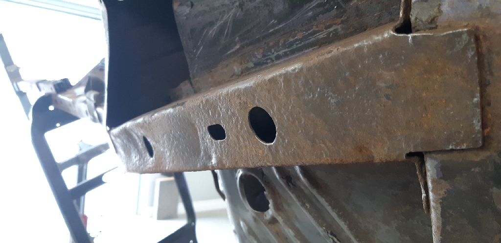

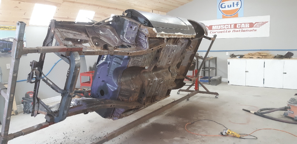

About 95% of the undercoating is off courtesy of propane and propane accessories, along with scrapers and picks!
The next phase is the wire wheel on the grinder followed by a chemical wipe down to dissolve the remainder of the nasty goop. In the crevasses, a spot blast gun with some good ole 60 grit slag to get into the nooks and crannies.
Should be 'rollin phat in epoxy shortly! Couple small areas I will have to break out the hammers on. A pushed in floor corner and the driver's front frame rail shows some pretty good jack damage. But fear not! It'll be fixed poste haste!

I am really curious to see you pull that dent out of the frame rail. I've tried some ideas from other websites on this type of repair and cant wait to see how you do it. Thanks, Brent

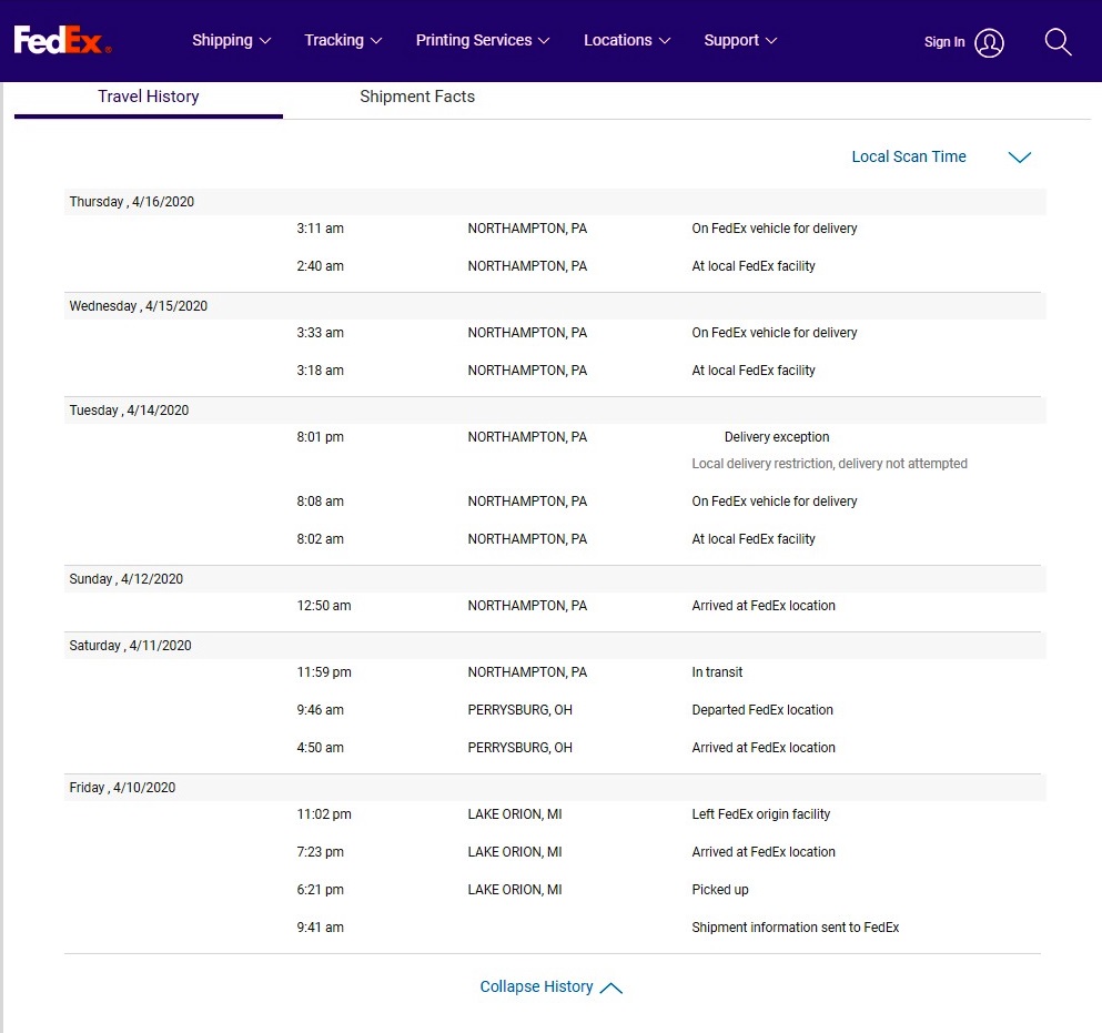

Looks like Fedex has lost my new 1970 Cuda Grill. I ordered it on 4/10/20 from Rockauto and it arrived at my local Fedex depot on 4/12/20. It has been loaded "on Fedex vehicle for delivery" for over six days now with no sign of movement. I have filed claims with Fedex, Rockauto, and my credit card company. We're talking $450 here.
And yes, of course I realize there are issues with the CootieVirus out there delaying shipments but this is a bit more involved I think. The last time something like this happened to me several years ago was when the package was so badly damaged, (forklift tire treads all over the box) they wouldn't even attempt delivering the remnants of it.
Rockauto says I have to wait two weeks from the time of the scheduled delivery before they will allow me to attempt to file for a refund. They won't issue a return on the missing grill while it is still missing. They have no humans in customer service you can speak with - only by email.
Fedex has actual humans and says they have issued a "trace" for the package at the local depot where it was last logged in. I have called them every day since 4/14/20 to talk to a new human (most of whom appear to be located in another country and don't have access to any internal tracking databases). They indicate that they cannot unilaterally issue a recall for the package and that the shipper (Rockauto) has to do it once the package is located. So, if I understand this, the missing package has to be un-missing before they can do anything about it???? The have no estimated delivery date now, though I have gotten a "delivery update" text every evening during the week, telling me my package will not be delivered tomorrow, and how I "can prepare for (non) delivery." I assume they mean, drinking heavily to deaden the pain of being without my precious grill.
Bank of America, when I initiated the dispute process, IMMEDIATELY issued me a full refund credit to my account! They will now contact Rockauto and hopefully this will get their robotic attention.
Here's a snippit of the latest tracking result. Keep in mind that today is 4/19/20 and the Fedex website has stopped updating the package since Thursday 4/16/20. Looks like they have given up on even trying to fake the location now.
