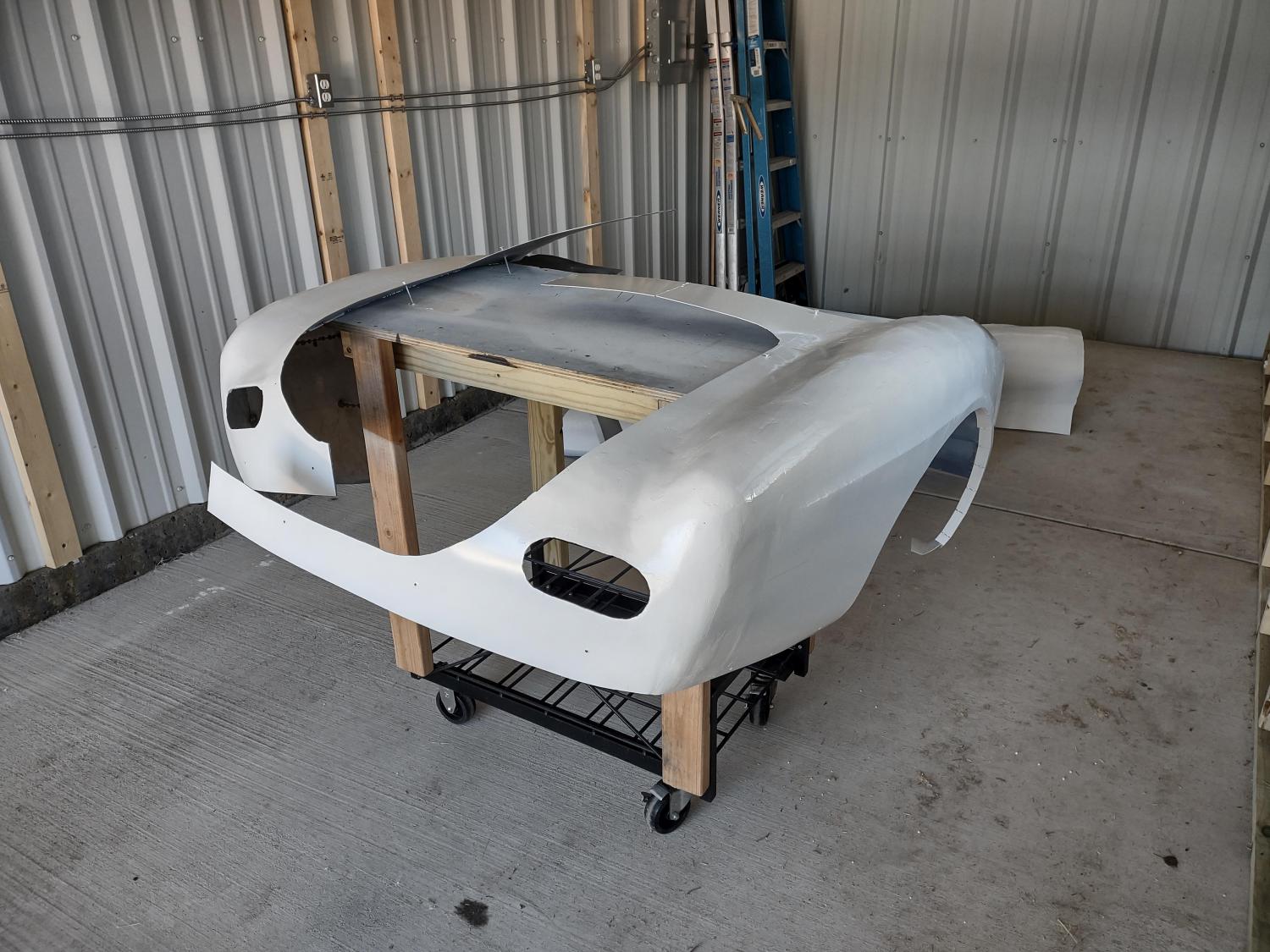

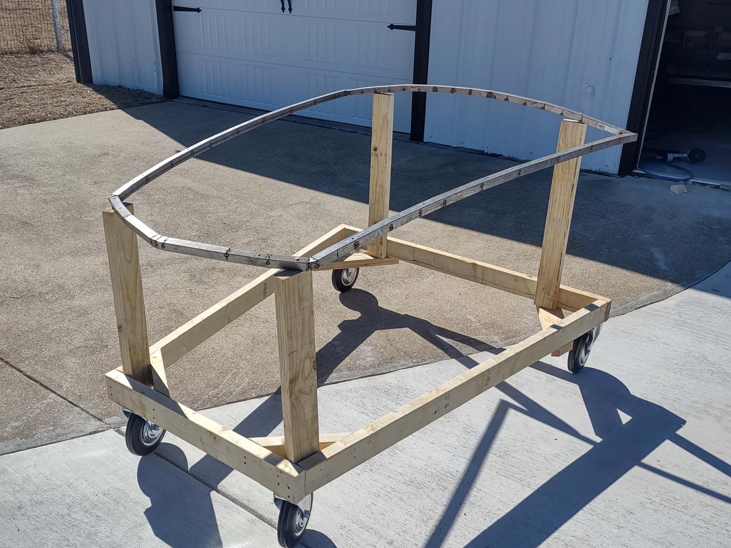

So moving onto the back end with fresh measurements from my visit. I was only about a half inch off on my initial tail panel layout with regards to taillight placement. I'd say that's pretty good seeing how all my measurements are based off a 1/18th scale model and a ruler. The thing is, these were all built by hand so no two are identical, but the placement of the tail lights is based off a buck so that distance is relatively similar among all the cars. Still, I wanted to make sure things up. The lights are tilted a little and follow a body relief line and also follow the contour of the panel. So lots of measurements before I start hammering panels.

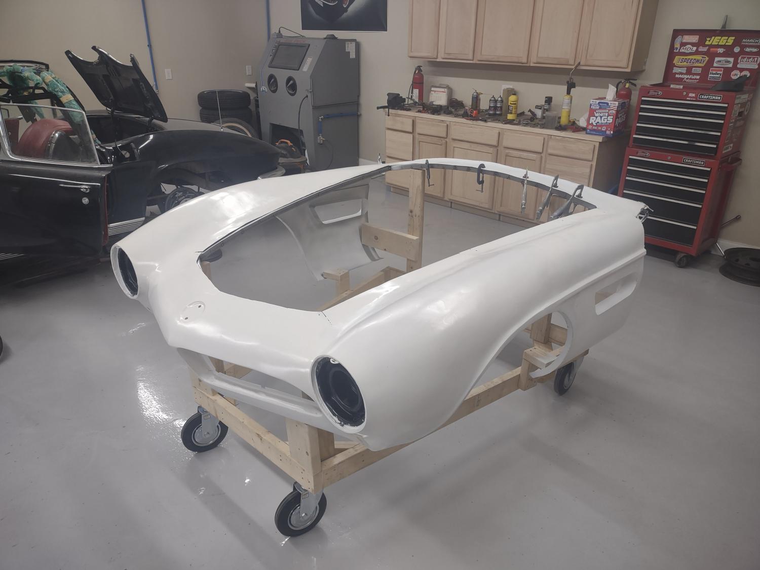

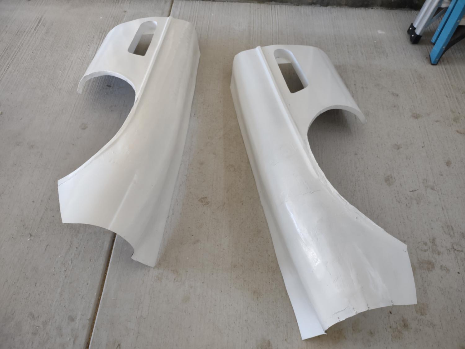

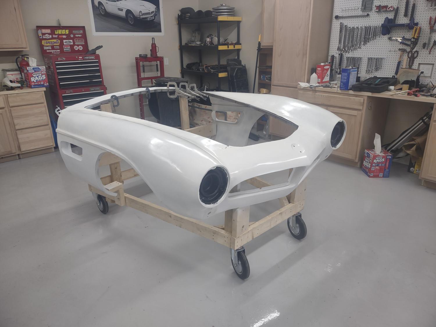

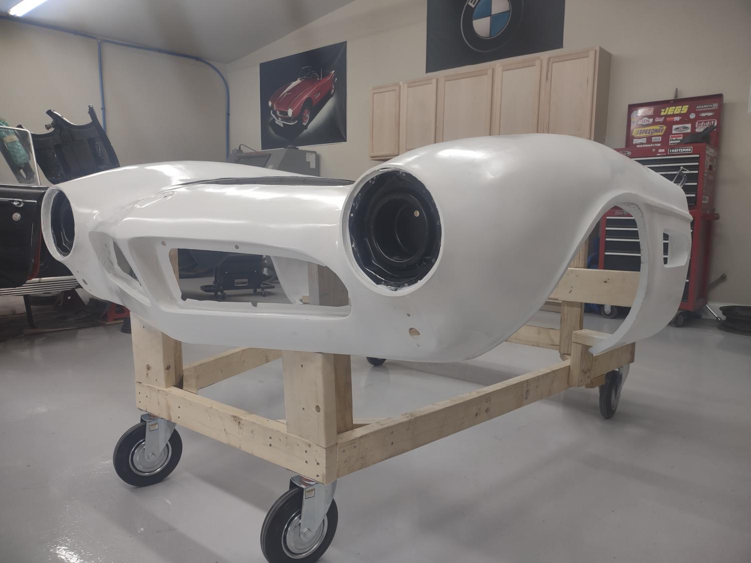

So last couple weeks I spent on the rear. More fun things on the front, but the rear isn't without it's charm! As you can see by the initial tape measurements, everything needed to be equal on both sides. I did this on the front but have to do it again once I connect the fenders to the fascia and cowl. Like my stock buying motto of buy high and sell low, I measure once and cut twice! I'm getting the hang of panel forming so I think the next body I make out of Aluminum will be way better. We'll see. I hope my buck stands up to the abuse. Oh and speaking of that, two crucial errors on my initial buck sculpture: trunk relief line and lower rear quarters/tail panel transition wasn't correct. But that's the advantage of visiting the real deal and getting measurements! Easy fixes and the buck is more accurate as a result.

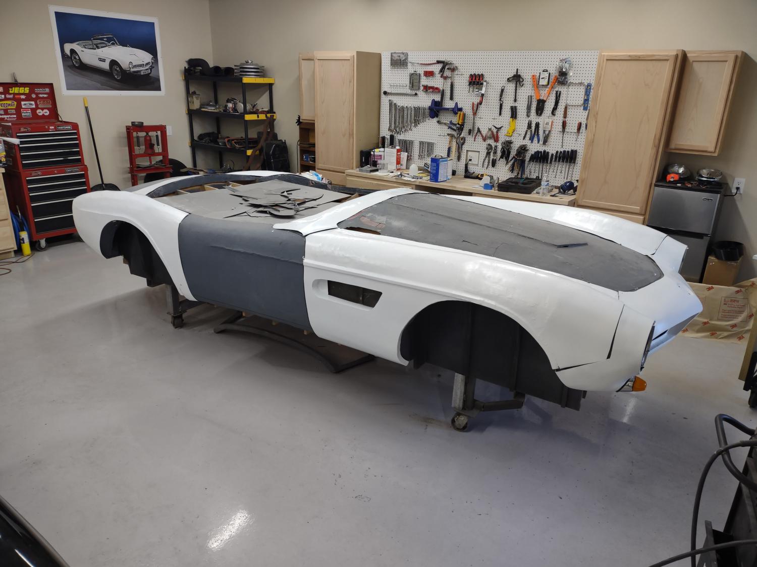

All the welds we're completed then ground smooth. I used USC's All Metal to seal up the welds. I use this mainly anywhere lead would have been originally used. Works great! Final body work to follow and one will note that the rear quarters aren't complete yet. No wheel lip or lower edge. If I did that I couldn't remove the entire section as it would be locked on the buck. That's why I didn't join the fenders to the fascia.

So right now, the only panels left are the cowl (just need to make a new one... That one on there was made by a third grader!), doors, hood and trunk. I want to wait until I mount the body on the frame before I start making those parts. The trunk and hood need frames and the door skins need an inner structure so I'll wait on those for now. Up next will be priming, then I'll start into the frame! Woohoo! Disaster is sure to entertain all!

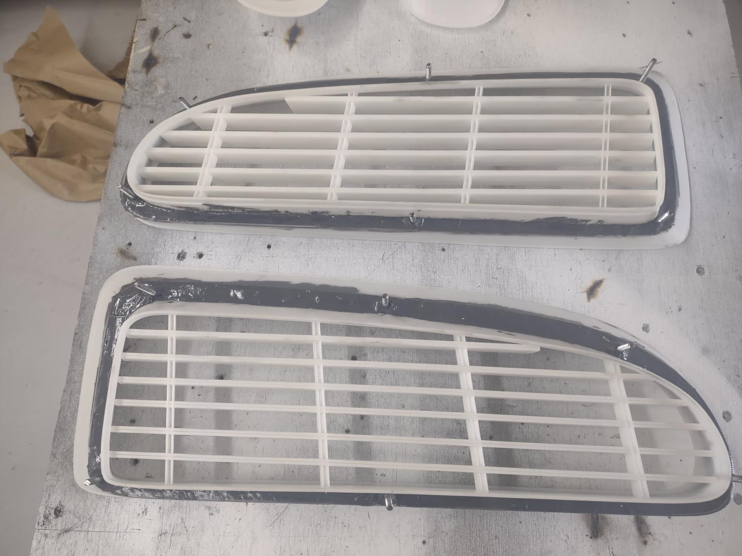

I printed a couple parts recently, one is posted in the previous post and that's the trunk bezel. The other is the dash gauge pod. The dash itself is a fiberglass replica molded of a real dash, now with the gauge pod, I've got the entire dash. The steering wheel is being printed as we speak!

Really impressed with the technology. Amazing stuff! Now, if I could just print another me!!
