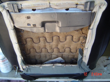

During the clean-up of the interior today I found this tag inside the driver side seat...BKH

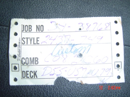

This is the trimmers information tag. It is loaded with the RPO codes for the car....BKH

The codes match the trim level of this car, and there is NO doubt it is for this car. I have pulled out Timmer tags form other cars and sometimes I have seen three or more inside the car, none of which match the car. CO8=Vinyl Top/ C60=Air Conditioning/D55=Console/U57=Stereo Tape System/and U69=AM/FM Radio..BKH

One thing that I found interesting is that the original plates issued to the car, match the last three numbers of the job number on the trim card..BKH
