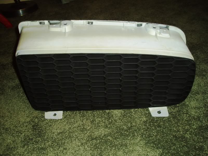

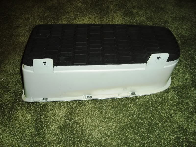

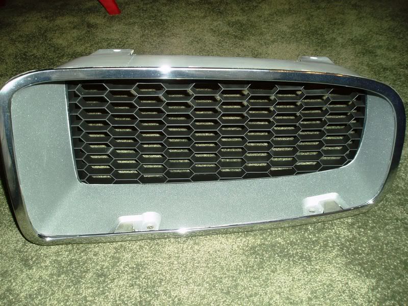

Here is the finished product. I ended up masking off the outside and painting the front and back of the blacked out grill section first. It took a lot of masking tape and newspaper. I sprayed it with flat black, let it dry and then masked off the black area and sprayed the inner part of the grill face with the OEM Paints Pontiac Honeycomb Wheel paint. As long as you follow directions, it sprays out nice and dry and leaves a nice consistant sparkly, argent finish. Once that dried I reattached the outer molding and retaining clips and I was (half) done. The other grill is still soaking at the moment and I will be finishing that one in the next couple days.
