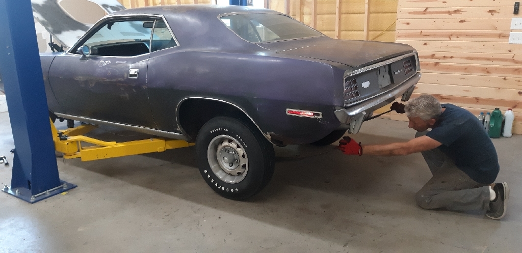

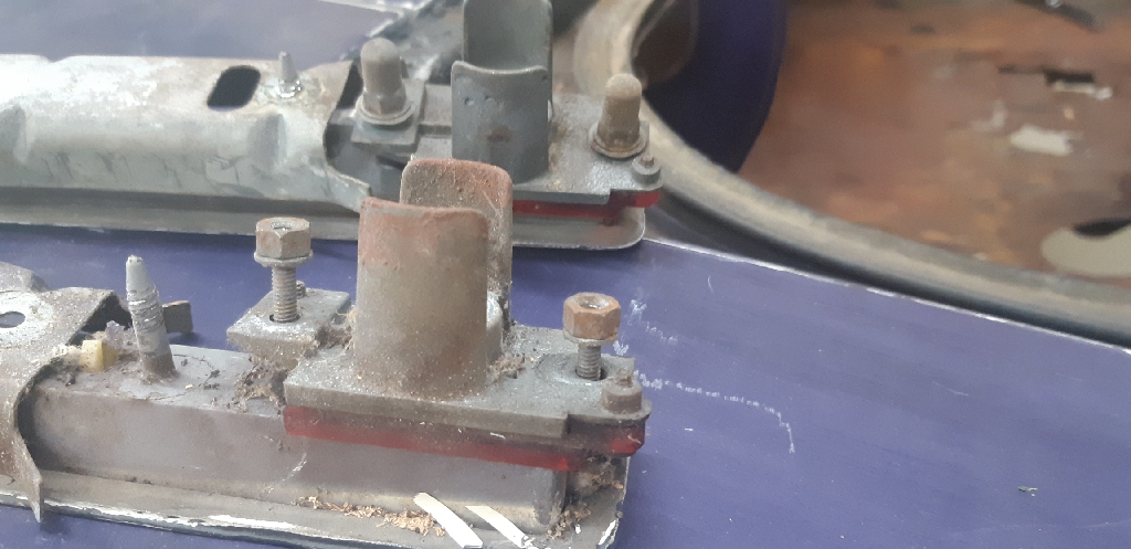

![]() Moving forward, just about ready to mount the car on the rotisserie and jam-on-it on over to the small shop for undercoating removal. Several small "assembly line oddities". Rear marker lights have different fasteners from left and right. They should be the capped nuts but the drivers side were star washer nuts. You can tell they're original by the clean threads from where the nuts were removed. This goes along with the rear seat back lower retaining screw (self taping bolt) used to hold the dash that was installed right next to the machine threaded nut where the correct bolt goes. ![]() Rear glass to go, and yes, gills too along with a few small things. Everything is getting boxed up and labeled too! More to come..... Cheers ![]() Dave Last edited by A12pilot; 04-11-2020 at 01:27 AM. |

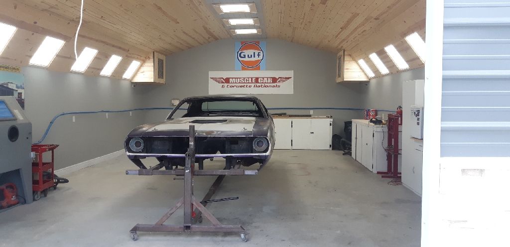

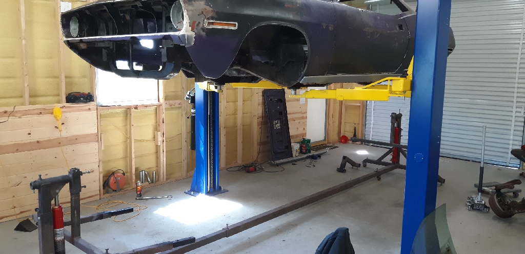

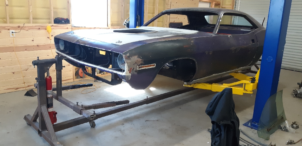

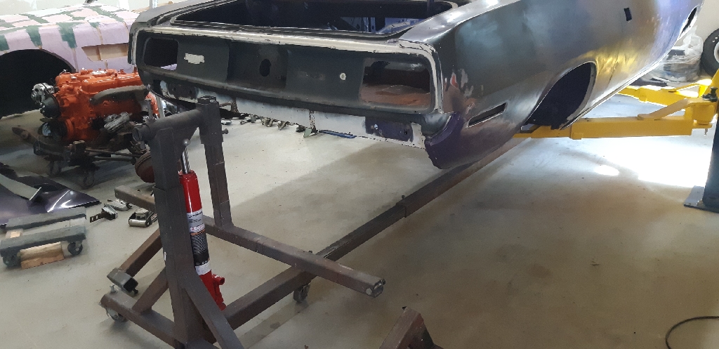

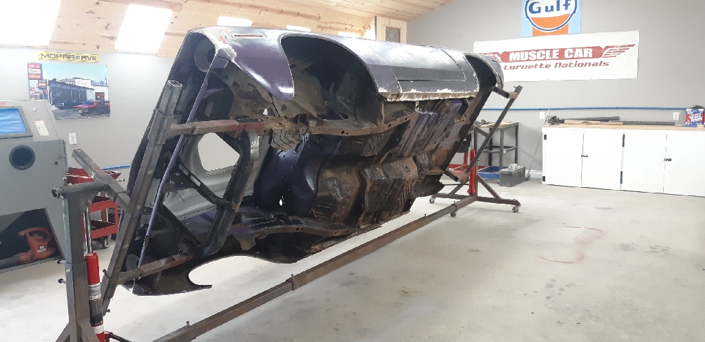

As promised and on schedule, it’s on the rotisserie this weekend! Yes, here at DM Restorations, Fabrications, Custom Creations and Coachwerks (

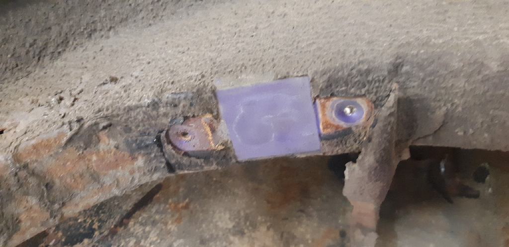

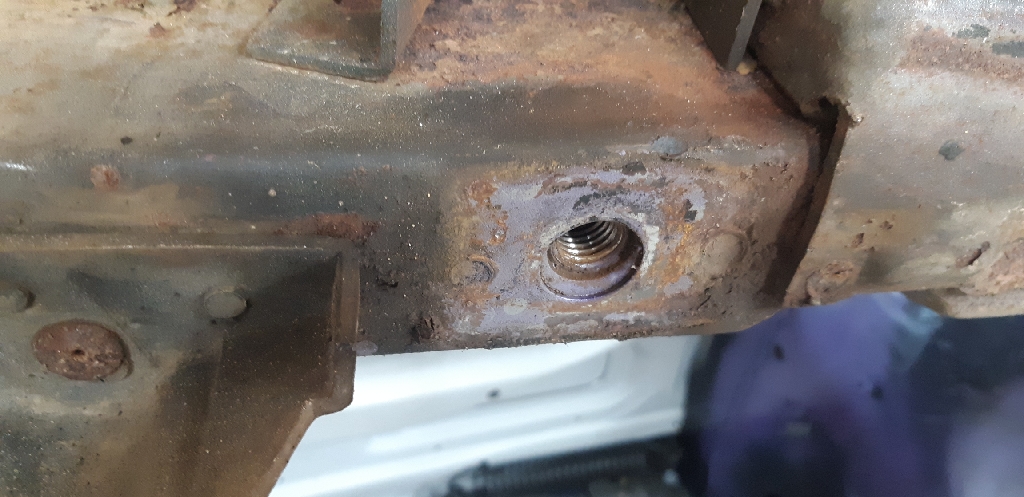

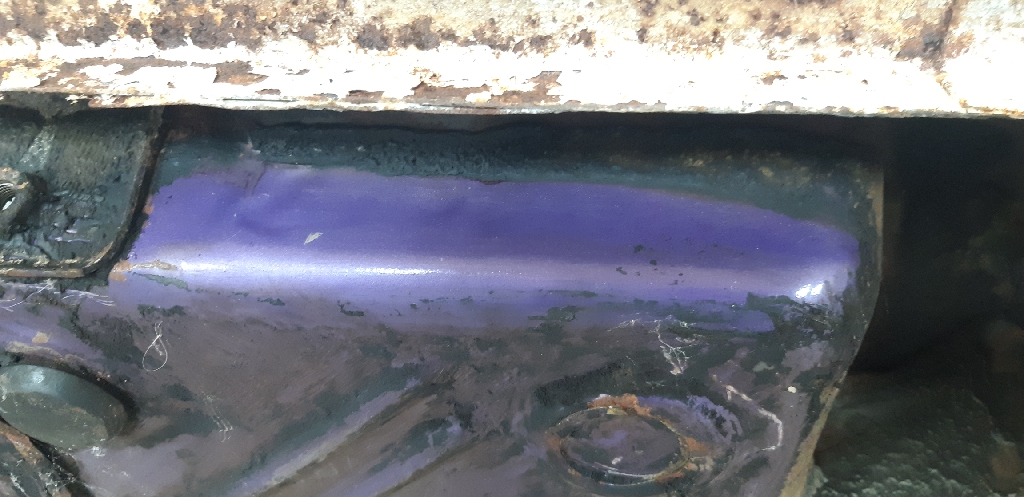

![]() ![]() ![]() Now comes undercoating removal with the fabled torch and scraper. Seeing other details that my other Mopars had gives me the clues to start the game plan on paint. The underside of the frame rails on this car, much like my Bee, is a light dusting on paint versus the heavier application on the outer floor pans and wheel wells. You can see the light purple on the front bolt hole for the bumper mount and the rear axle bumper stop. Yet, looking at the floor pan you can really see the heavy overspray. The last three Chargers I did were different since two 68s were from the St. Louis plant and one 69 was from the Hamtramck plant. St. Louis cars had the entire frame rails on the front painted and the Hamtramck plant had one underside painted and the other basically primer. ![]() More this week! And yes Freddie, I try and make each day as productive as I can. I mean, Steve ain’t paying me to sit around. Actually, Steve’s not paying me at all ![]() ![]() ![]() Cheers ![]() Dave Last edited by A12pilot; 04-12-2020 at 10:38 AM. |
