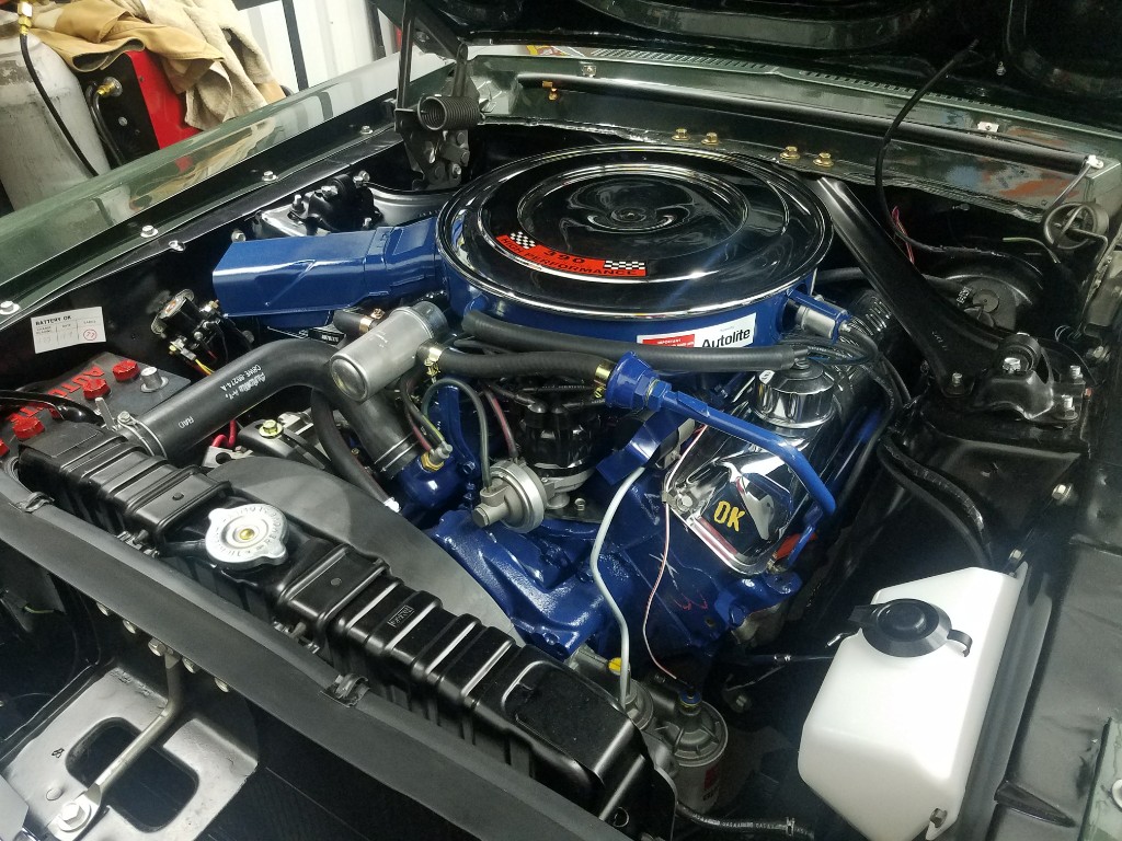

I think the only thing that trumps the circumference of the 390 chrome air cleaner lid is the Chrome Dome from the mid 60s Hemis! Soooooooo much chrooooome!

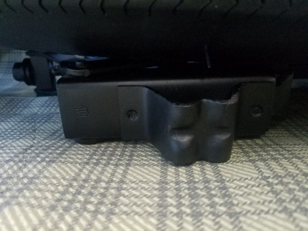

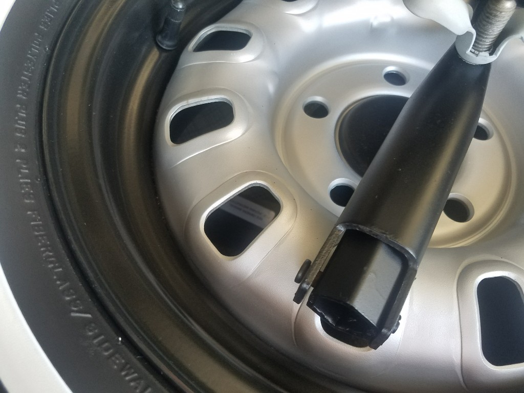

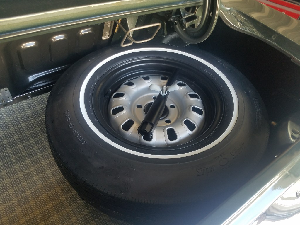

I was fortunate that the car had the original jack and hardware hidden in the trunk. Trying to stay 100% correct, the F70 WSW Firestone mounted up on a stock 14x6 styled steel wheel trims the trunk out nicely. My car has the Reflective Group which is a reflective "C" stripe on the side of the car and the center part of the wheels painted in a reflective coating. Like a stop sign has. The spare, however, is not painted with the coating. My original spare didn't have that in it. Just Argent paint. Tomorrow the glass goes in!

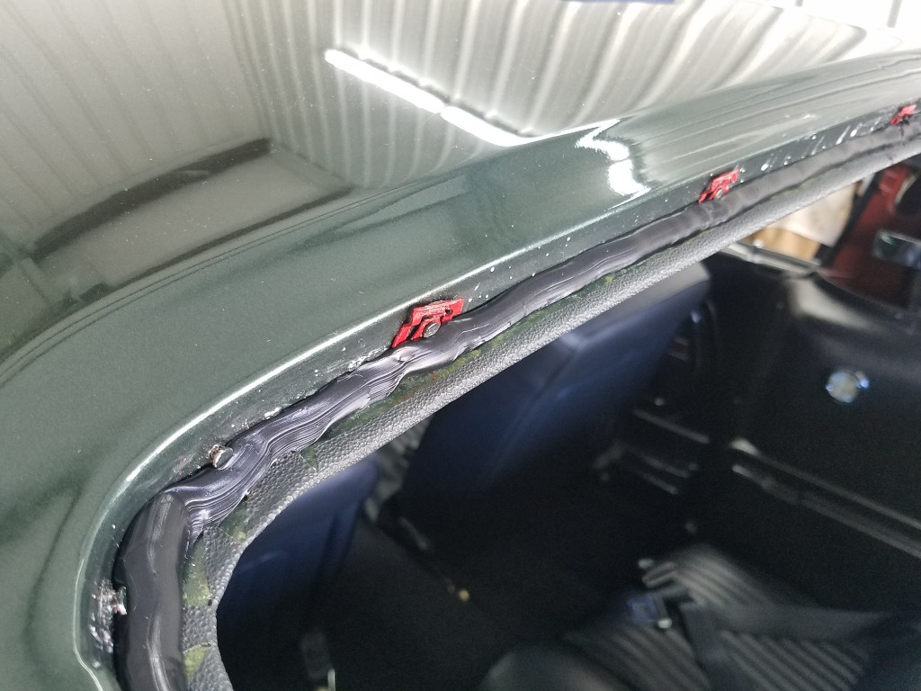

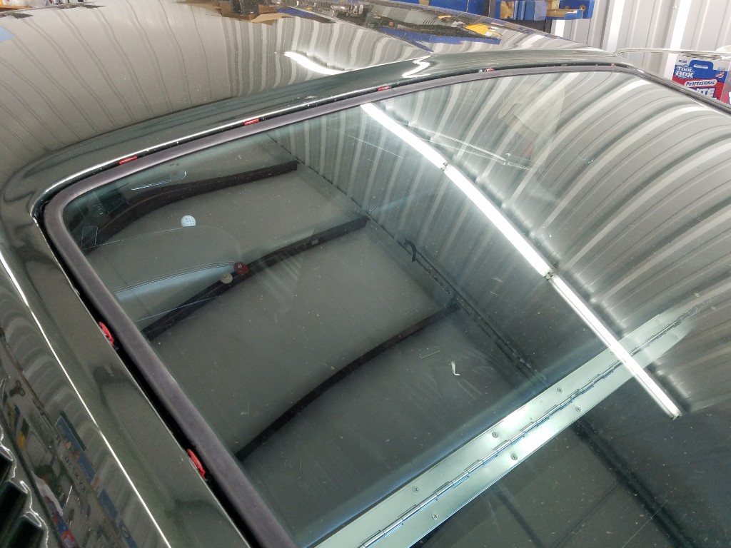

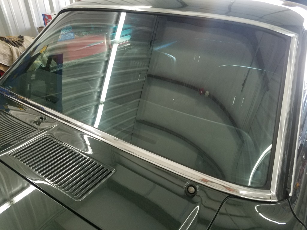

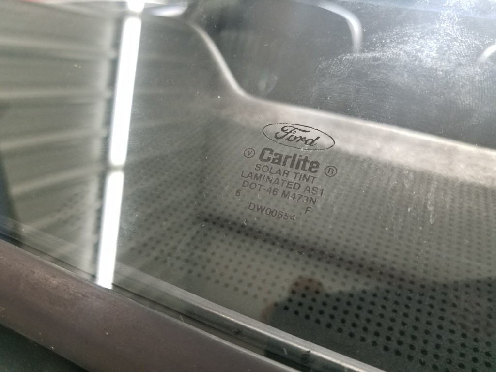

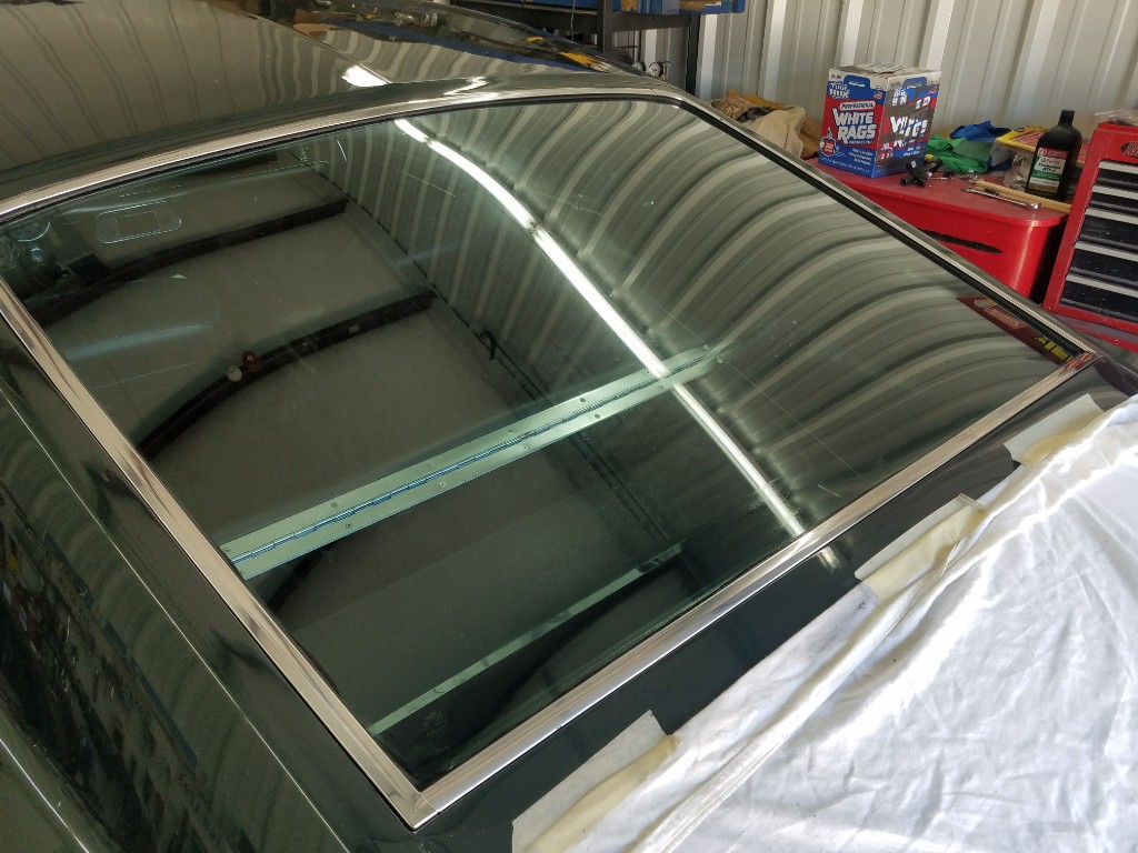

Glass went in without a hiccup! And luckily, I didn't ding any of the stainless fresh back from the polisher either!

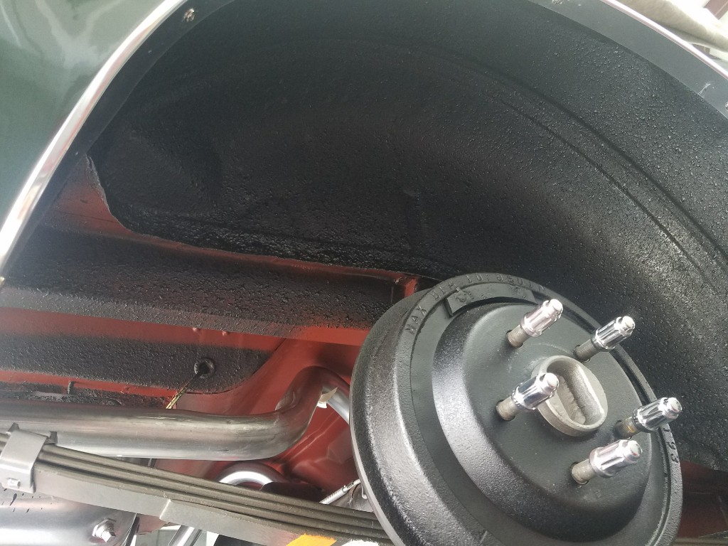

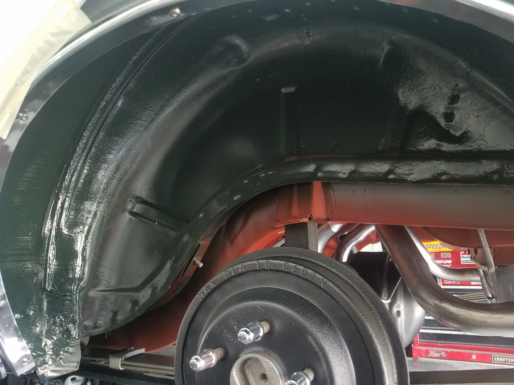

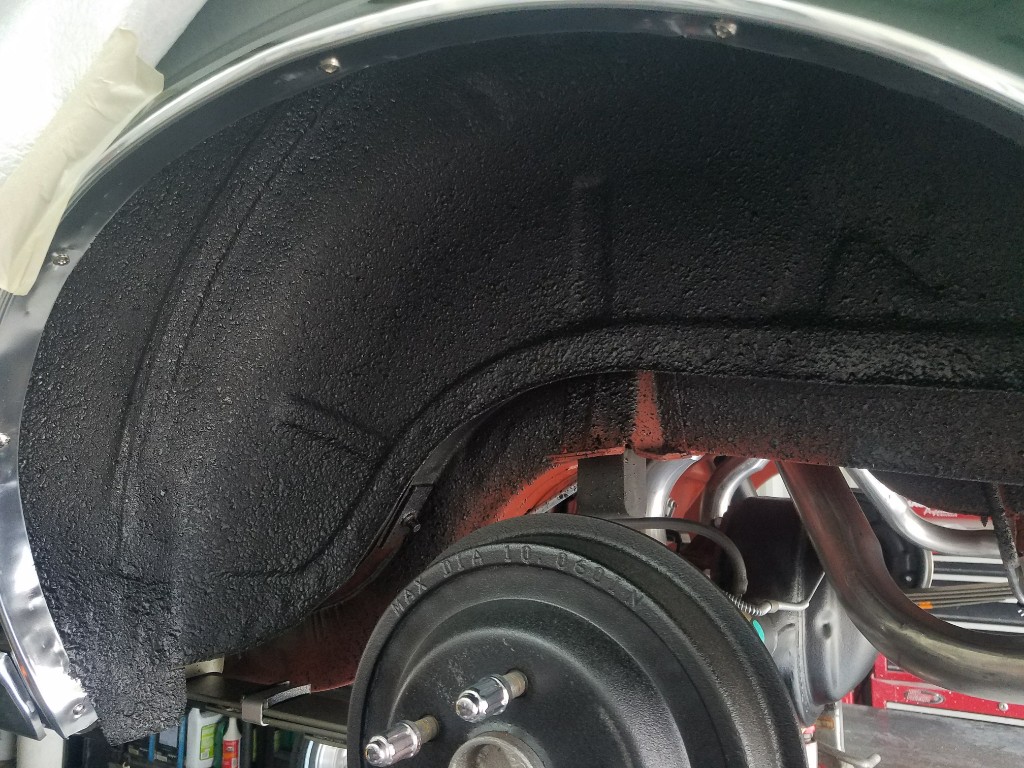

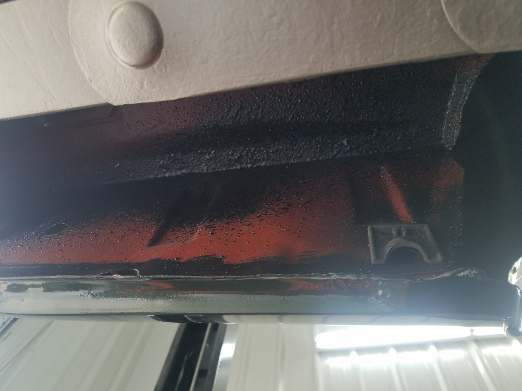

Undercoating time, and you know what that means! It's just about done! Mustangs had sound deadener sprayed in the wheel wells and interior quarter panel, and then they were painted. The wheel wells in the back, therefore, are body color. The front wheel wells were not painted since body color stopped at the firewall so that remained black. When the dealer got a hold of it, the salesguys got involved and said "You know, for an extra $2.50, we can throw that undercoating stuff on the chassis which will make everything look cool, cause our mechanics to curse and scream when they have to work on anything under the car, and 50 years from now, will make some dude really unhappy when they try to restore this car to Concours Gold.... whatever that is? "
With the dealer undercoating, the rear wells got it and so did everything else like the floor pans, gastank, and all the lines and such. Some only got wheel wells and that's the look I went for. Love this stuff and its textured and ready to spray through a Shutz gun. I got it from RestoRick. Awesome stuff! More to come
