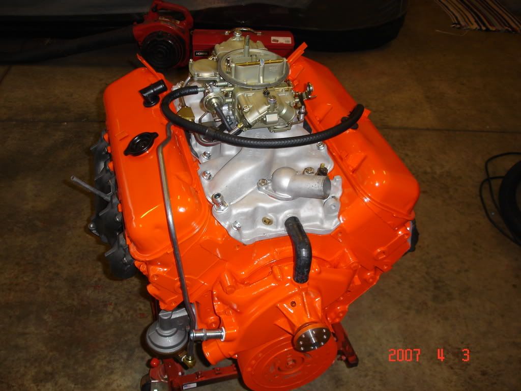

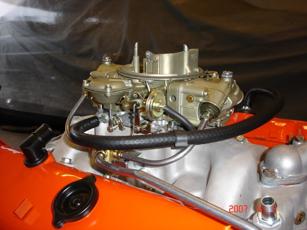

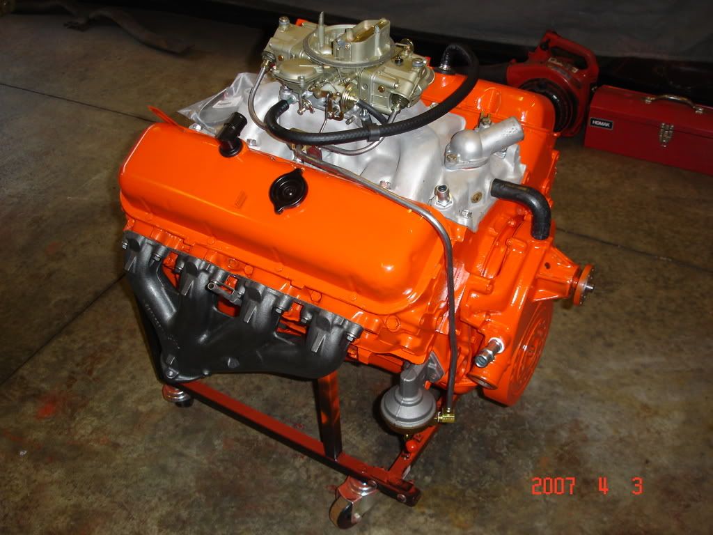

The Car should be painted today and I should have it home in a few days.......Been a long 3 weeks in the Body shop.......LOL......Here are some more engine pic's......put a dent in one of the valve covers moving it around...Darn.......
Nice Job on the Carb Eric
Ken

GORGEOUS!!!!!!!!!
What did you do to the exhaust manifolds? Did you coat them with something??

Ken's engine are ALWAYS super detailed.
I believe that he *may* have used Calyx...
http://www.calyxmanifold.com/

My pleasure Ken.
The engine looks fantastic.
Eric

I won't even tell you what those pics do to me!!! Those are SO nice. It really gives me something to aspire too...
Thanks for the info. I have some correct, date coded manifolds that I want to 'fix' up and install.

Bruce is correct..............Calyx........Glass Bead the manifolds then rub on the Calyx Paste(It's like a Graphite and wax mix)......after they are coated you just take a rag and wipe the manifolds to even out the coating.......If they ever start to look bad you just smear some more on and they look new again......
