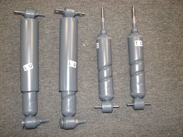

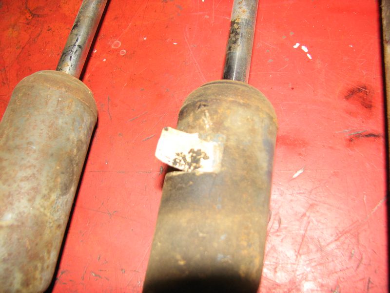

Not much to report this week as we have about as much done as we can get done until the rolling body comes back to the shop then its late nights and weekends again.

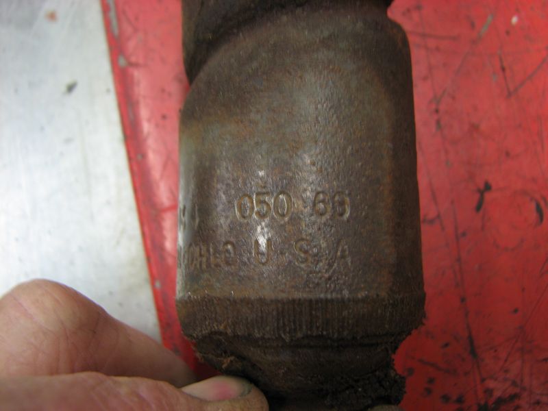

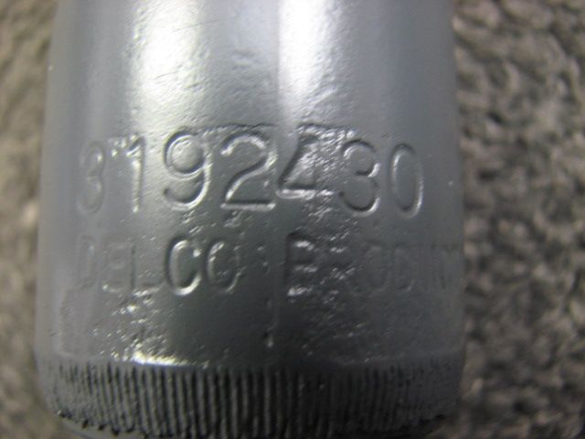

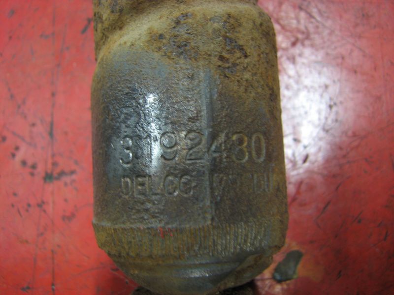

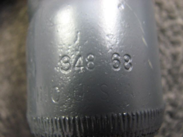

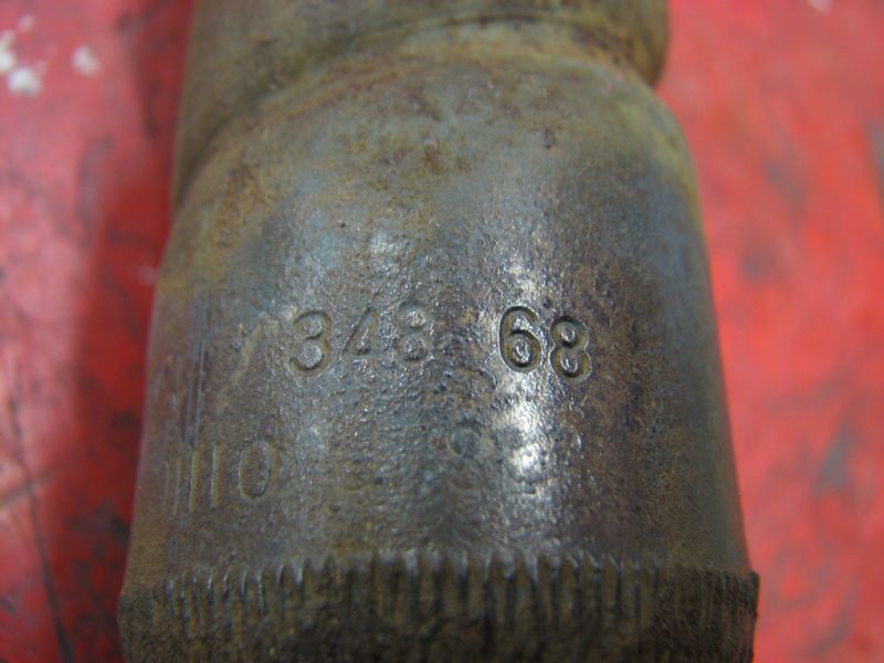

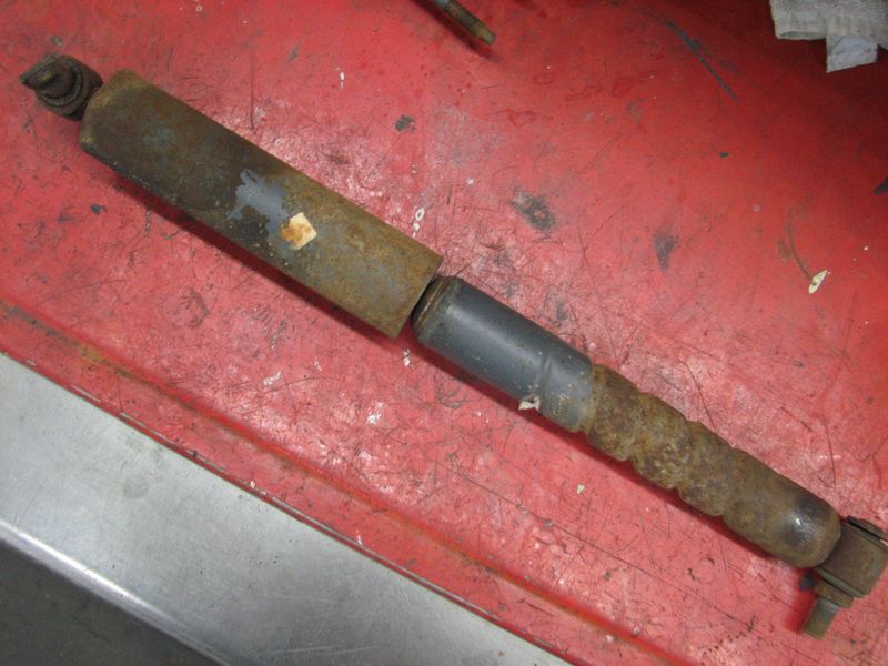

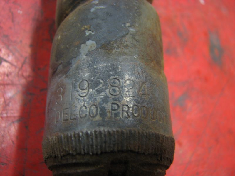

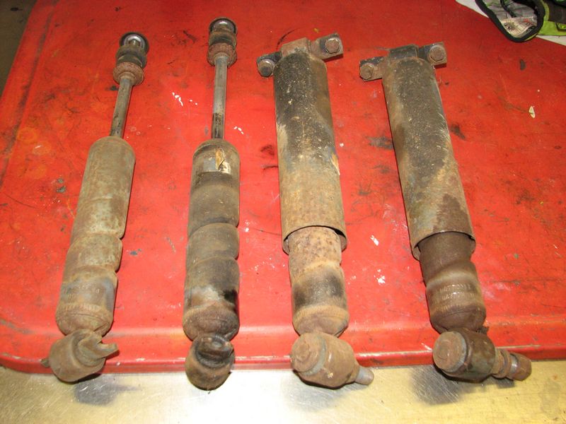

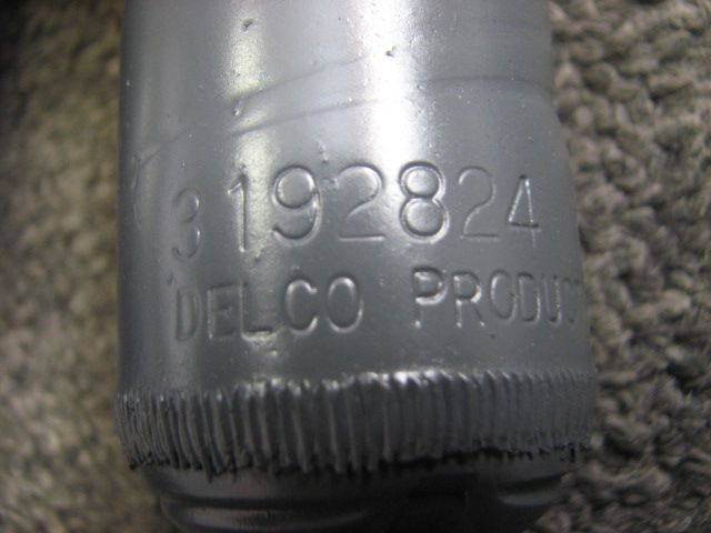

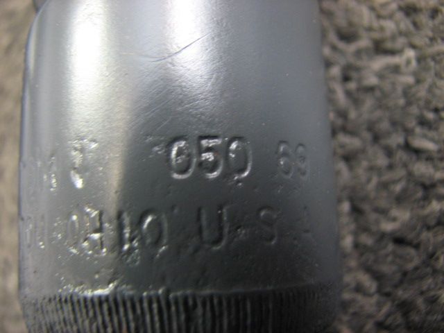

As you may recall, we found all 4 original and dated shocks still on the chassis when we tore it down. I finally got these restored with all new bushings and newly made decals. Wish I had gotten them in time to put on the chassis for World of Wheels.

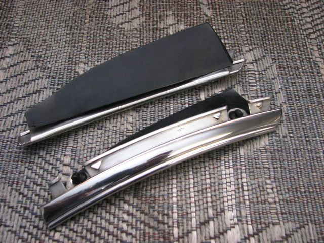

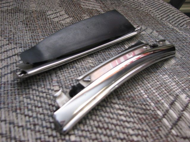

Also cleaned up the original top fender trim pieces and rubbers that were in excellent condition needing only a cleaning and stainless polishing.

How can you restore the function of the shocks? Or are they still functional?

The tops were cut off and NOS guts put in their place. Then rewelded and re-knurled. Very expensive but well worth it on original shocks.

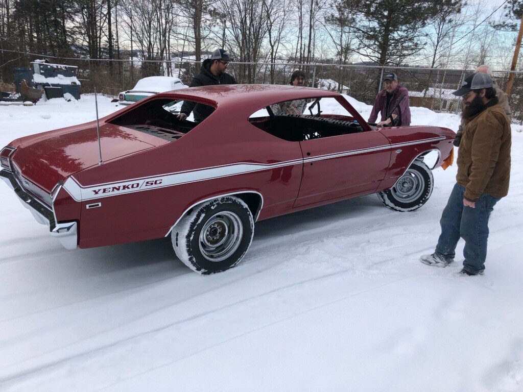

Out for a nice winter cruise...…..

I guess you can’t say “never driven in the winter” lol!
Beautiful color

It wasn't driven, it was pulled.
