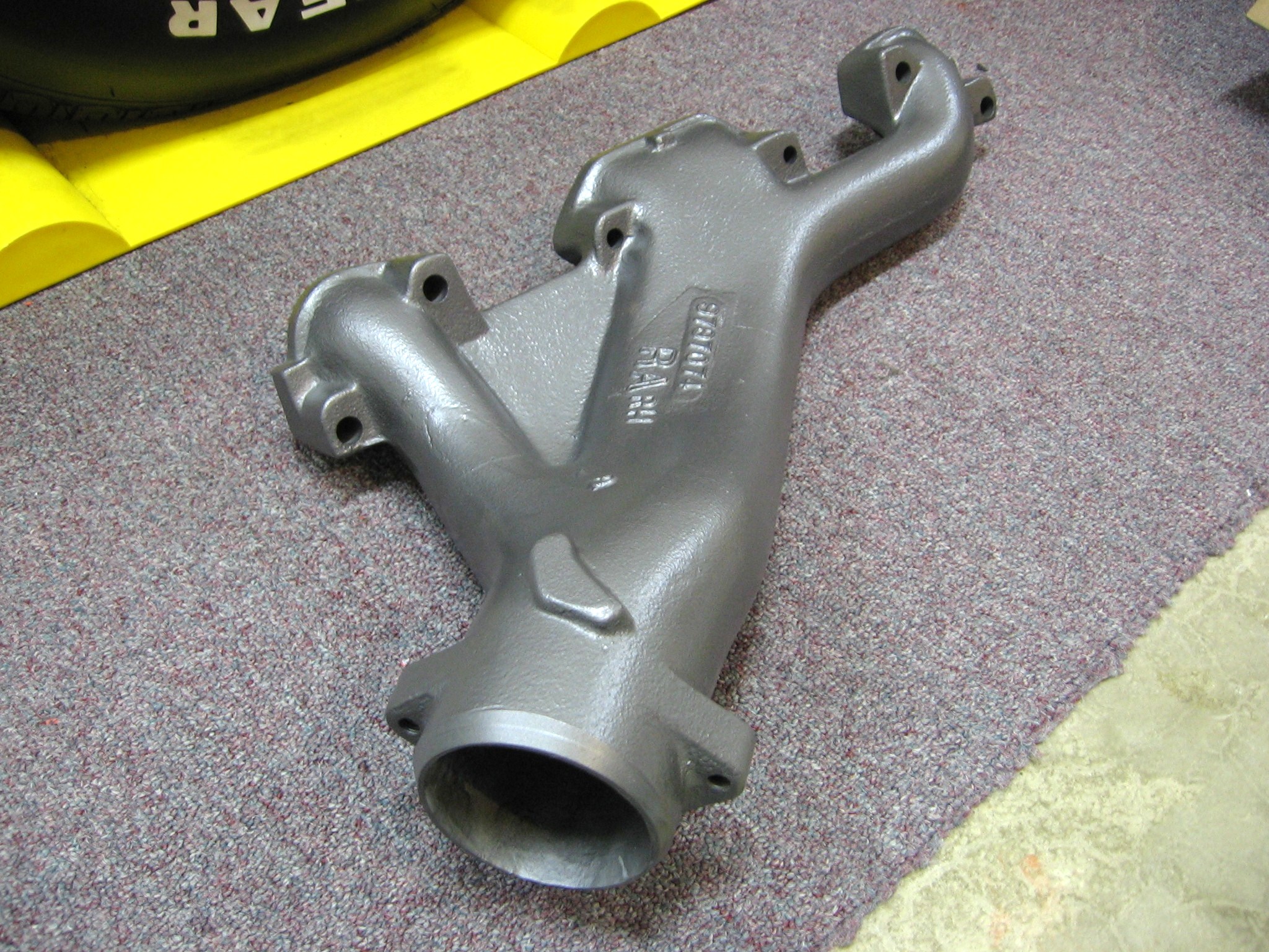

Here's the new manifolds just after the box was opened. Just in time for an early X-mas gift!
They come with a heat-coated finish already so you don't have to send them out get Jet-Hot coated and wait for the return trip.

----I take it you like these ram-air manifolds as much as I do. When restoring my 69 GP/SJ 428/370 I couldn't bring myself to schlep the log manifolds back on the car. Those have to be the most restrictive exhaust manifolds known to man!!! Along with some other judicious modifications that no one will ever see, I thing I am well beyond the 390 rated 428/HO Grand Prix top engine option......Bill S

I went the ramair manifold route because no tubular steel headers ever seal properly on a Pontiac...and they fry starters...and boil the oil filters...and drag on the ground...and are impossible to install, etc,.
These manifolds flow nearly as well as a good set of tube headers but do it very quietly with no ground clearance issues.
