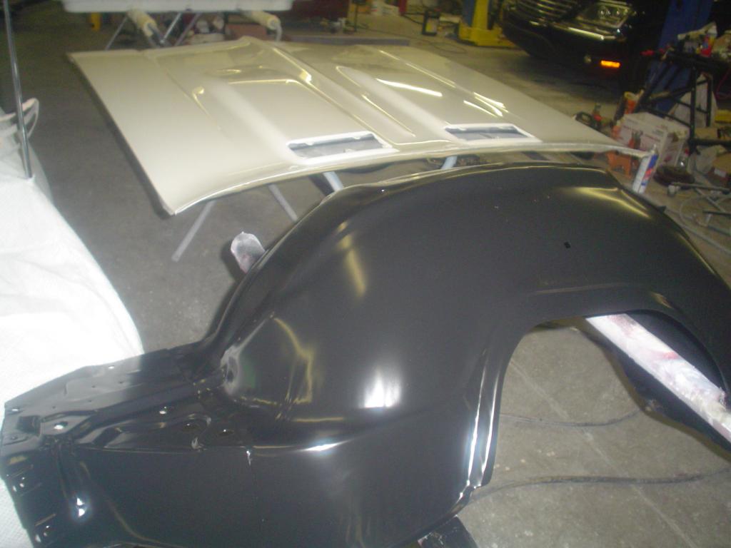

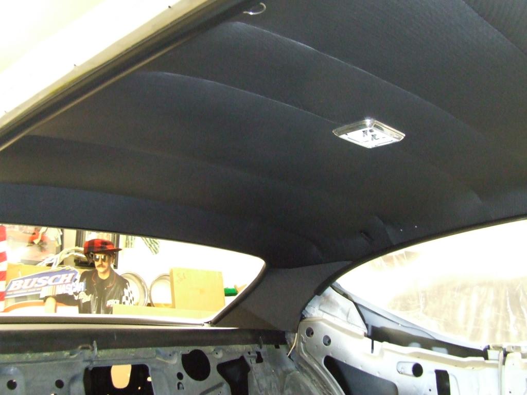

here you go Ryan, headliner pics and valve cover decal that was wrong is now fixed!

The headliner is stunning. [img]<<GRAEMLIN_URL>>/biggthumpup.gif[/img]
The valve cover sticker had me laying awake at night. [img]<<GRAEMLIN_URL>>/haha.gif[/img]

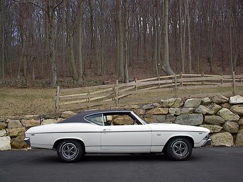

You have the picture posting down pat now, took me a while too. (I added a few white 69's for your viewing pleasure)

Donnie,
A little word of caution on the dome light... Make sure there is no chrome plating on the base where the screws come in contact with the roof brace. It will short out and continue to blow the fuse or arc which you don't want to happen. I had to sand it off to prevent it from arcing.

<div class="ubbcode-block"><div class="ubbcode-header">Originally Posted By: BlueSS454</div><div class="ubbcode-body">Donnie,
A little word of caution on the dome light... Make sure there is no chrome plating on the base where the screws come in contact with the roof brace. It will short out and continue to blow the fuse or arc which you don't want to happen. I had to sand it off to prevent it from arcing. </div></div>
X2
