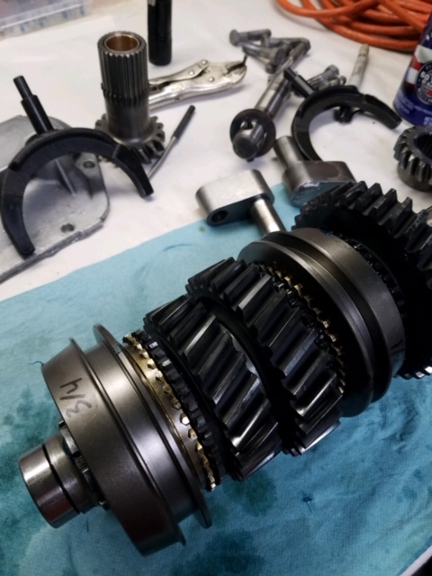

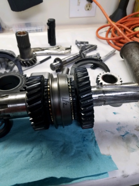

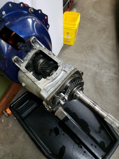

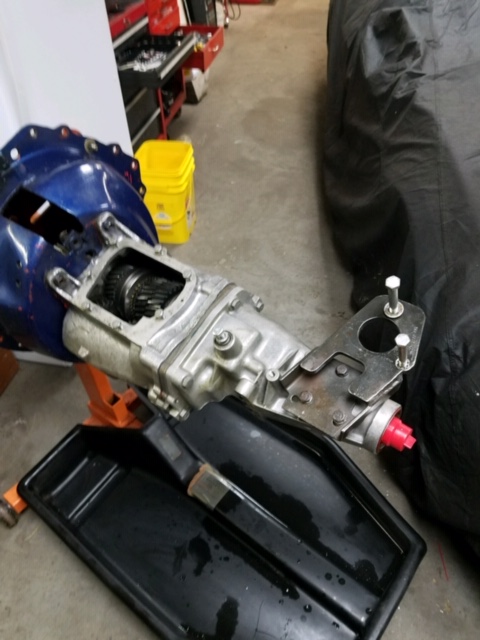

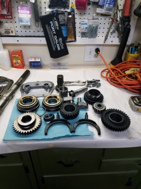

Status... temporarily grounded.
I pulled the trans, and met Nick in North East PA to hand off. He has disassembled, analyzed and sent all the “shifty bits” to Craig Wright in AZ. Craig quickly diagnosed the torque lock sliders as “NG” and the 1-2 was too tight. Nick used the items supplied as a kit but the kit didn’t work as planned. The trans is going back together currently.
I have to have the car running soon as next Friday Weaver4, the Stagers, and Kenny Kroeker (a local photographer working for Bone Stock) will have a photo shoot here in town to make an article for an upcoming Bone Stock and Modified Muscle Car Magazine!!!
Weather is turning so I am not sure I will get another drag strip event this season but will be ready!!!!
Ryan W31

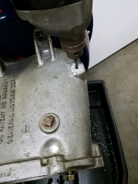

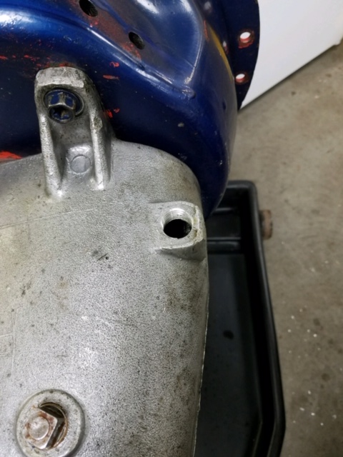

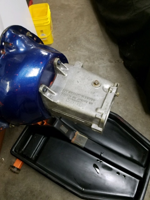

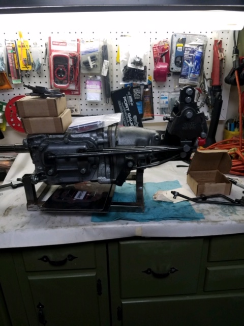

M22Z (3) version 2.0
Nick Morocco has my M22Z (3) rescue completed. New sliders, new shift forks, shift shaft welded, heavy spring for combs, it should be happy now!!! He even added a drain plug (magnetic)
