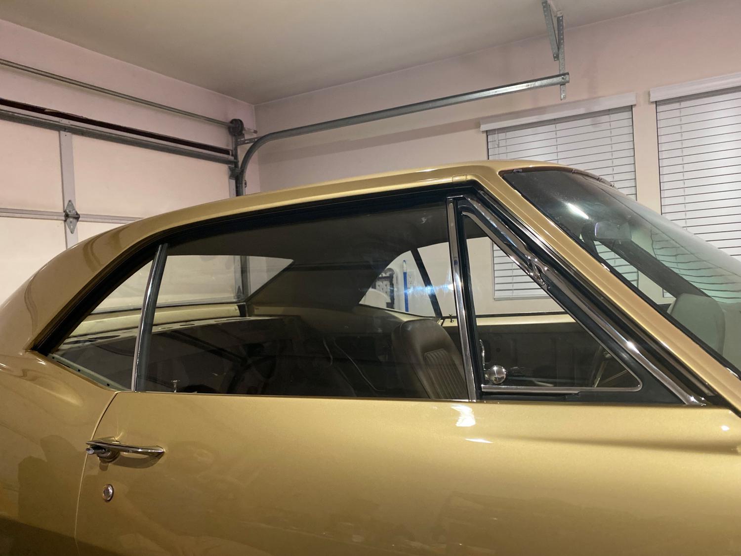

Here is the passenger side glass...

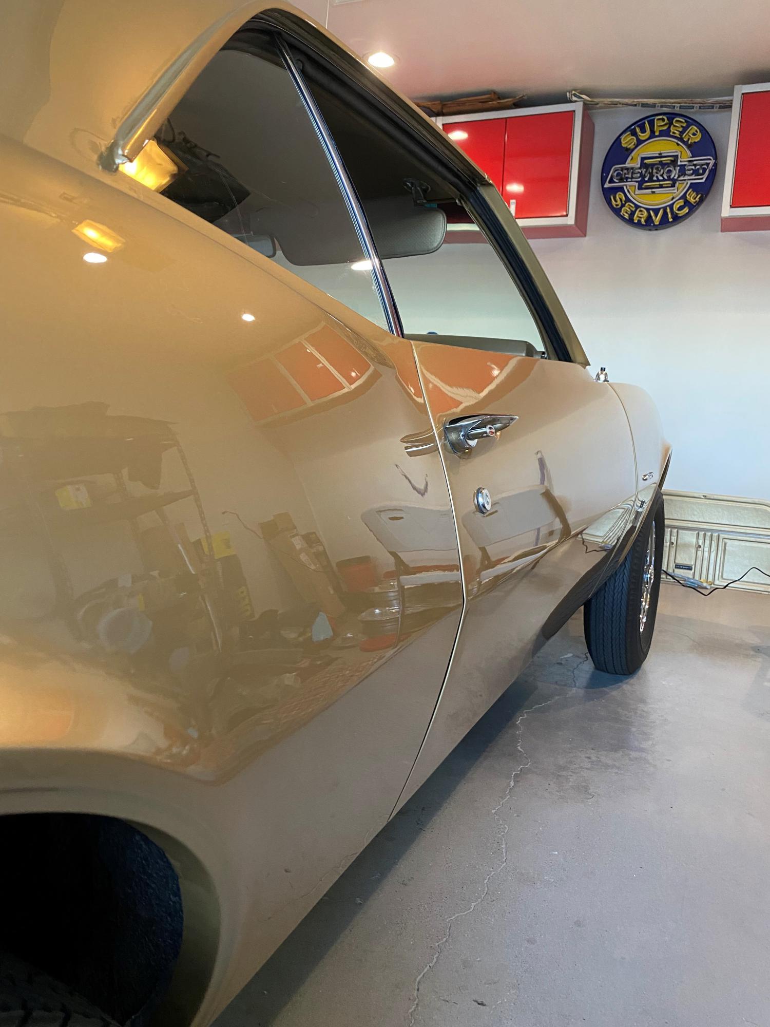

Passenger side before the door glass and vent window. Original door handles I had replated by Meclec plating in Fresno, CA.

Looks like you did an excellent job fitting all those together. Good to know about the Steele vent seals being better and the OER latex roof rail and door seals. I'll be needing those too and should probably order them now.
