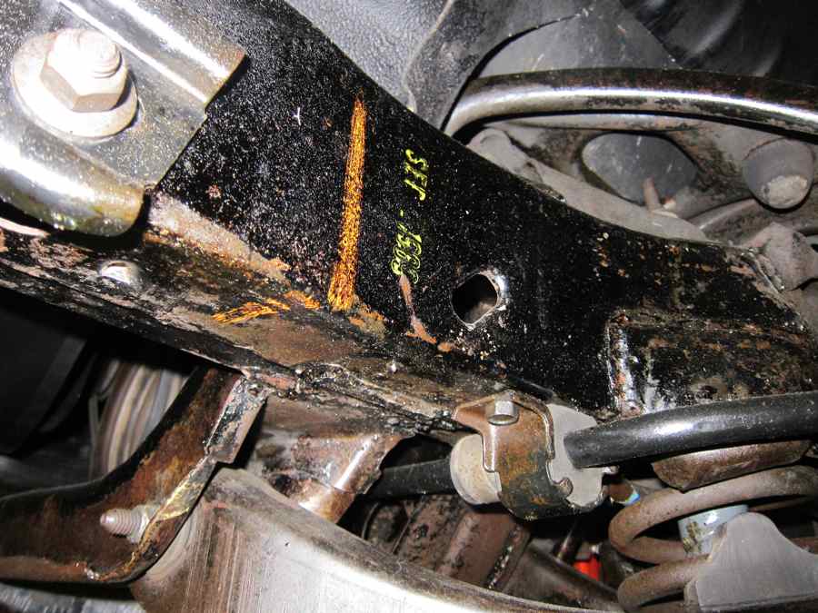

In that area between that orange line & the tie down slot is where the yellow date might be....Joe

In case it helps, just found some more images of driver side frame markings in this CRG thread:
http://www.camaros.org/forum/index.php?topic=11678

Here's a picture of the frame rail on Skip's late 69...Joe

Here it is on the 68 Harry Mann car I had...............

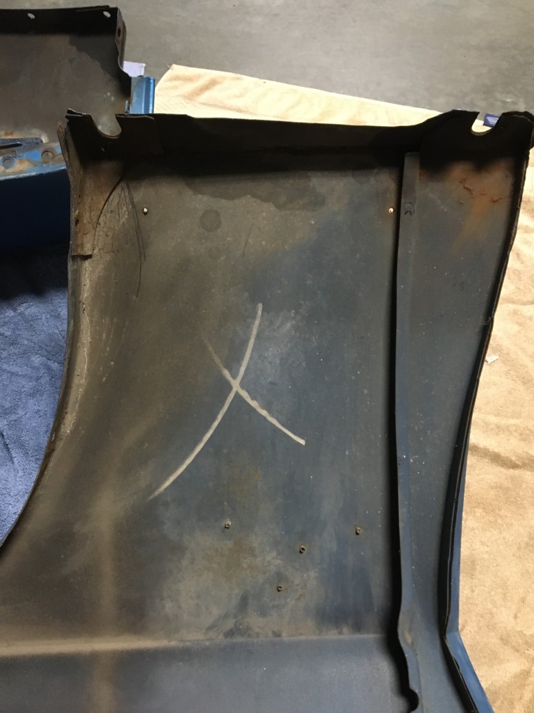

Hey Graham, looks like your having fun. Mine is almost ready for the paint shop. Thought you might like these 'X" markings I found inside both fenders and also the lower valance. I need to go look at the frame again for the others.
