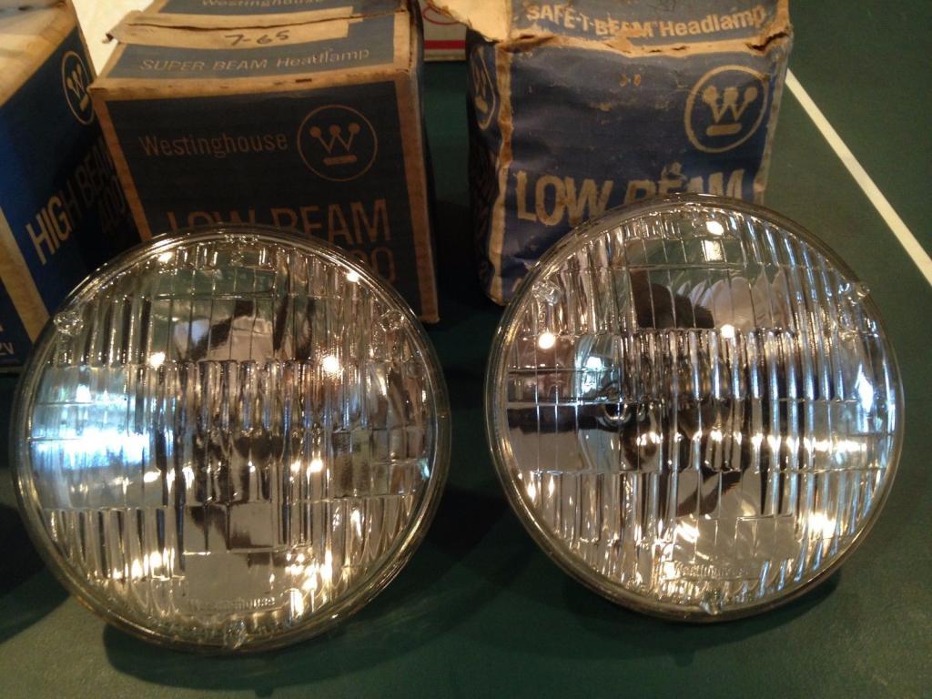

I was able to snatch up an NOS set of Westinghouse high and low beams for the Bee! The driver's side were replacement later style Halogen. And while probably brighter, they don't look right with those narrow fluting. So I snatched these up for, umm.....let's say, retirement is now postponed. Yep...things were going real well in the Molnar Hacienda. Then I went ahead and bought these light bulbs [img]<<GRAEMLIN_URL>>/thumbsdown.gif[/img]
But you can see that these wide fluted jobbies will just look so right up front. Shine on Me has the bezels and grille and they should be done in about another month. Can't wait to get them back!!!

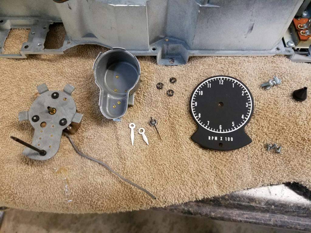

Clock rebuild time! I'm replacing the movement with a quartz conversion. I think this may be my first classic car EVER that the clock will work! I'm going to run a lead over to Grady's car this year and tap off of his battery just so everyone can see a clock work in classic car. [img]<<GRAEMLIN_URL>>/biggthumpup.gif[/img] [img]<<GRAEMLIN_URL>>/hmmm.gif[/img] I know the movement won't be the same. It'll be more of a sweep than than the &quot;tic&quot; that was original.

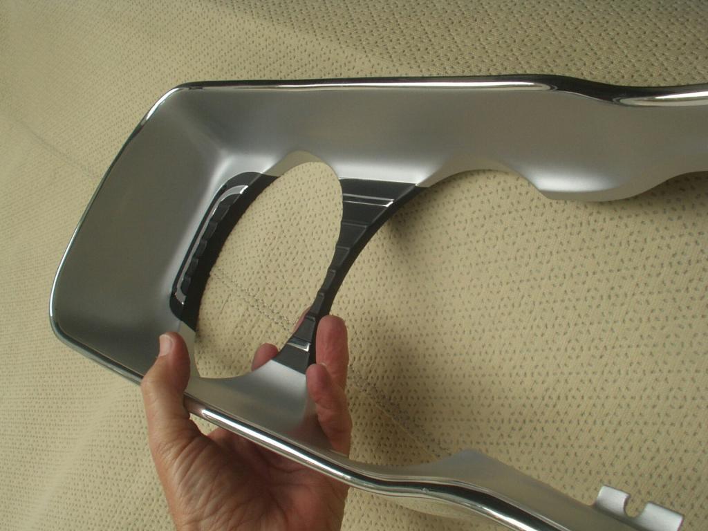

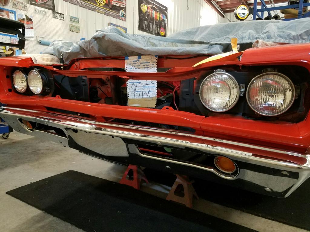

Lost of smaller things done, but I don't want to bore everyone with pictures of trivial stuff. Been slowly wrapping things up. Headlights installed, and just as I got that done Norm at Shine on Me called and said my headlight bezels, grille, and tail panel are DONE!!!!! WOOHOO!!!!!

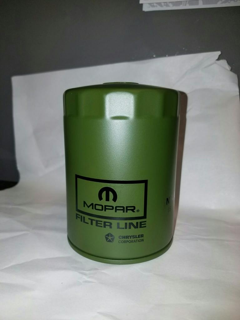

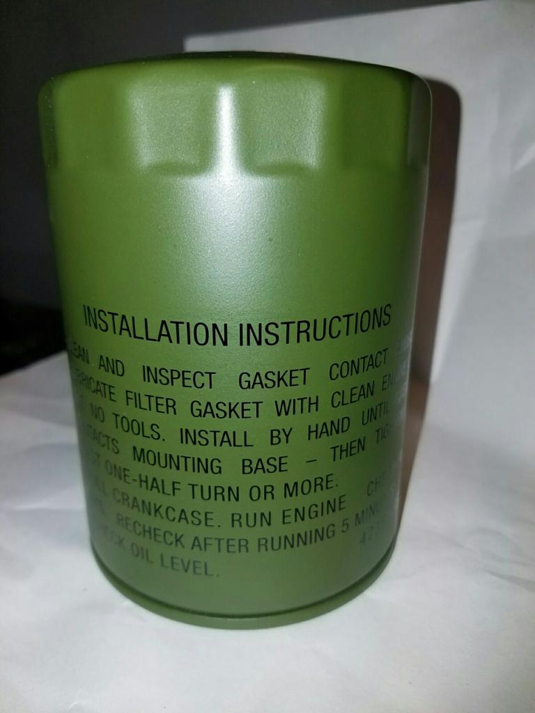

Mopars on the assembly line got an oil filter that was a different color than the ones sold over the counter. They also had a sandy-textured coating, a non-slip coating like thing, as well as some specific stenciling on it. Since I'm detailing my Bee up to look like it just rolled off the assembly line, I need one of these filters to match the look. Well, an NOS one is about a grand, maybe more, should you find one. Add to that, I don't want to actually use an oil filter from 1969 for fear of internal disintegration! Something that happens to me everytime Kelly tells me no! [img]<<GRAEMLIN_URL>>/biggthumpup.gif[/img] [img]<<GRAEMLIN_URL>>/hmmm.gif[/img] [img]<<GRAEMLIN_URL>>/whistle.gif[/img]
So, enter my artistic background, creativeness, and general lack of being able to sit still. I came up with a prototype of the factory filter. This is the first go at it. A practice run with a few more to follow to get it right. The color is not correct, no textured coating, and the raised M on the top needs to be adjusted. But this one was to mainly try out the dry transfer I had made for the filter with the logos. Now that I've done it once I now what I need to do to make it better.
I'm going to have my paint shop mix up some color to match the factory filter better, and I'll add some glass bead to give it the media texture it needs. That thicker single stage will fill in the voids on the raised M on top to make it appear more stamped. The one part number has an additional number in it that is not required, and I want the instructions to take up a smaller area, so the next round of transfers will correct this.
