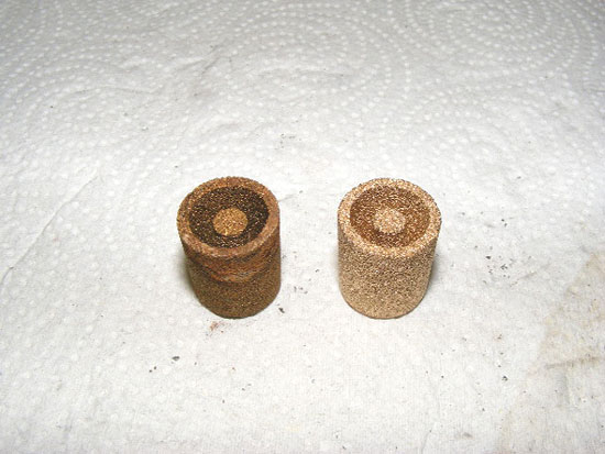

OK; the carb is wrapped up and will be on its back to Mr. Williams tomorrow.
To highlight a few things during the rebuild process;
First and foremost, the carb was suffering from a pretty bad case of fuel contamination. The filter on the left is the one out of the rear bowl on Toms carb, the one on the right is a new unit for comparisons sake.
Yes, it is essentially plugged solid. The insides of the float bowl looked even worse.

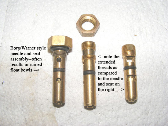

Next issue was the Borg/Warner needle & seats that had been previously installed. These units are responsible for more junked float bowls than I can count.
The problem lies with the extra threads below the groove for the O-ring--if this type of needle & seat is threaded too deeply into the float bowl, it will cut threads into the boss where a normal Holley needle & seat seals with its O-ring, thereby ruining the bowl.

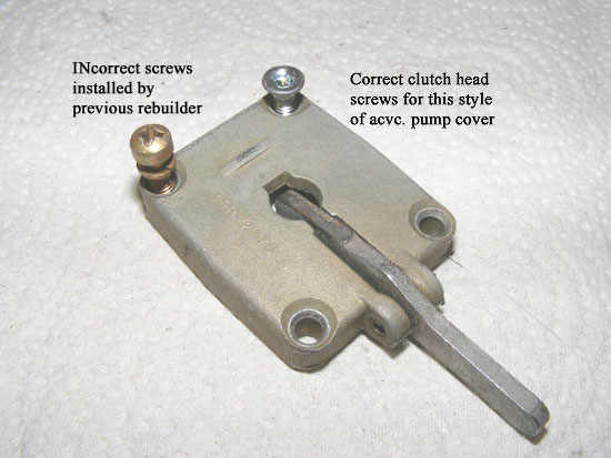

Next up was the accellerator pump cover. Whoever rebuilt the carb previously must've lost the correct clutch-head screws that secure this particular style of cover, and they replaced them with conventional Fillister head screws.
Tom reported that the pump cover had been leaking...I wonder why?

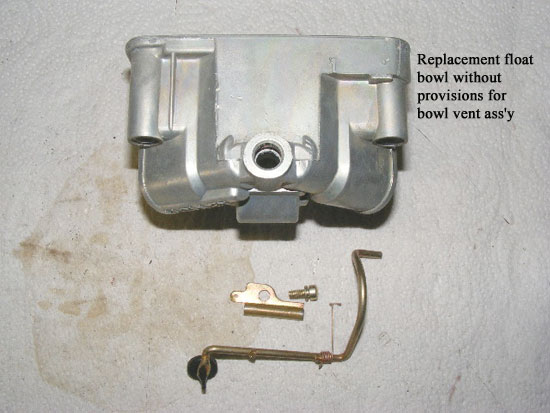

Toms carb was also equipped with an incorrect later-style primary float bowl, which also lacked the correct float bowl vent assembly this particular carb requires. To note; the later style bowls can not be converted to use a bowl vent lever as they lack the cast-in boss for the lever retainer.
Tom provided a correct early style primary bowl, but it wasn't set up for the bowl vent lever either.
